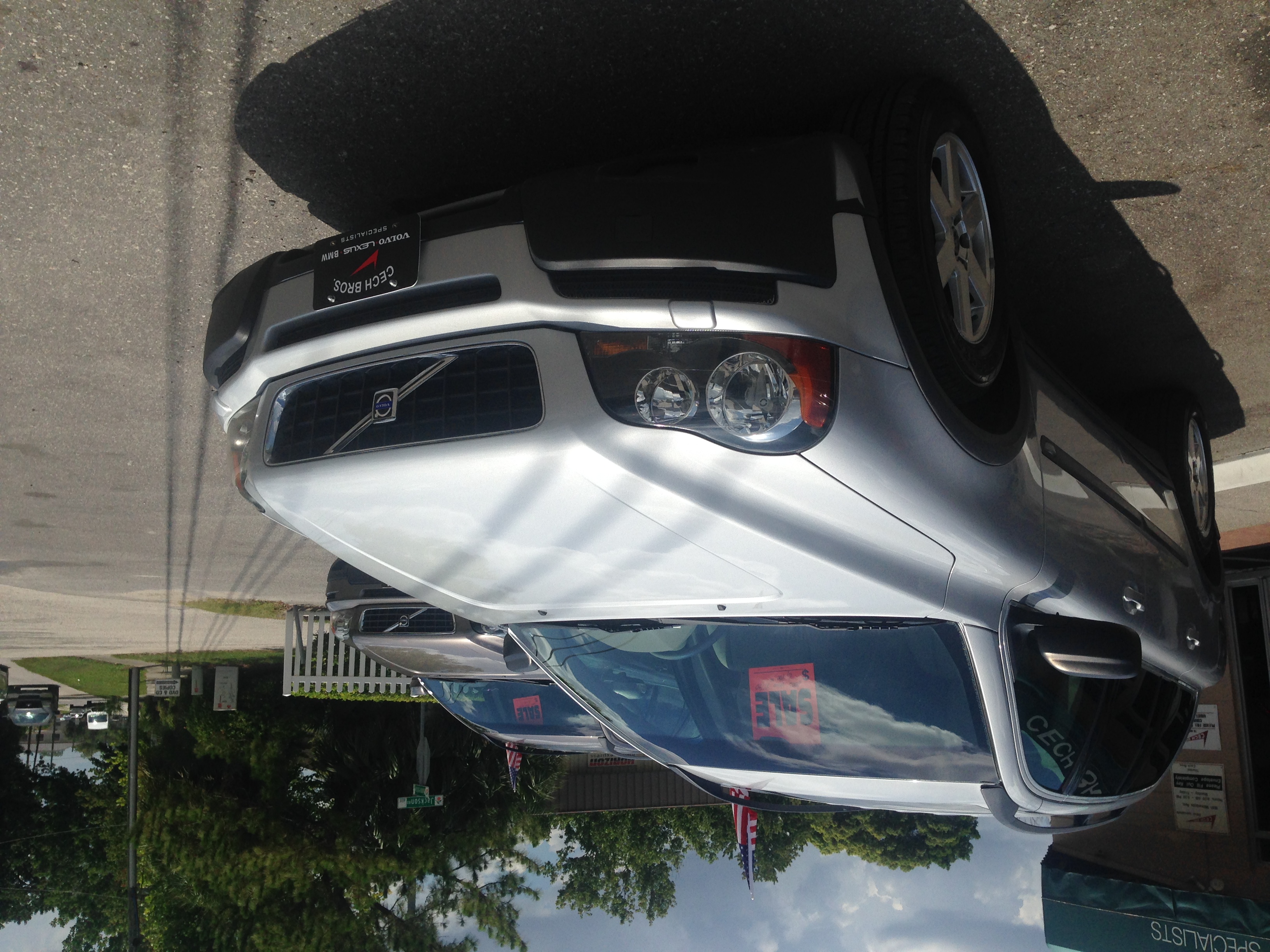

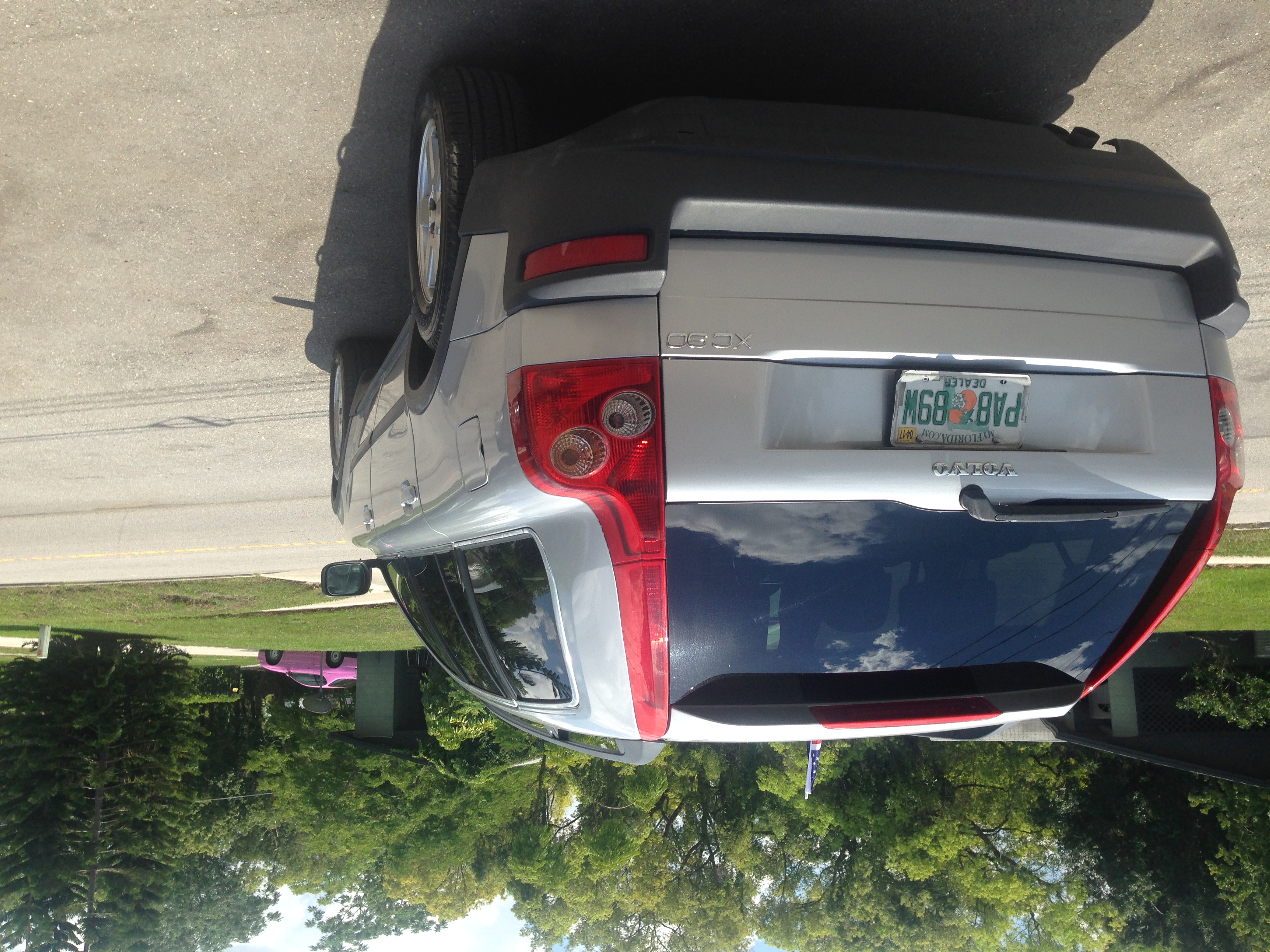

So, we drove the XC90 today and it went well. Everything worked well, acceleration was good, brakes good, no drifting or swerving on braking. No clunks or rattles, solid. Appearance was good, recent repaint, which made me a bit suspicious, but we know the sellers. New tires, recent brakes, axles up front, 40K on the timing belt. 95K on the clock, $6K asking price, have till Monday to decide. Seems ok and would meet our needs well enough. Mileage seems good for it's age. Advice?

To be honest, it seems like a good deal, perhaps a too good deal? Being repainted is suspect to say at least. These are the best cars in industry when it comes to body rust. Most 2003 models look like new today without a trace of rust on the body.
Then, there is the timing belt thing. It's been done at 60K miles and perhaps 4-5 years ago. What for? Why did they do it that early, way before the scheduled interval? Might sound like someone who is overly cautious, or maybe the odometer has been rolled back, which definitely takes less than 5 minutes on these vehicles. Have the maintenance work checked with the corresponding miles, even better have the main Dealer retrieve the mileage stored in the main computer.
Give it a good drive, for at least 20 minutes, and pay attention how the transmission is shifting. The key with these cars is to check forums for solutions and to repair them DIY or by honest local guy with quality OEM used parts - tons off Ebay at low costs. NO walking to the main dealer for repairs, it's forbidden by law (you get the idea)
