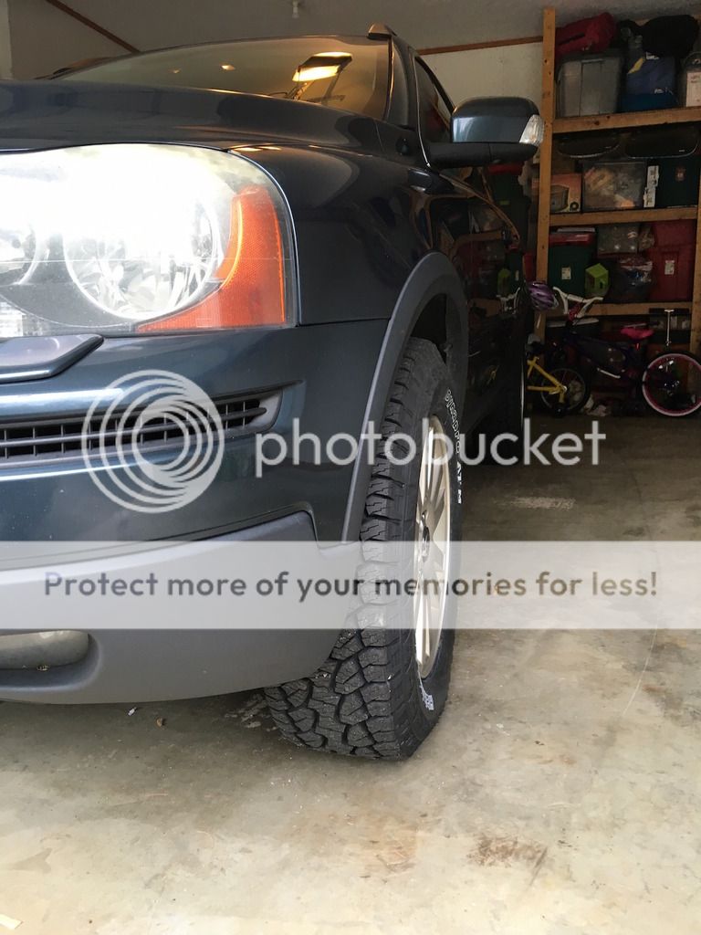

i just ordered a set of the ATMs in 245/65/17. When I get them mounted, I will post back. I had them on my Xterra (close to same weight) and they were fine. How often are you going to go past 120mph in the XC90?

As promised. Got them mounted today. I have put 120 miles on them and very impressed. I was not sure what to expect going from V rated street to T rated A/T tires but these are great. They are soft over the bumps and there is very little difference in handling. They are slightly noisier than my Toyo CUVs and I fully expect that noise to grow over time, but they are an A/T tire so it's expected. These are 245/65r17 Hankooks.

Post by songzunhuang »
Those are some beefy looking tires. I actually run Firestone destinations on my XC90 and they are great on the street. I've never really stressed them offroad so I can't vouch for them in that situation.

Post by marmotteNZ »
Thnaks for the post!
They look great indeed.
245 was your normal width or did you fit larger than specified?
I have destination LE now. They have been OK while I was doing very little gravel but the two mounths I have beem living in my new place with a gravel road I have ruined them. (Riding maybe 20 to 40 miles of gravel / week)

Post by Masscomguru »
Factory size is 235/65/17. I opted for the 245's because they have a much higher load rating than the 235's.
I have put 3500 miles on them this month and they are doing really well. No issues with handling. I have noticed that gas mileage is down slightly and my speedo is off by 2 miles at 65mph.
