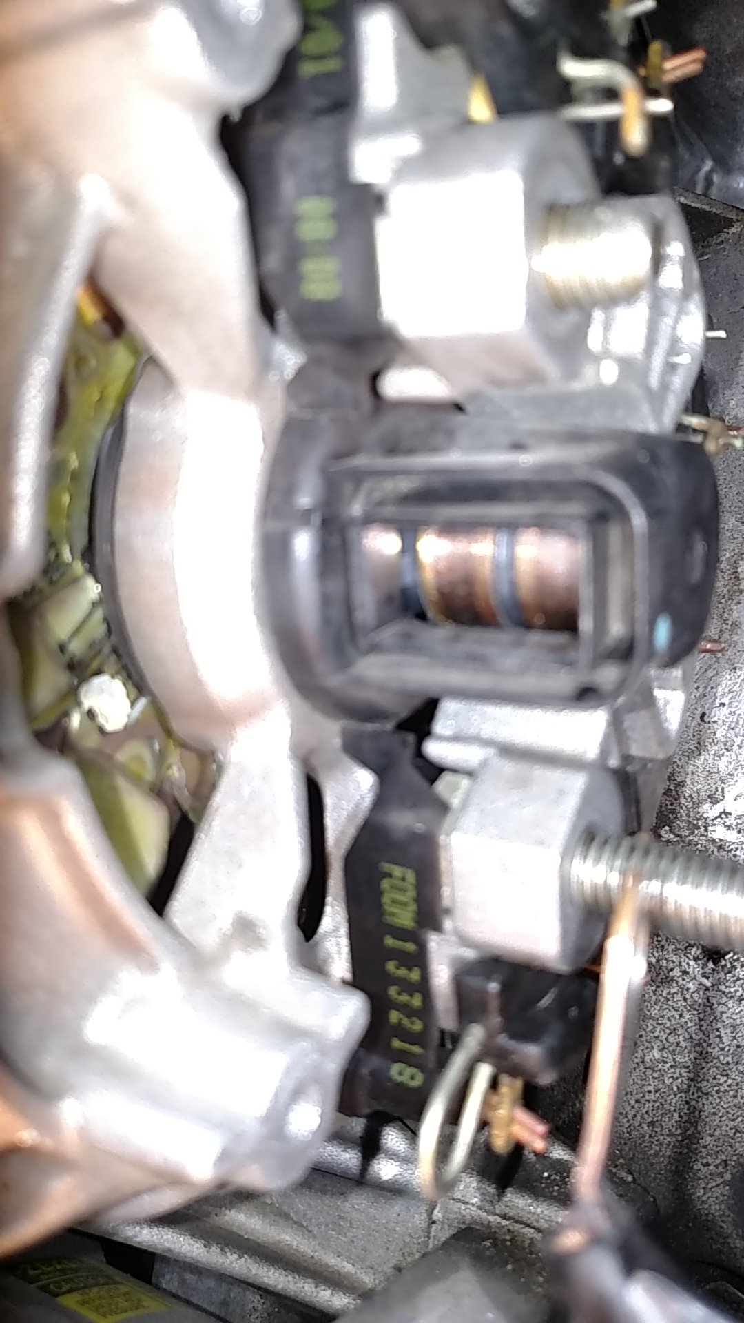

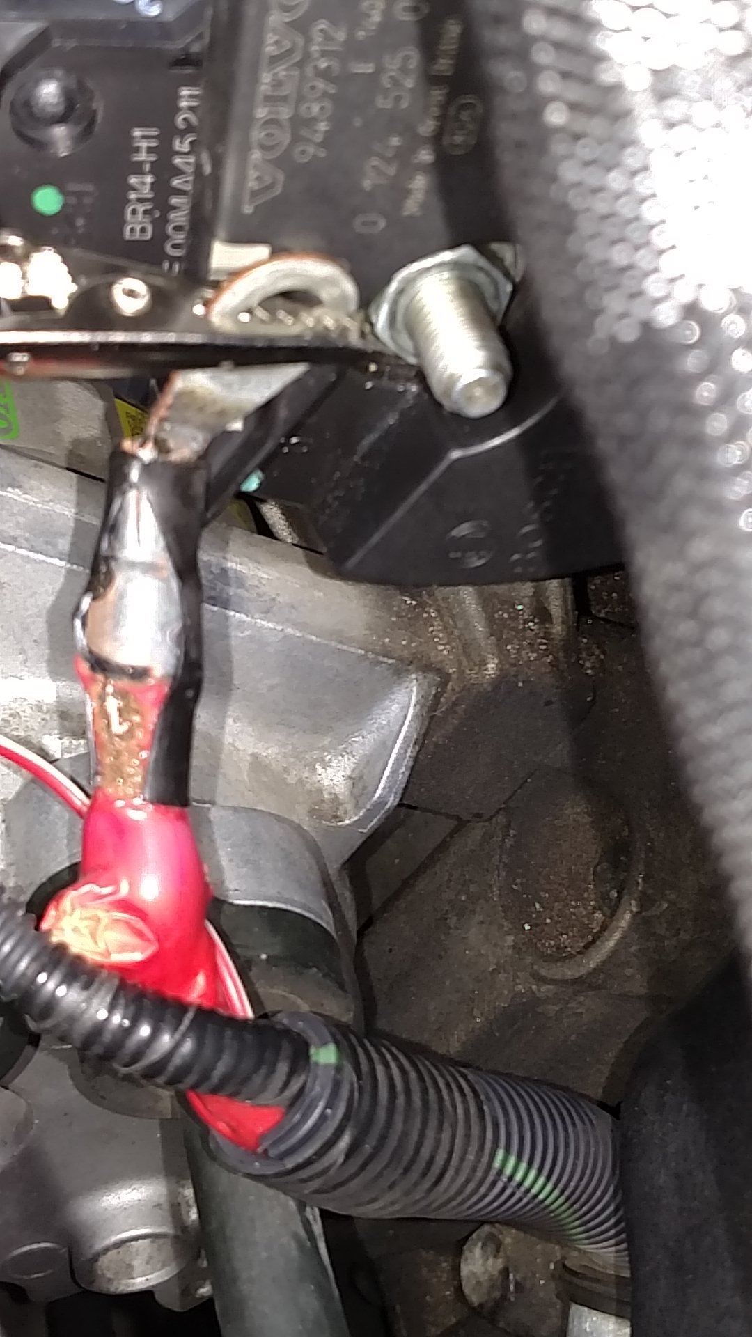

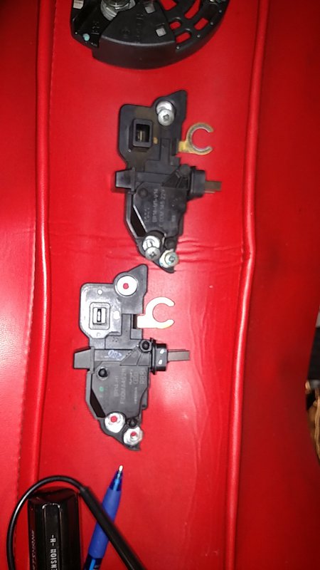

My problem was low charging after about 5 minutes of running, 02 S80 T6 60,000 miles. Chose a new voltage regulator from IPD. Replaced the VR. Reconnected battery, got half a crank, then smoke rolling off the thick red wire at alternator! Pulled battery ground wire... Later I tried inspecting and testing with multimeter. Appeared to be direct short from B+/red cable connection and case on alternator. Low to zero resistance from B+ stud and casing were the same when I dismantled and reassembled the Regulator. Oh well, maybe strange but okay "short" was normal ... Nope! Half a crank (after systems charged and settled down) and smoke with glowing of the wires in my alternator! 2 burn attempts 1st cooked red wire at insulation by alternator. Second cooked alternator on the copper wiring inside!
Trying to find out why or how the alternator became shorted when regulator was replaced?
Is there likely massive damage in the alternator and should I worry about other systems?
Where can I get my alternator rebuilt, or is an OE replacement better?
Such a long ordeal and any help is greatly appreciated!

At risk of seeming stupid, could the insulation around the red wire o-terminal have been damaged when you bolted it back on?
I ask because it looks like a clean slice on the black insulation in the photo, and I would not expect "melting" from heat of a dead short to make such a clean "cut".
