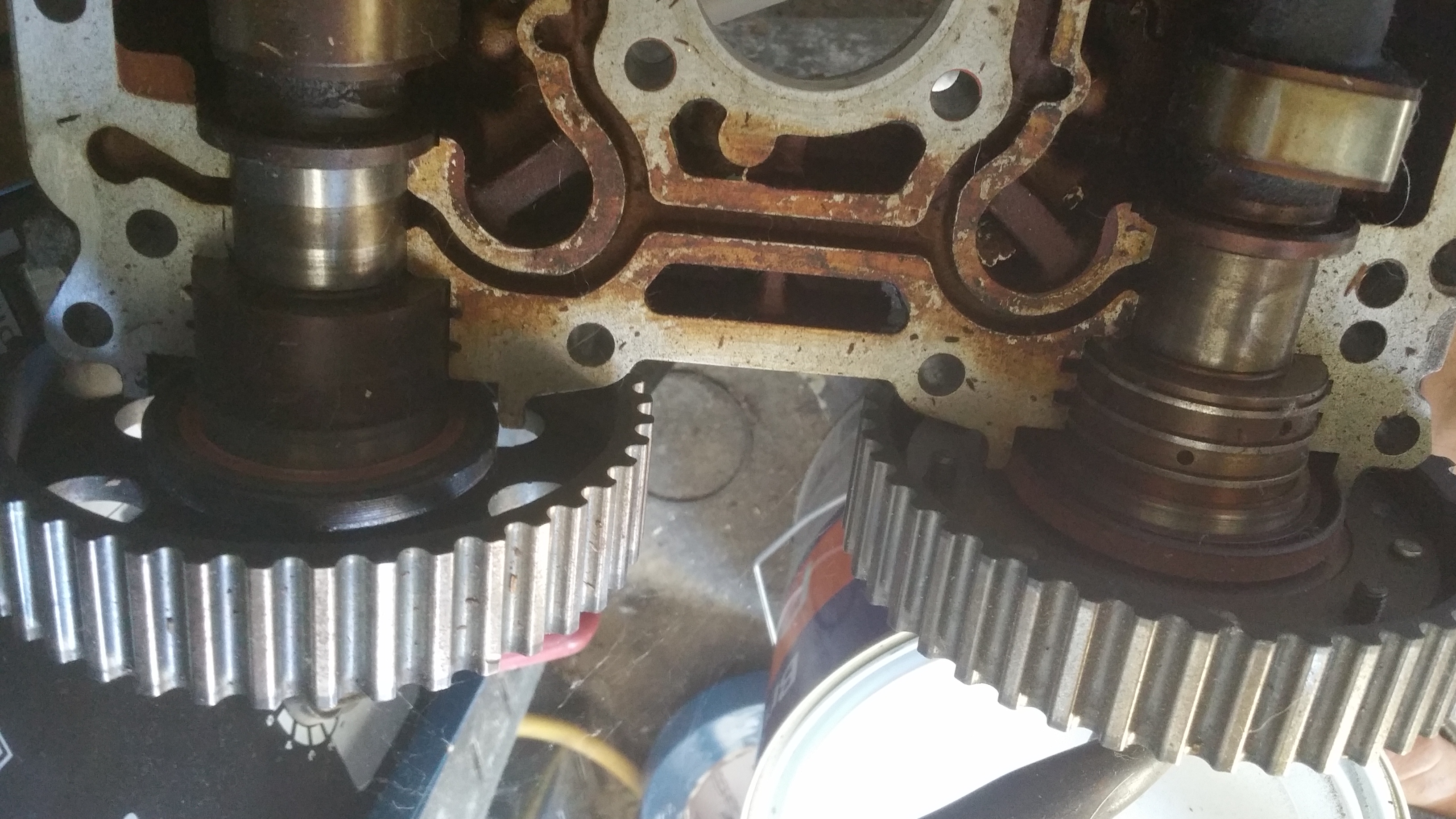

The intake cam is a different design on a 2005 (part number 8670354) and 2002 B5244T3 is part number 9497823 so no interchangeability with front sprocket unless you swap out the cam together with the sprocket.
Photo here shows a B5244T3 cam cover with intake non CVVT and exhaust CVVT cams. You have wider oil journals feeding the CVVT cam which would be fine using a non CVVT cam which would effectively recirculate the oil going to the cam if you screw taps into the 2 CVVT oil ports from above where the solenoid bolts on.
The cam seal has the same OD on CVVT and non CVVT so you're OK there.
You would really need to do your homework on this one.

precopster wrote:The intake cam is a different design on a 2005 (part number 8670354) and 2002 B5244T3 is part number 9497823 so no interchangeability with front sprocket unless you swap out the cam together with the sprocket.
