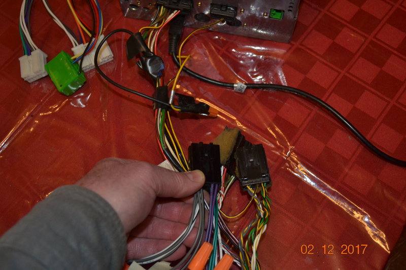

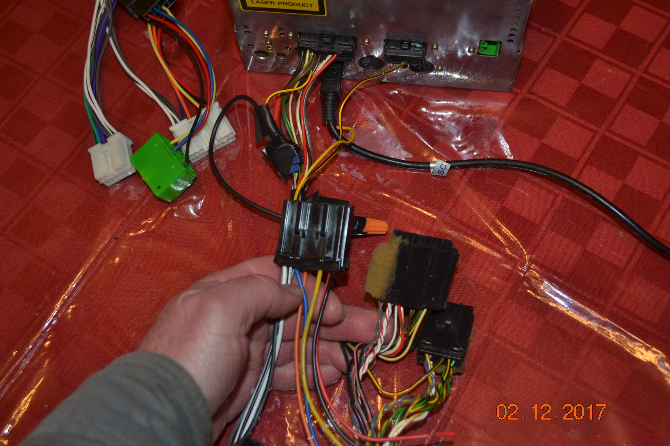

I just installed a SC-901 with Dolby and center speaker in my 98 V70. I used a PA-200 200 watt amp from under the seat of an S80. I used the following to build my own wiring harness:
1) PA-200 wiring harness
2) Metra radio harness (70-9220)
3) I used the two black connectors from a scrap yard C70 that plug into the SC-901. I clipped them from the wiring harness. You can alternately use the standard issue V70 connectors and just cut off the wires not needed. They are a superset of the wires on the C70 connectors.

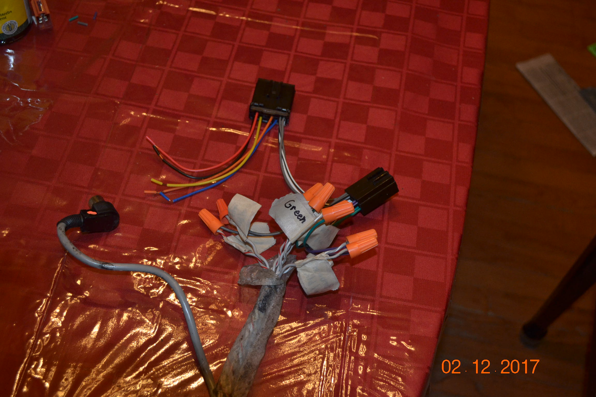

I can save you a trip to the scrap yard. I have those two connectors with long wire leads here in front of me . Taken from a V70. I won't be needing them. PM me if interested.

Update: I actually only needed the 14 pin connector to finish the harness. The 400 watt amp works great under the passenger seat! Next step is to start installing my set of Dynaudio speakers in the S70. Going to junk yard today to pick some speakers. Will take them out of the mounting brackets like Ozark Lee's article explains. Hopefully will make them plug & play!
