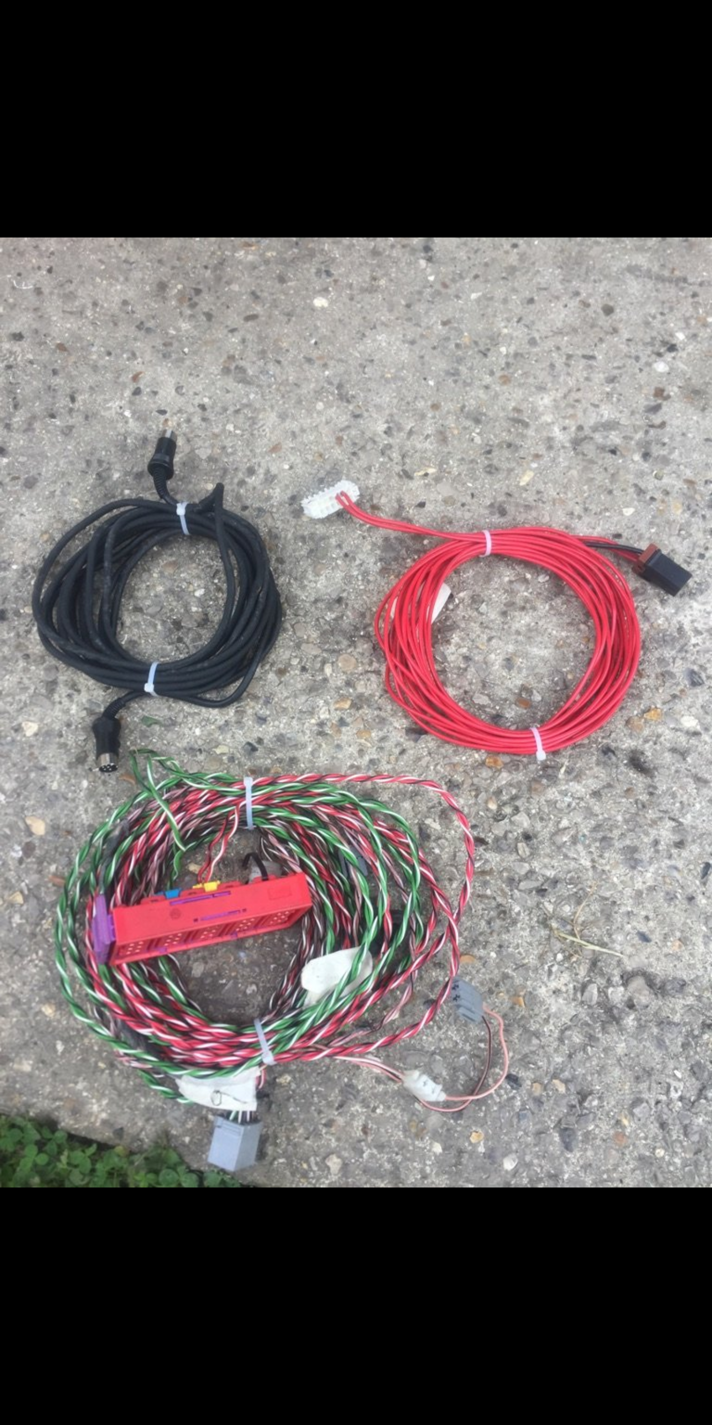

So first of all you need to get an amp from a C70 with the complete wiring harness.
Like this:
The 2 red wires + 1 black are for the power supply and ground.
The others are the ones you have to wire to your speakers.
And there's the DIN cable to plug the amp into the headunit.

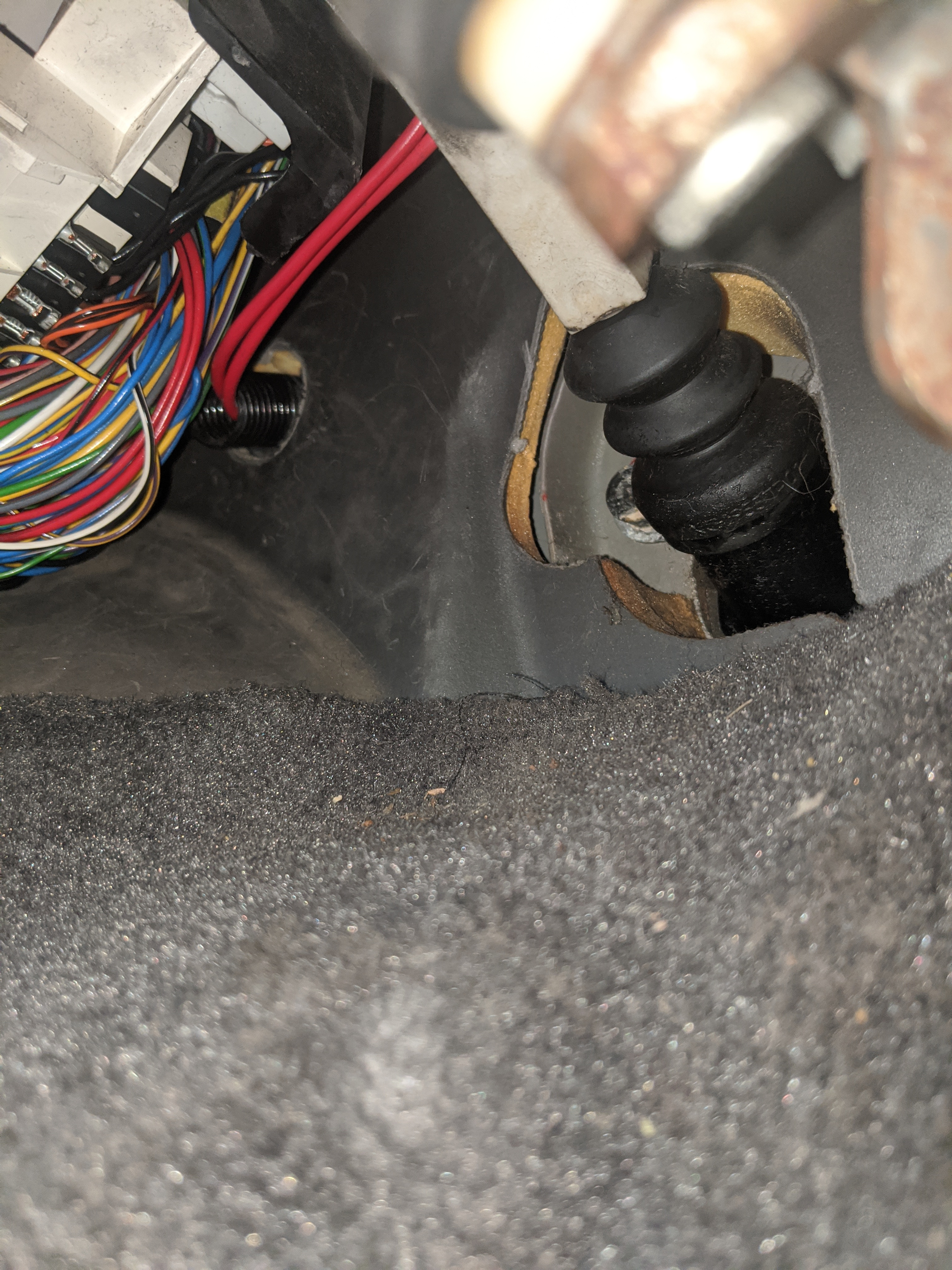

Finally you need to wire the two power cables to the battery's positive terminal.
You'll need to remove the trim under the steering wheel and find the passthrough to the engine bay.
It is located over the clutch pedal, to the left.
Remove the rubber gromet and shove both wires in.
Next you have to remove the main fuse box and remove the rubber gromet on the other end of the passthrough.
Push the wires all the way in and then pull them from the engine bay.
You can try to sneak them to the right of the airbox and make them follow the thing around the cables going to the + terminal.
Then simply connect them to the positive terminal!
