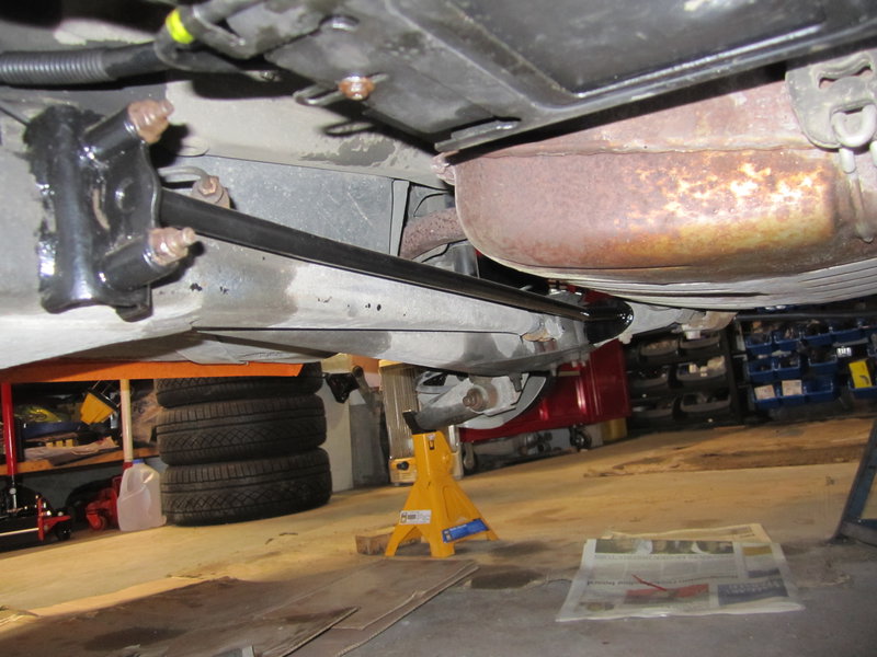

The advice on jacking the car up is good, but make sure it is supported and have someone move the wheel gripped at 3 and 9 o'clock and look just forward of the rear wheel
Above is the rear anti-sway bar which is mounted on the front of the rear axles and behind the fuel tank
This is the delta link, and can be seen forward of the rear wheel just inside the rear rocker panel. There is one each side. They have a rubber insert in them that degrades with age and are a bear to replace without the proper tools. On the other end of the axle for each side is a standard bush which also degrades with age. Both are important.

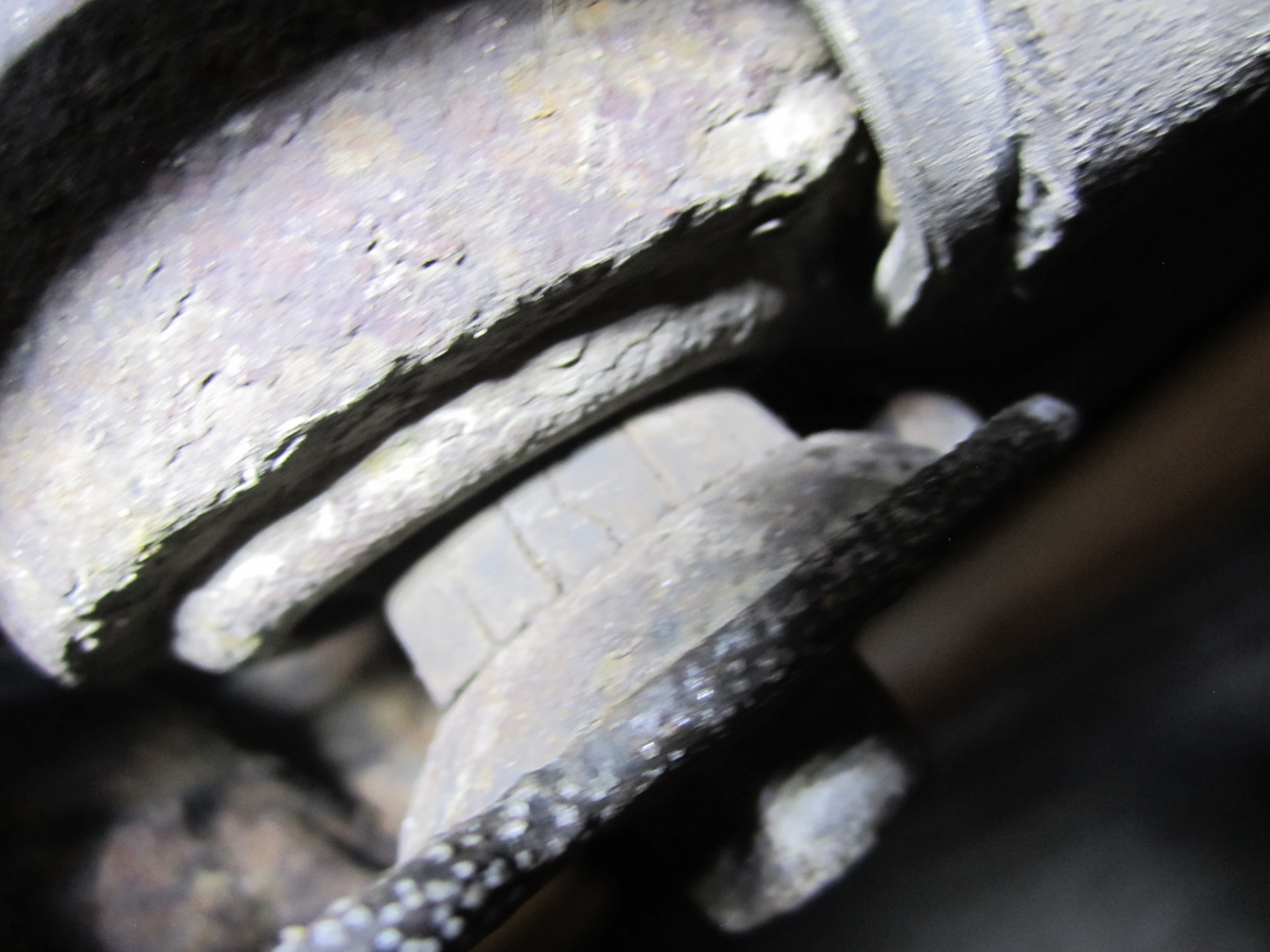

Jacked the car up to replace the fuel filter. Sporting a shiny new Bosch now instead of corroded "Made in China". Distributor cap arrived damaged from FCP, so that's going to have to wait. I felt no play in either rear wheel with hands at 12 & 6 and 9 & 3, wheels in the air or on the ground. I can see what I believe is the delta link. The rubber is deteriorating, but no play makes me think it's okay for now.

How does a shipper damage a dist. cap? Those things are built stout! I've cleaned up both before with a Moto-tool. Remove all evidence of carbon tracking. Replace and see if the problem goes away. You can clean the MAF with a CRC spray. Don't use brake cleaner!!
Odd, intermittent, hard starts, hesitation, coughs, etc. can also be due to deterioting wire insulation on both camshaft & crank position sensors. Also ensure the coil wire is as far as possible from their wires.
