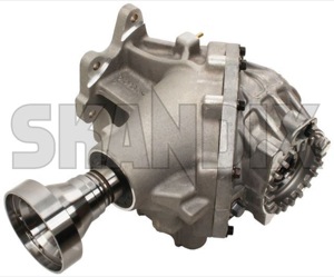

What kind of oil goes in the pancake? I'm referring to the one that is to the right of the transmission with the drive shafts coming out of it.

I think he means the bevel gear/angle gear. 75W-90 synthetic. Volvo has a low foaming spec for this so other brands will say they do not meet the spec.
Its important to keep up on this fluid due to the bevel gears proximity to the turbo.
Volvo offers an oil for this https://www.fcpeuro.com/products/volvo- ... l-31259380

ANGLE GEAR
Use Volvo fluid only

ANgle gear. To the right of the transmission with shafts coming out of it, per OP.
