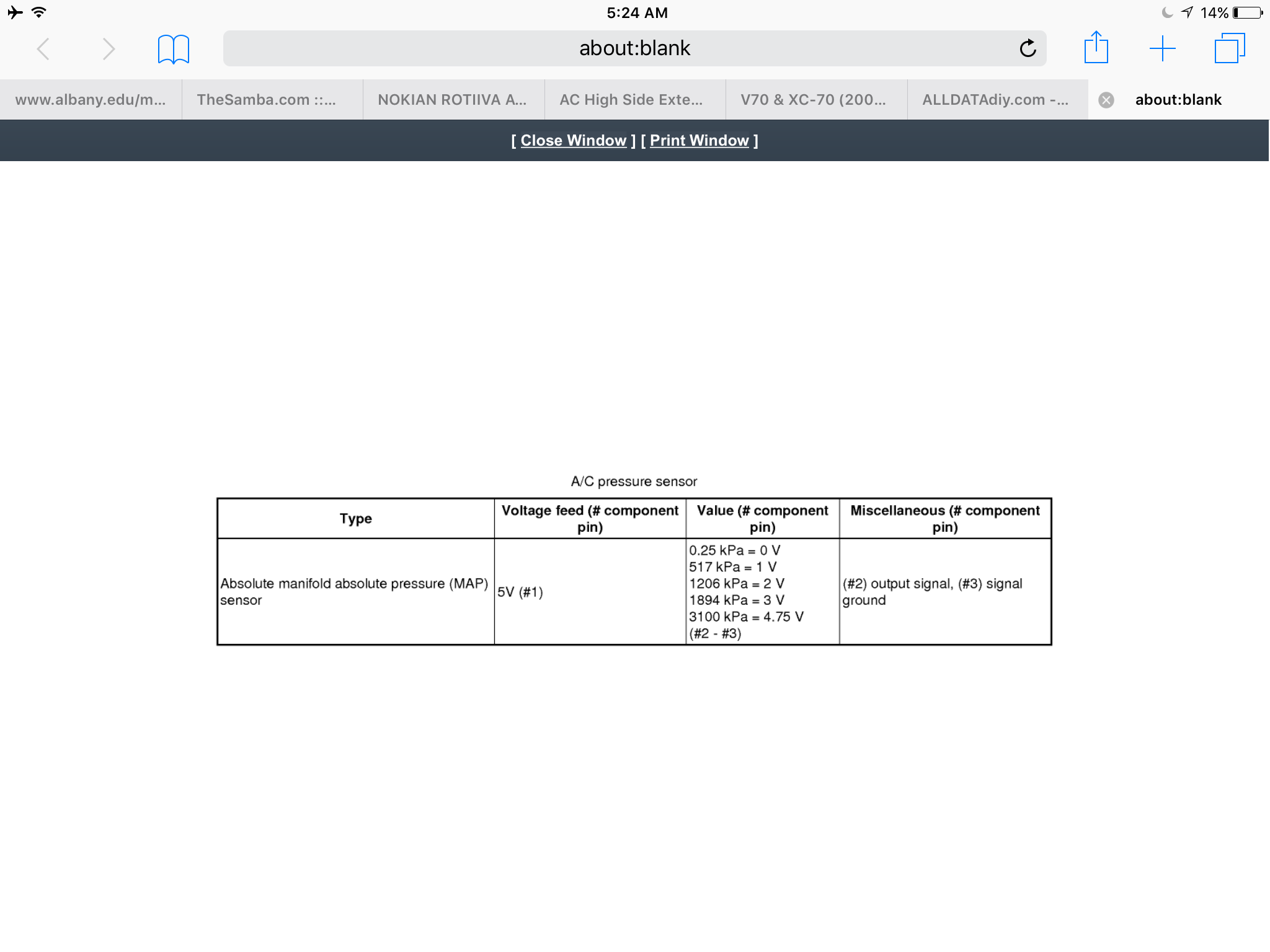

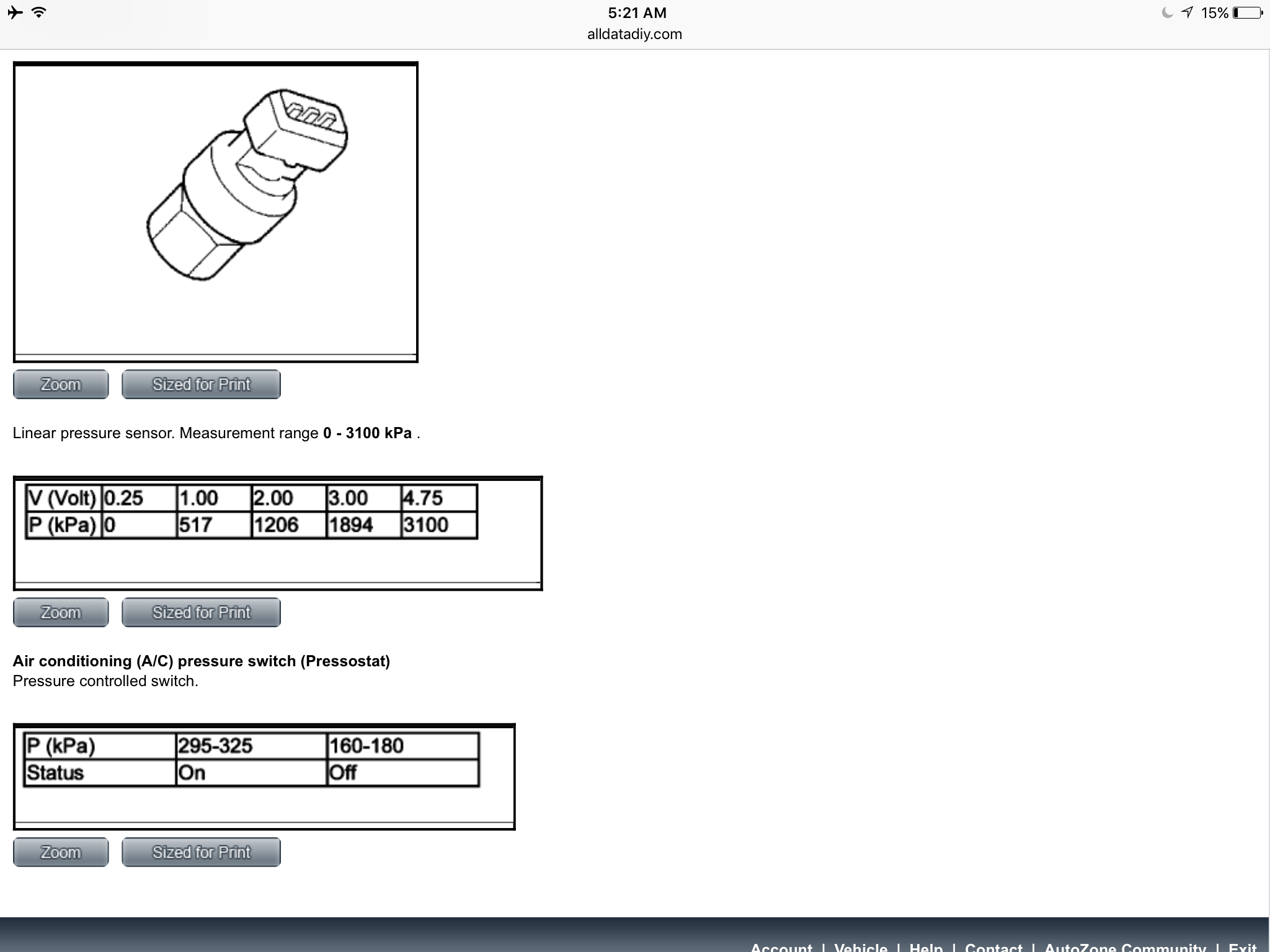

- Posts: 36147
You can probably monitor the voltage on the high pressure pressostat too...ill see if can find the chart and pinouts

this topic also seems to say Vida can read the a/c pressure
http://www.volvoforums.org.uk/showthrea ... ost2263737
