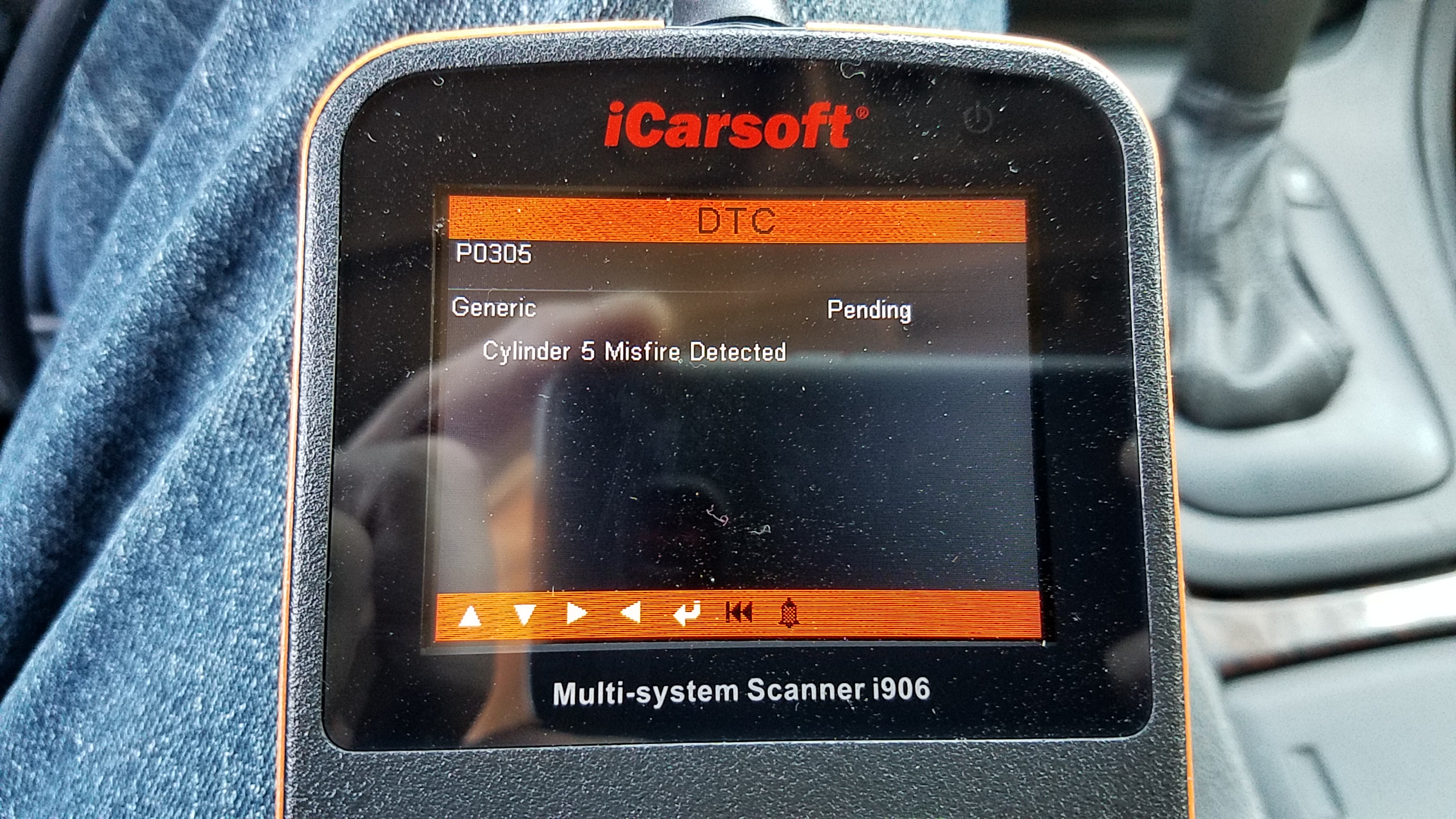

Drove the car for about an hr, nothing. Five minutes from my driveway and it starts misfiring. This time the CEL flashed. It's still pretty random but now I have a place to look.
I'll keep updating, I'm going to take a look tomorrow after work when it's cold.
