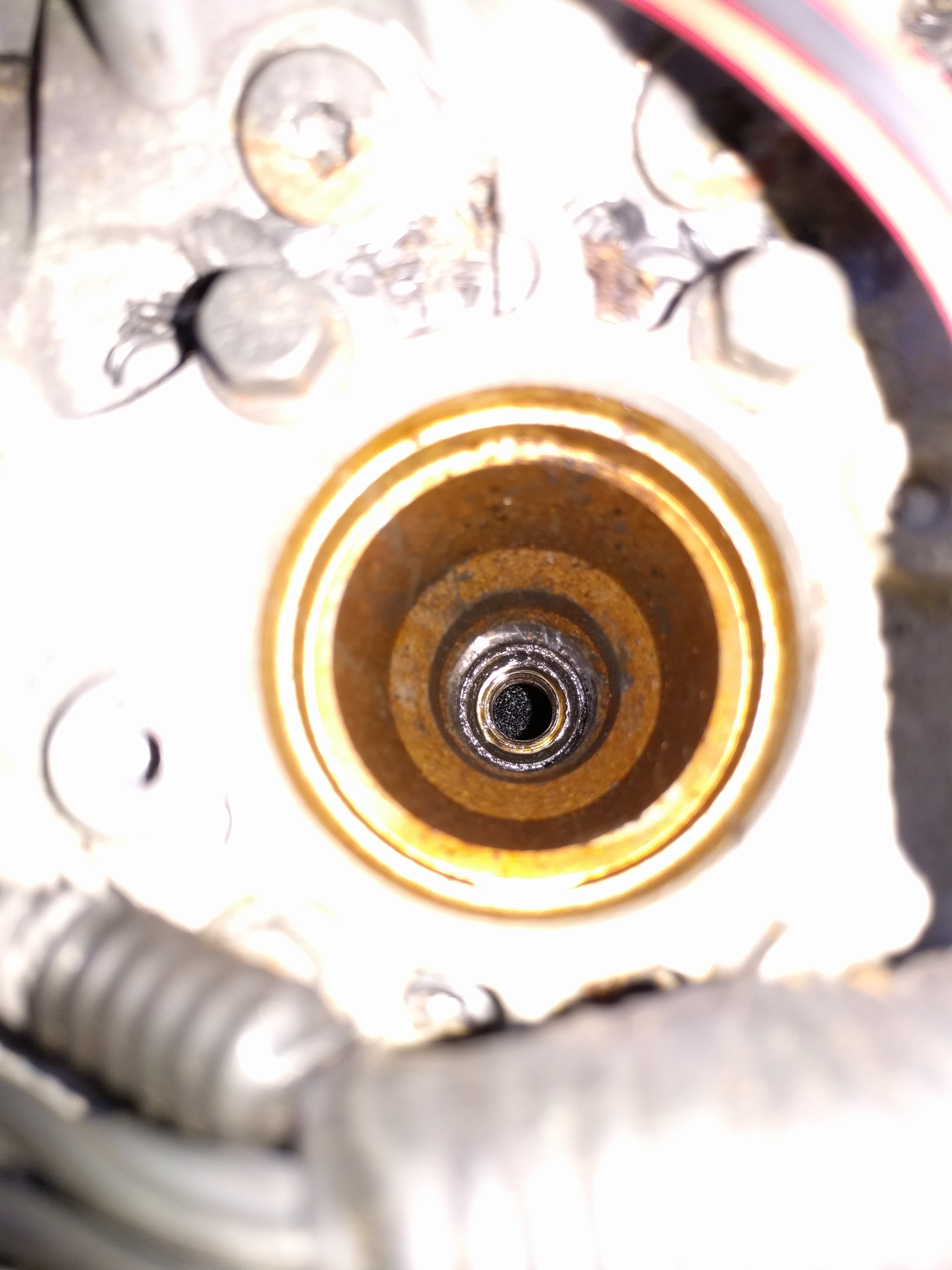

A month ago, my car experienced a sudden loss of power on the highway, thankfully near an AutoZone. I immediately replaced all the spark plugs and found the one in the driver's side cylinder was destroyed. The plug was loose, caked in black, its ceramic was missing, and the cylinder hole was caked in brown. Surprisingly, the car ran fine until this sudden loss of power.

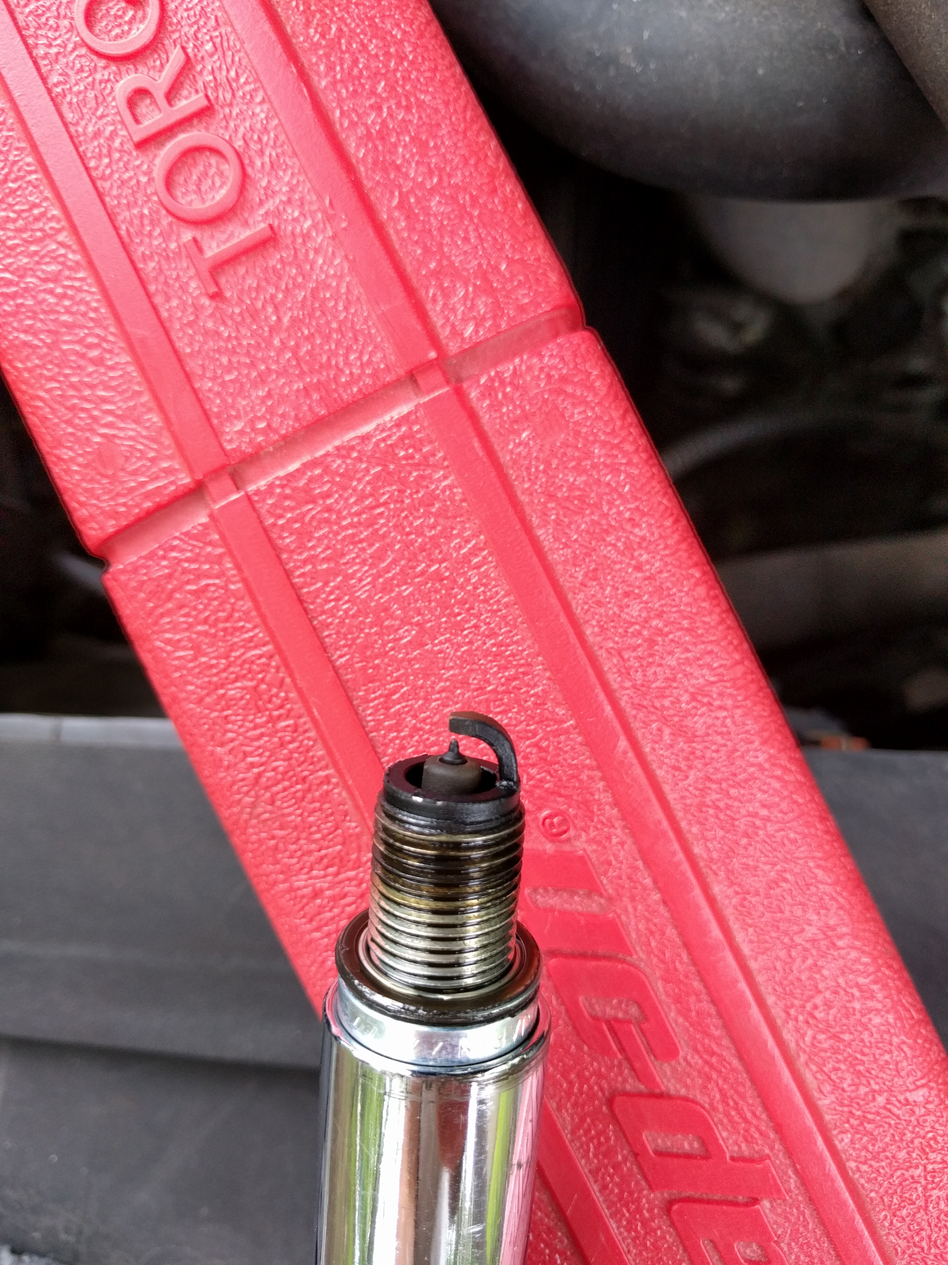

I installed NGK Iridium IX plugs. On my first drive, I felt a few significant misfires. Every day after that, I'd feel a gentle misfire at idle once every two seconds, and a few slight misfires while driving. I assumed the NGK plugs were to blame, so I planned to swap them with OEM Volvo plugs.

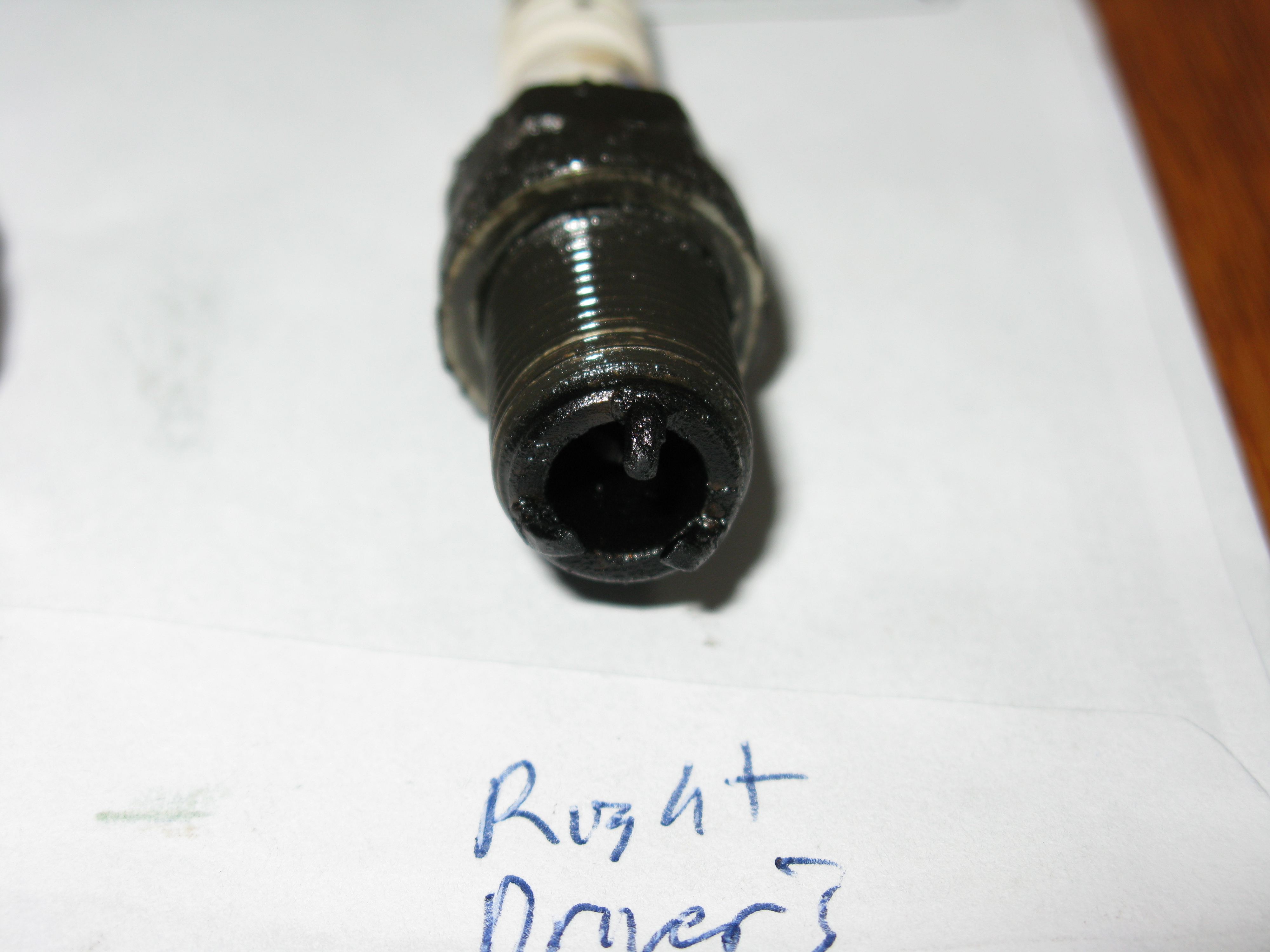

Today, one month and 1500 miles later, I checked the driver's side cylinder and found it fouled. The car still drives fine except for the slight misfires described above.
What could be causing this plug to foul so quickly?

That plug isn't that bad and will still fire.
Any misfire codes?
Compression test might be next

You can do the compression test yourself, it's pretty easy and stores like AutoZone will let you use the gauge for free. It will tell you how well the composition chamber is sealing - health of piston rings, intake valves, exhaust valves, head gasket can play a part in compression.

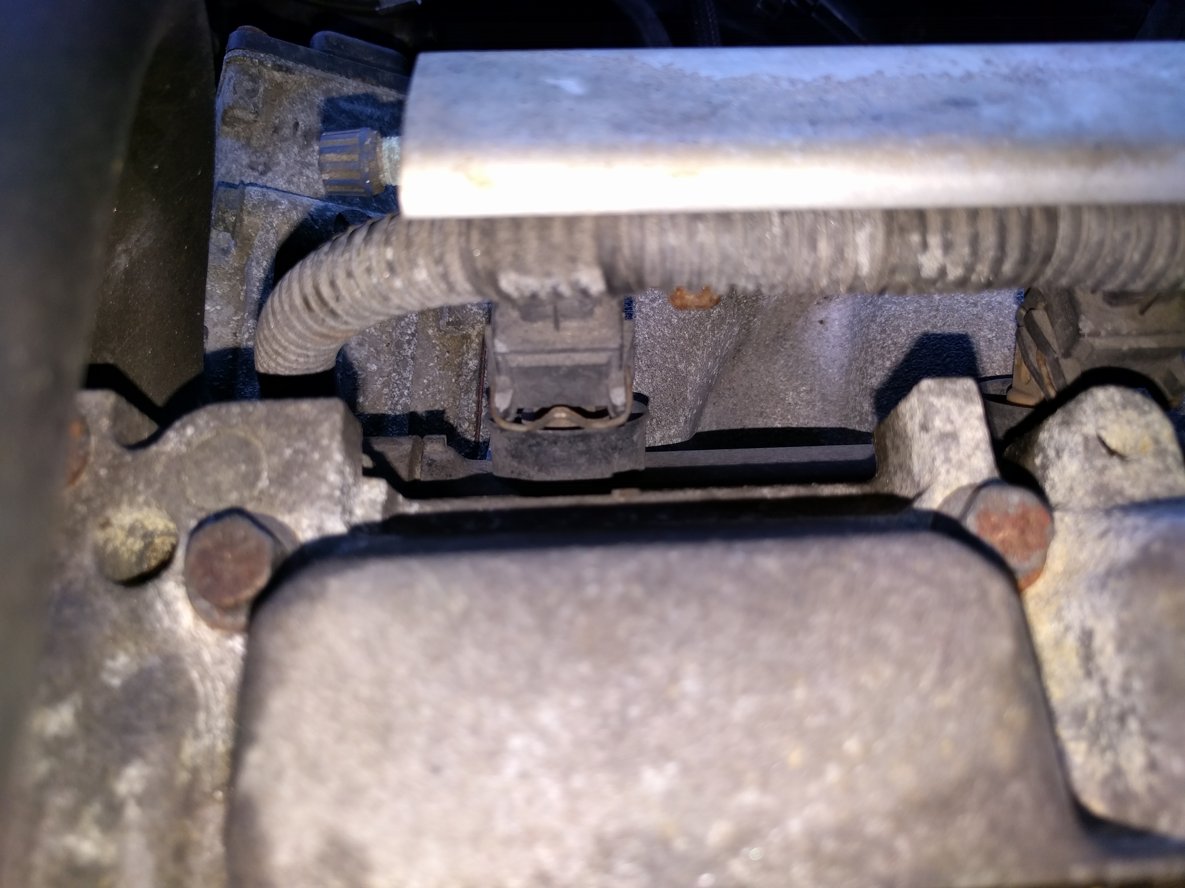

I'm confused by the various compression test instructions that I have.
The Haynes UK book tells me to, "Disable the ignition system by disconnecting the RPM sensor wiring just below the distributor. Also disconnect the wiring to each fuel injector." I see the RPM sensor but can't trace its wire to a source. How do I disconnect it?
And are these the fuel injector wires? Must I pull the retaining wire away from the plug to free them? That will be tricky when the engine is hot. Alternatively, the compression tester tool's box says to disconnect the ignition coil., singular. Does this simply mean to disconnect each of the five coils which connect to the spark plugs? Do this even though the coils are off the plugs and the plugs are out of the engine?
Lastly, a thread here says to pull the fuel pump fuse or relay.
Which of these steps must I do to prepare for the compression test? Also, please confirm the reasons for them so that I may learn why they're being done. Thanks.

You want to
(1) avoid unnecessary spark in the engine bay (without stressing out the coil(s))
(2) stop fuel from being added to the non-firing cylinders, as this may wash the oil off the cylinder walls and lead to reporting of a falsely low compression value. Hence pulling the fuel pump fuse or relay.
I actually don't know the best way to disable spark on an engine with coil packs, I've only compression tested the 98 and earlier cars.
