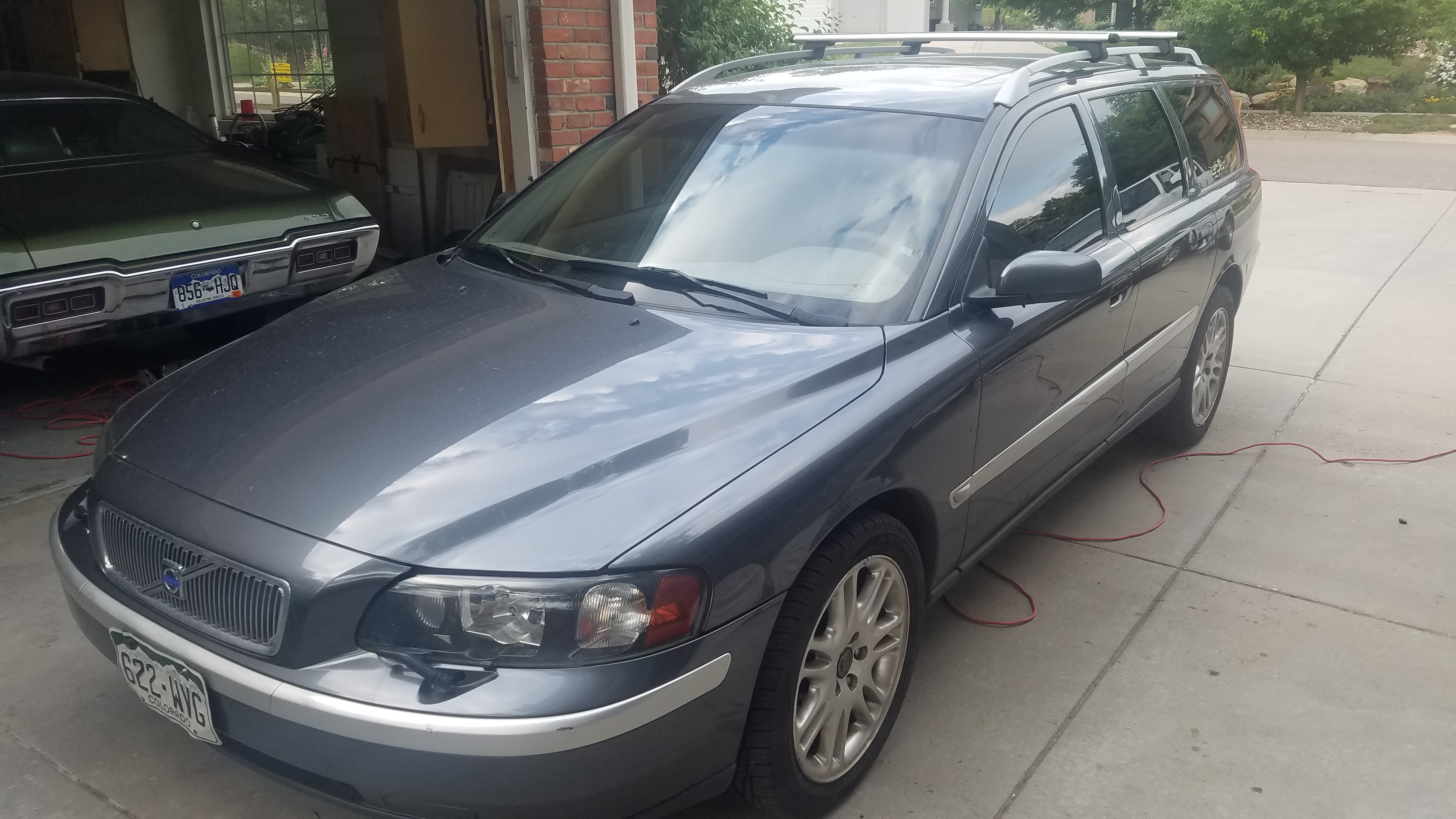

Car has 119k and pulls to the right under acceleration. . Ball joints and tie rods feel tight when jacked up. Last time the volvo shop had it they told me it needed lower motor mounts. Could this be causing the problem? If not any other suggestions? I included a pic of the car. Thanks
