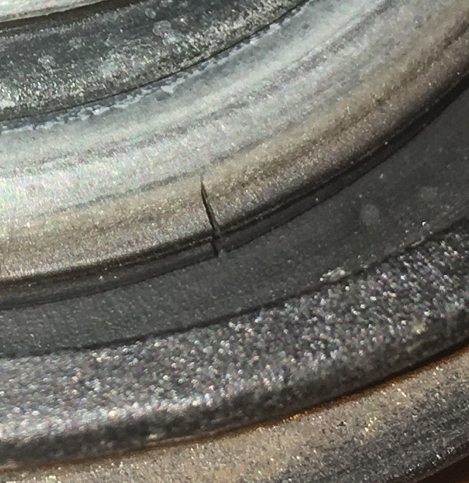

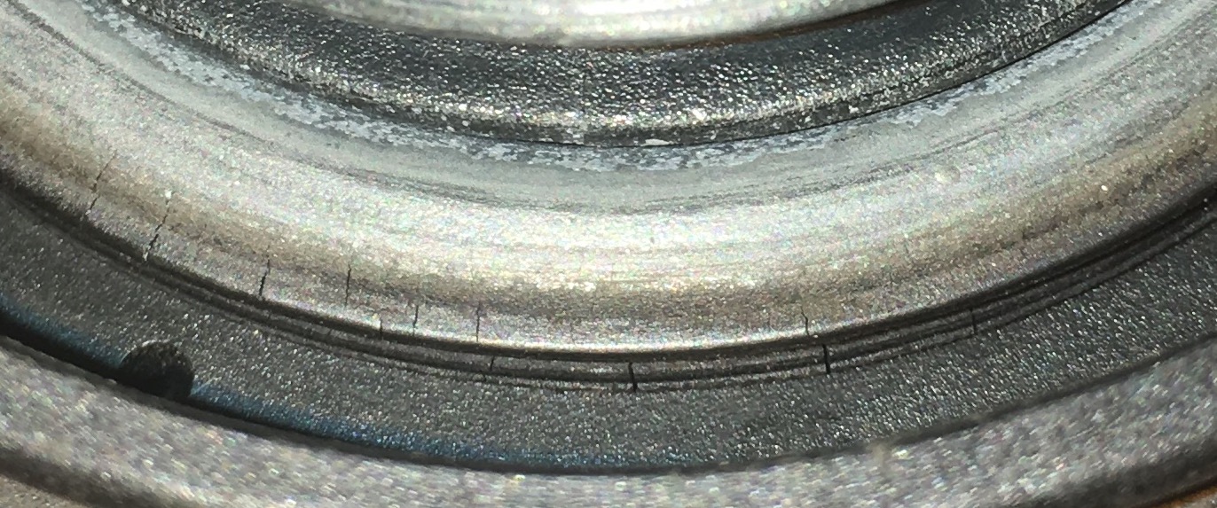

Re: Gas Cap: I think we got a new (genuine volvo) fuel cap when we bought the car in 2015, and after we first started getting this code, we tried an aftermarket (Duralast) cap, but it didn't seem to make a difference, so we went back to the Volvo cap. That being said, looking at the cap now, I can see that there are a number of hairline cracks in the gasket material: Obviously those images are zoomed way in, but I suppose it doesn't take much for fuel vapor to escape. $10 at the local parts store to try an aftermarket cap again probably isn't too much of a gamble. AutoZone has both a "push vented" and "standard" version of the cap. Does it matter which one I get?
