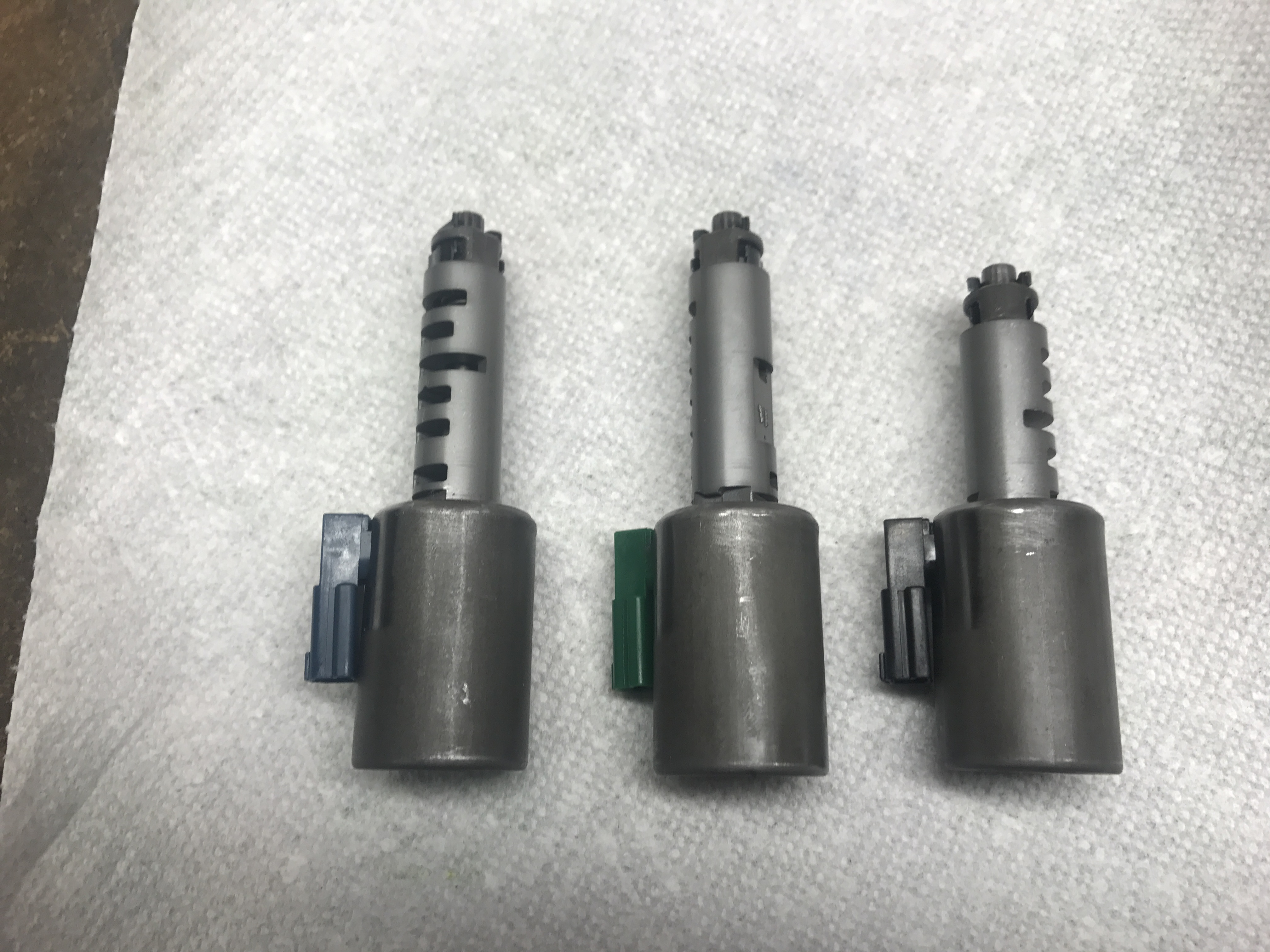

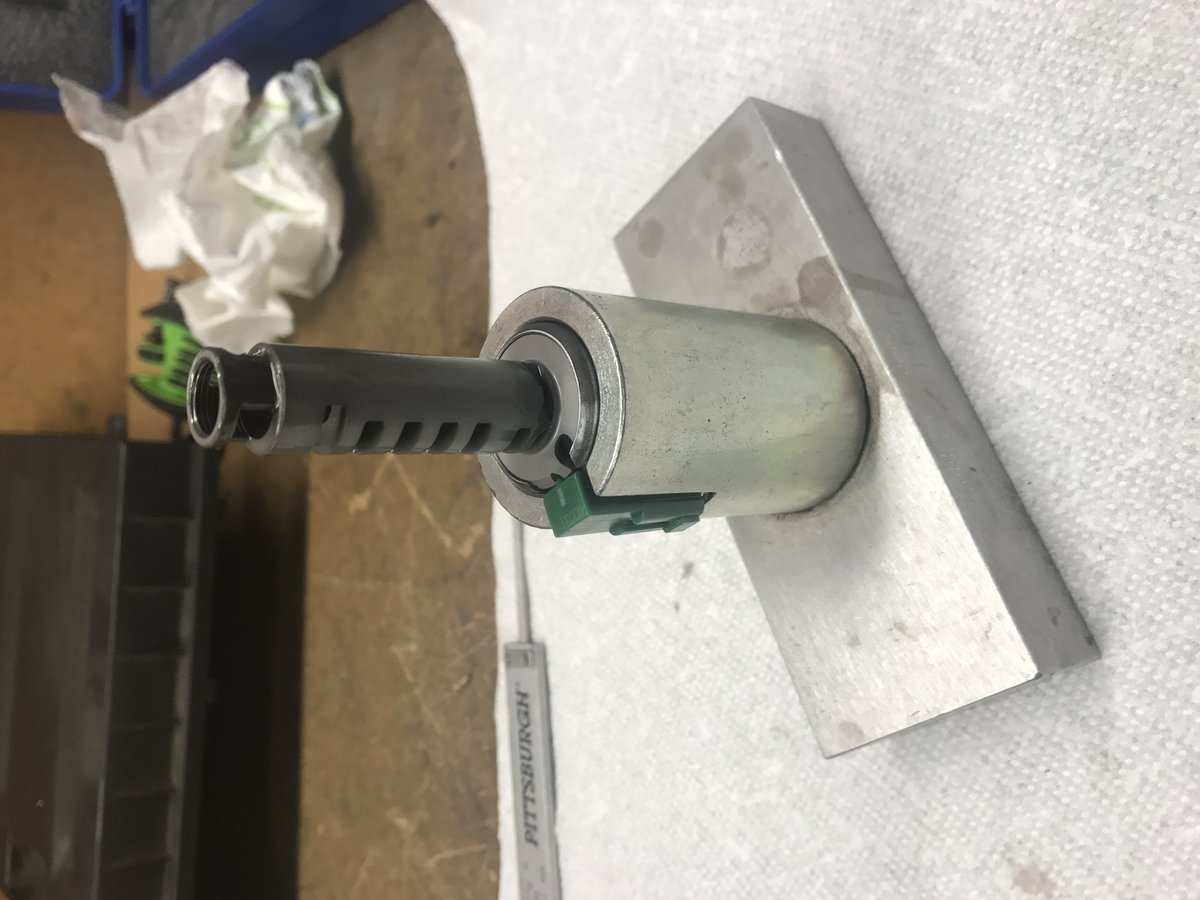

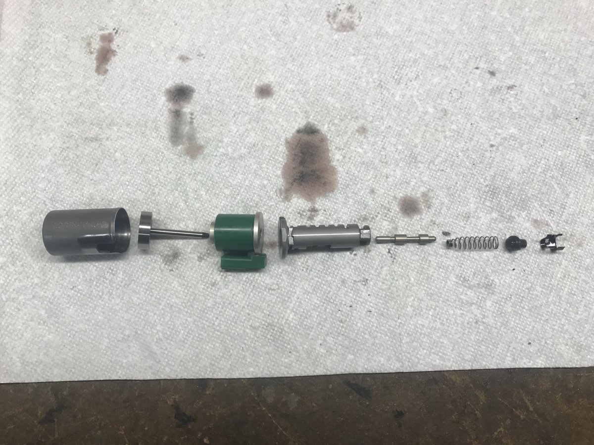

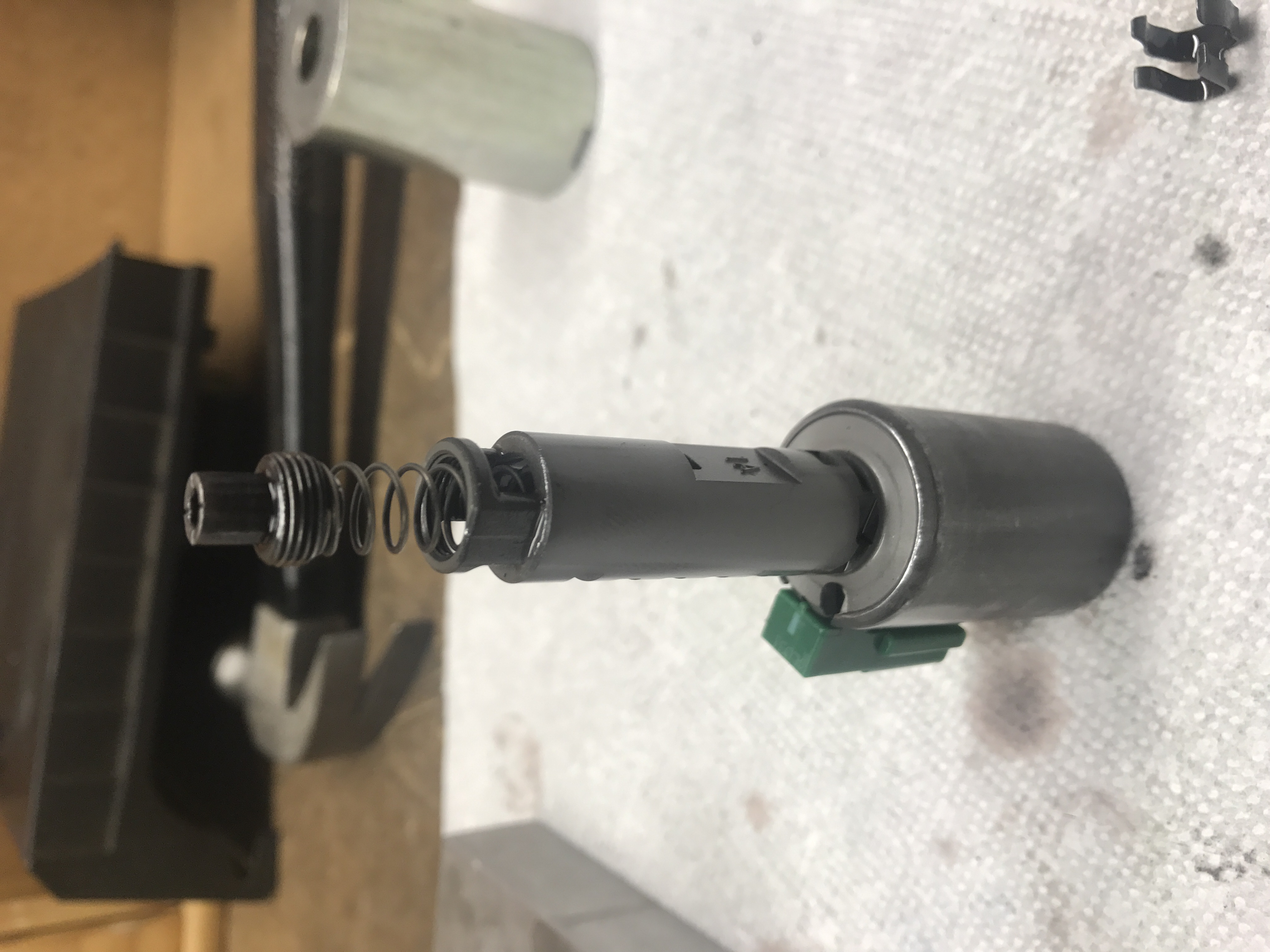

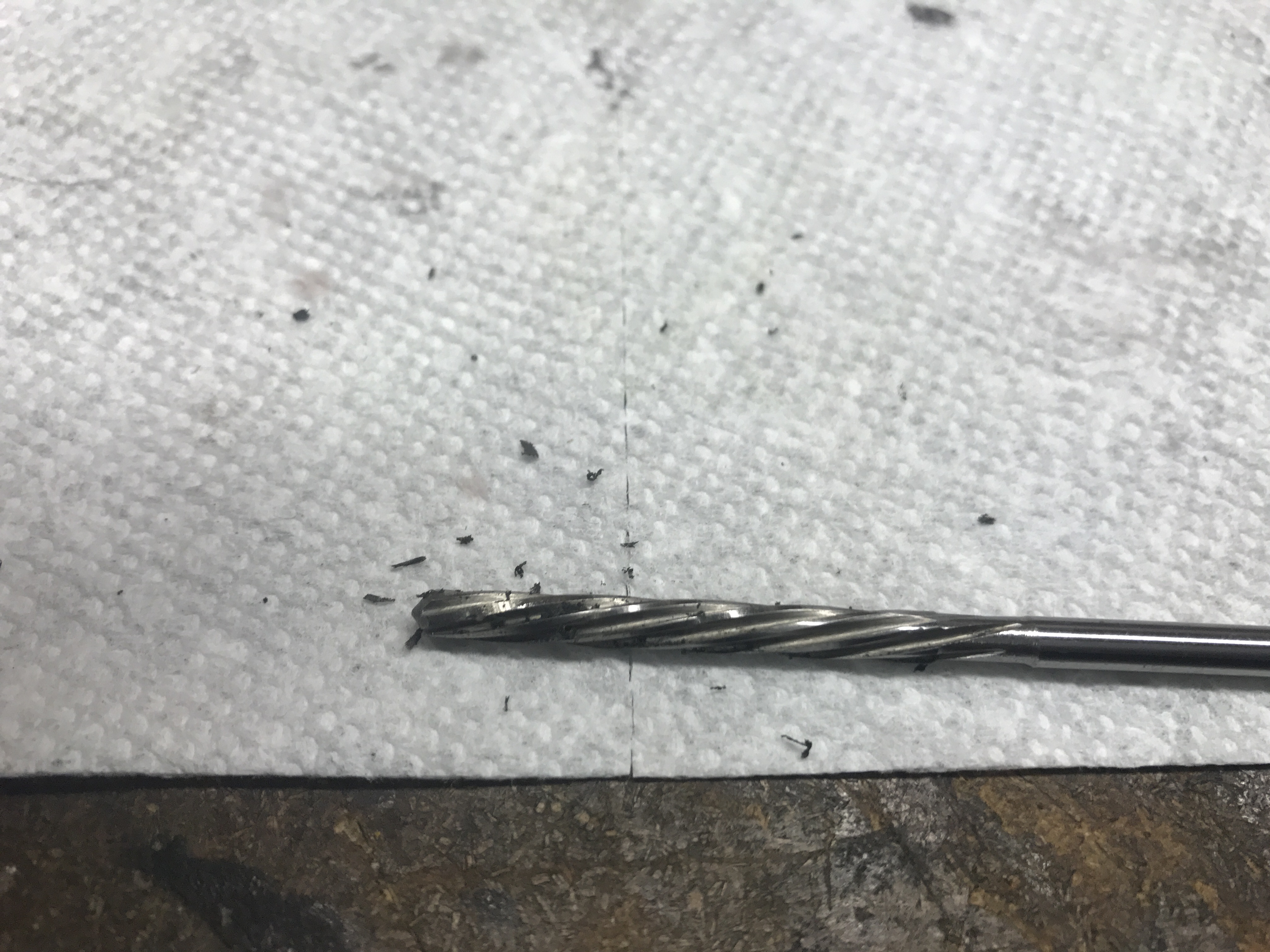

Monday night means solenoid cleaning time!

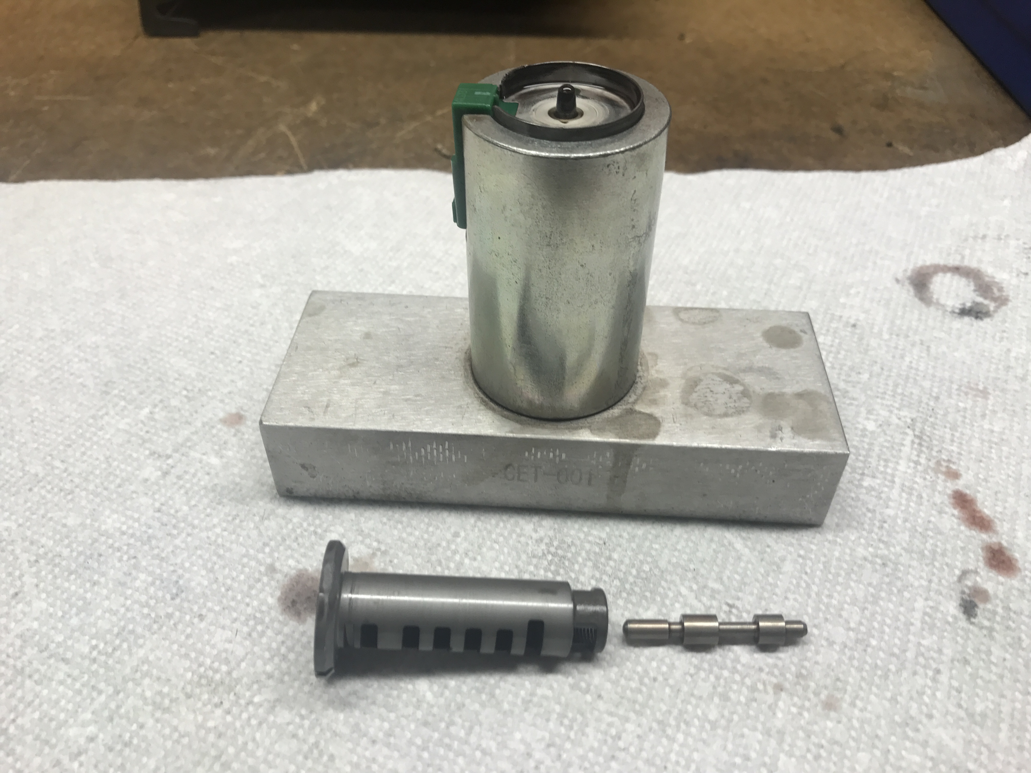

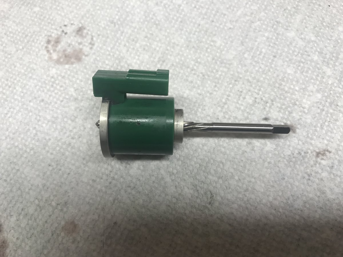

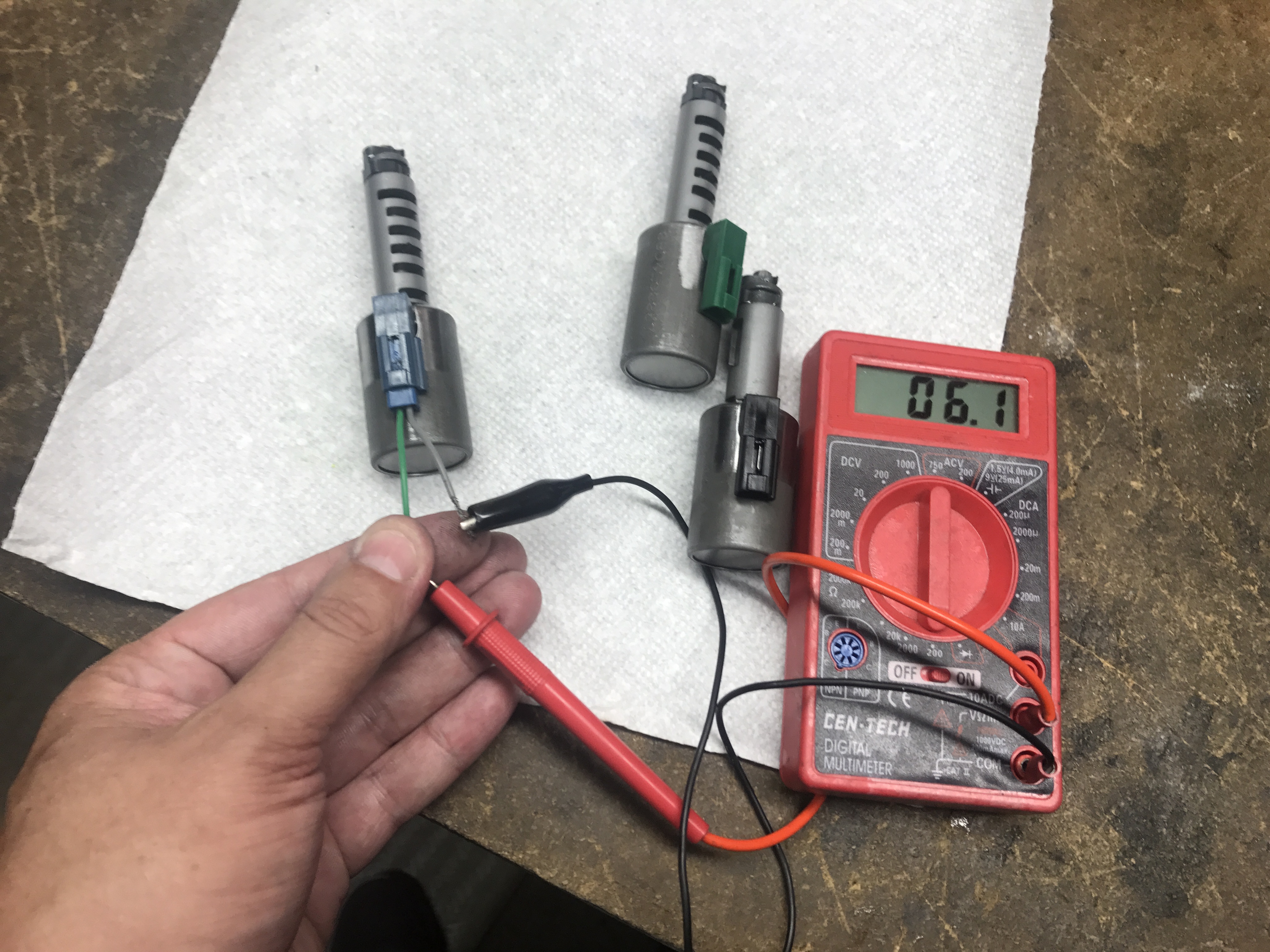

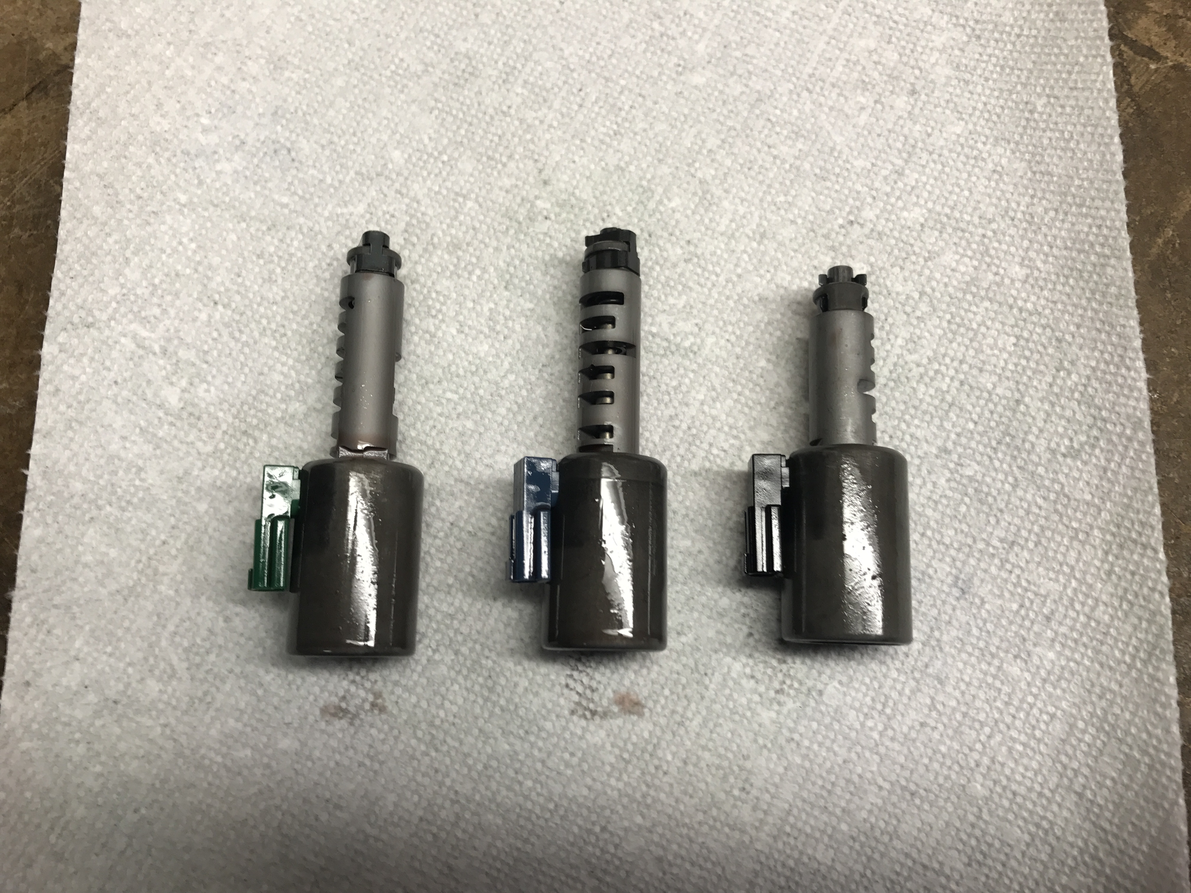

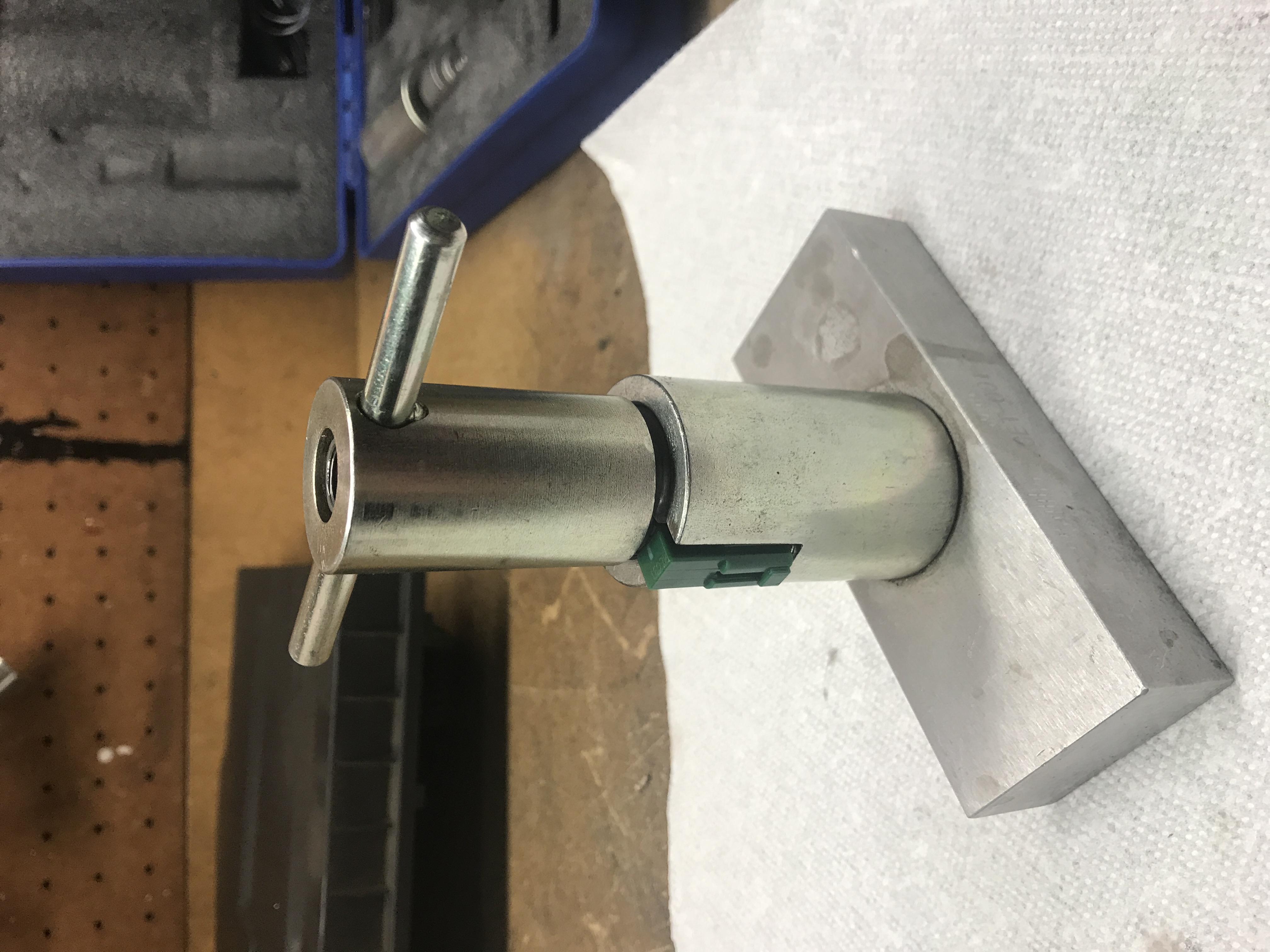

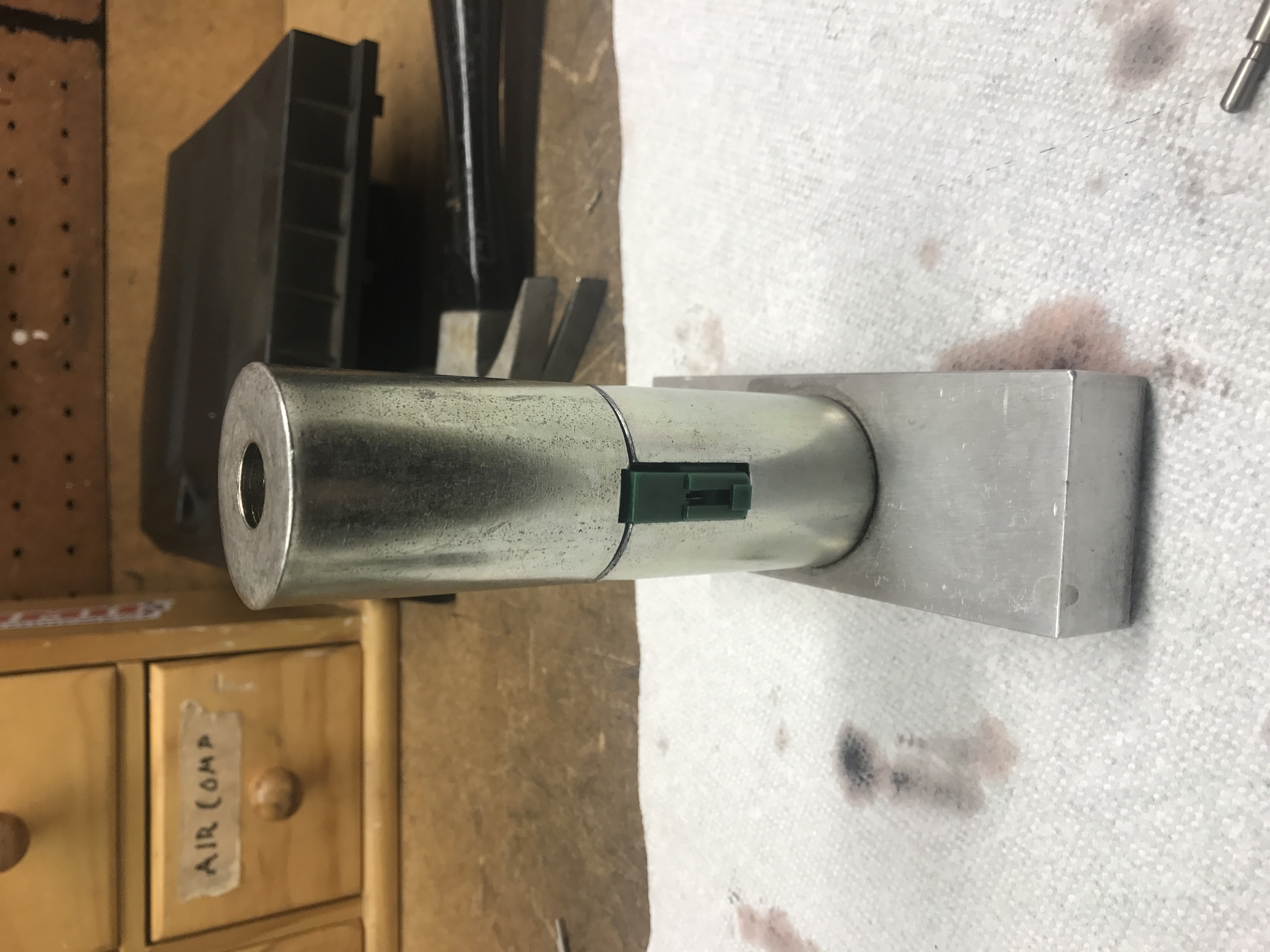

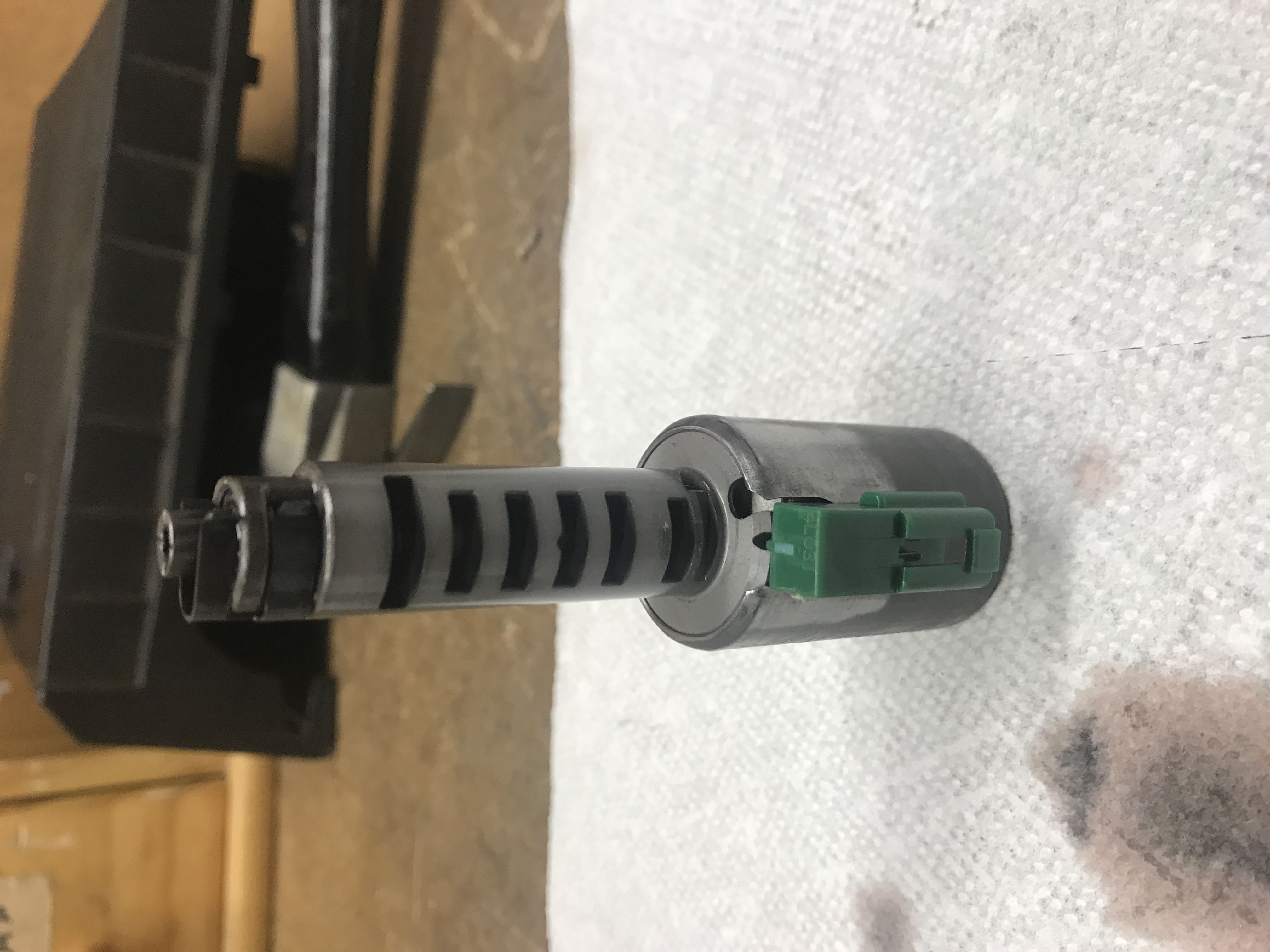

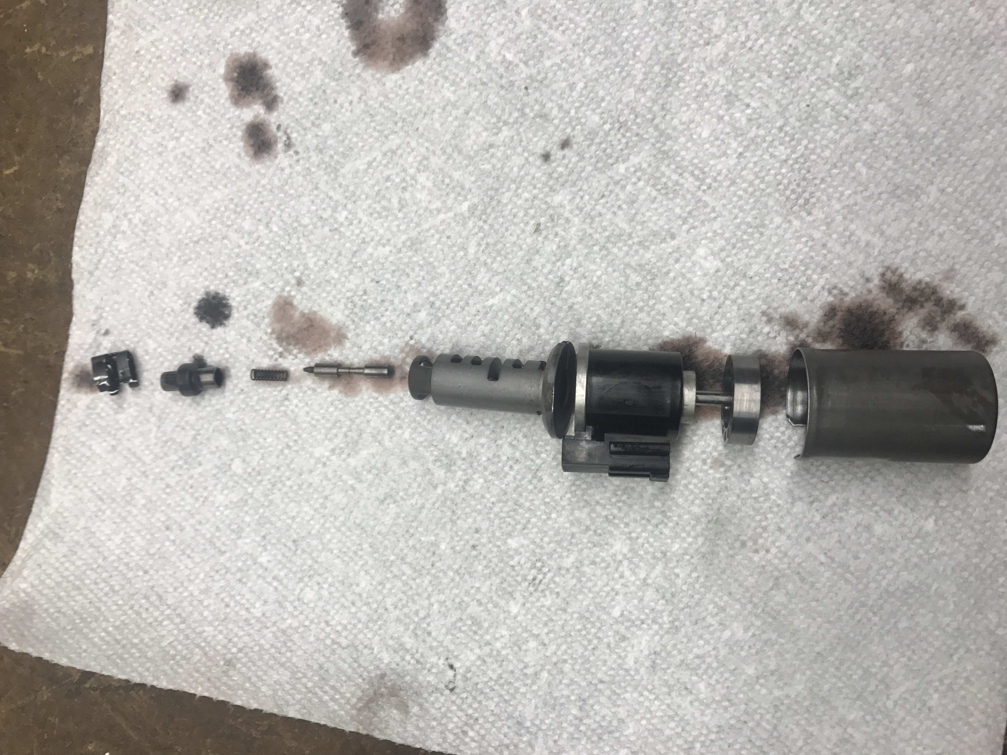

All solenoids reading 6 Ohm Starting with the SLS solenoid Rolling it open Internal components Using a reamer to clean out the bushings Dirt from reaming Closing time The SLU internals look a bit different. This one was by far the dirtiest of the three. All three done Gonna try and find some time this week to install the solenoids. Stay tuned for the result.

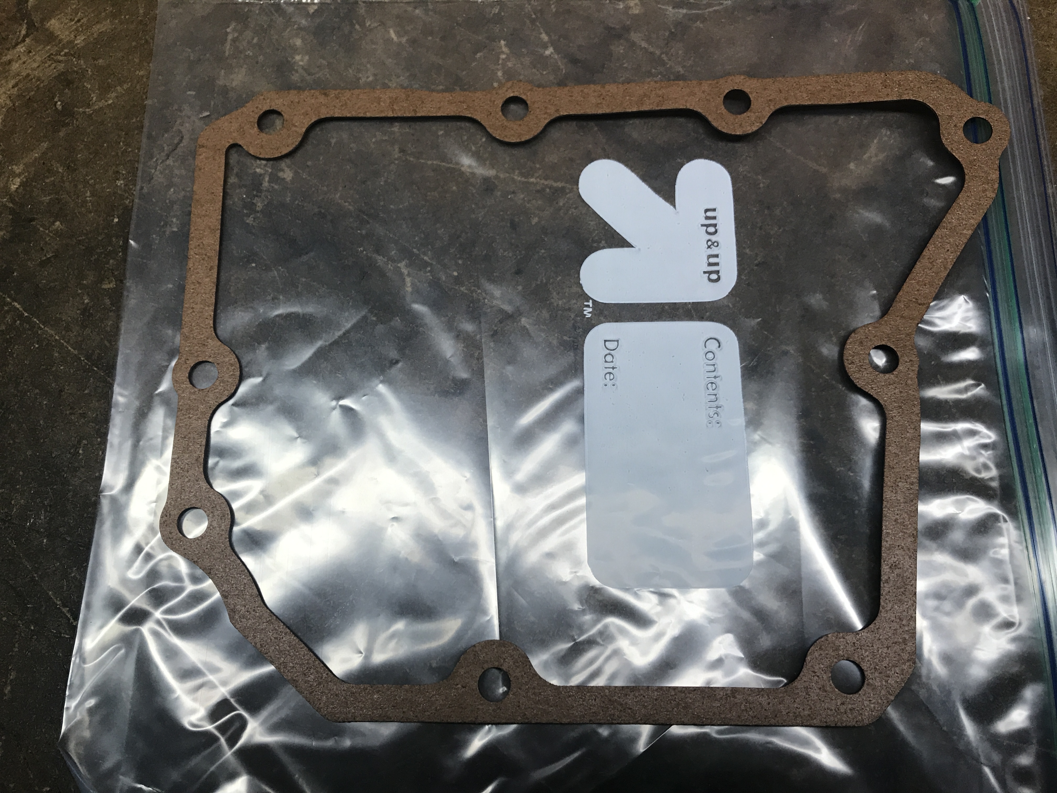

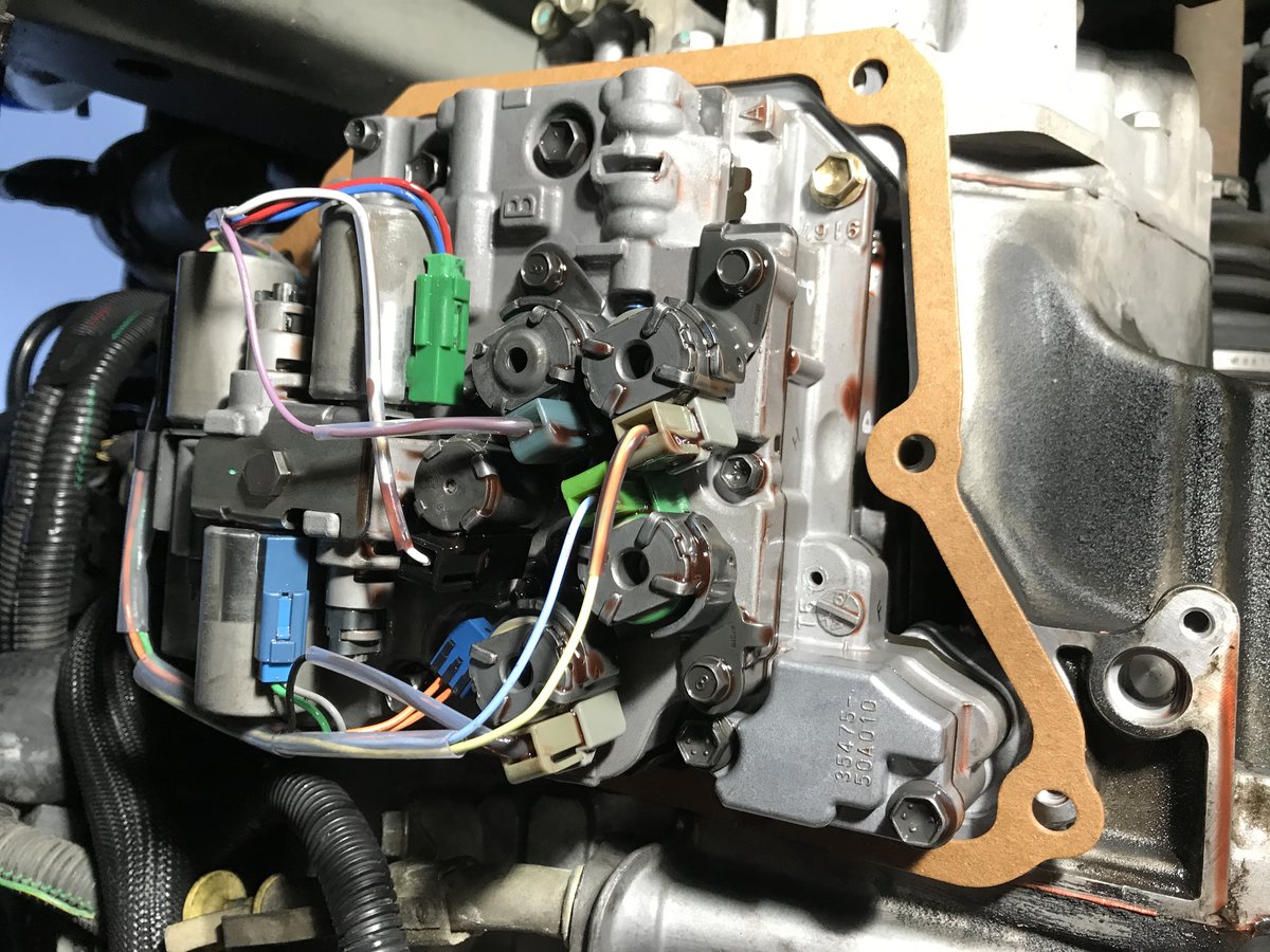

Clean valve body cover
Solenoids fitted

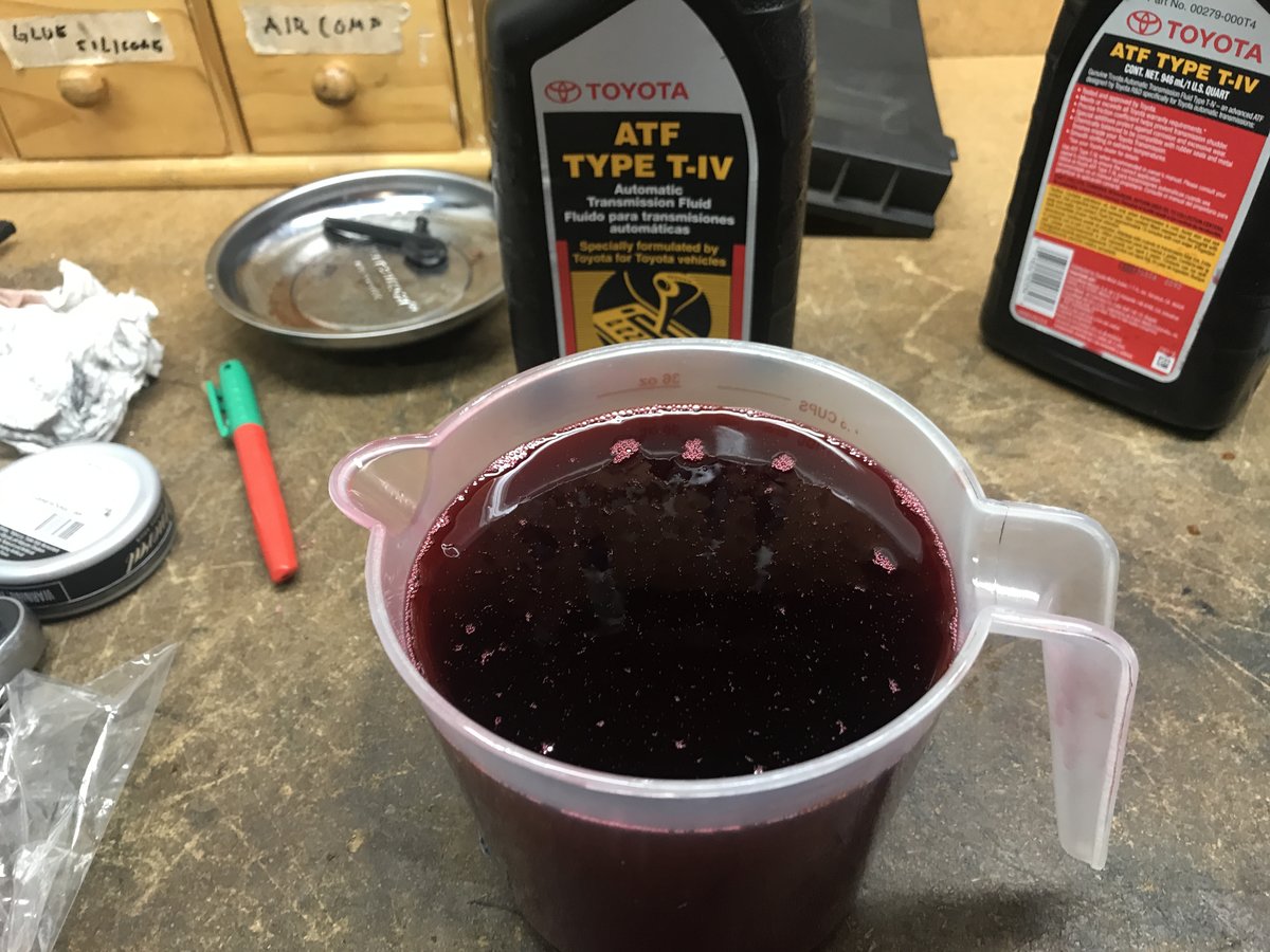

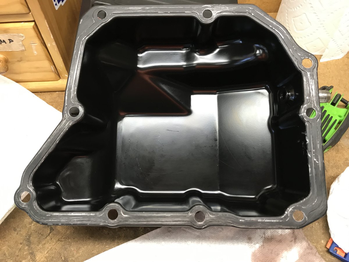

Dirty old transmission fluid. Actually it wasn't as bad as I thought it would be. More brown/red than black.
New fluid

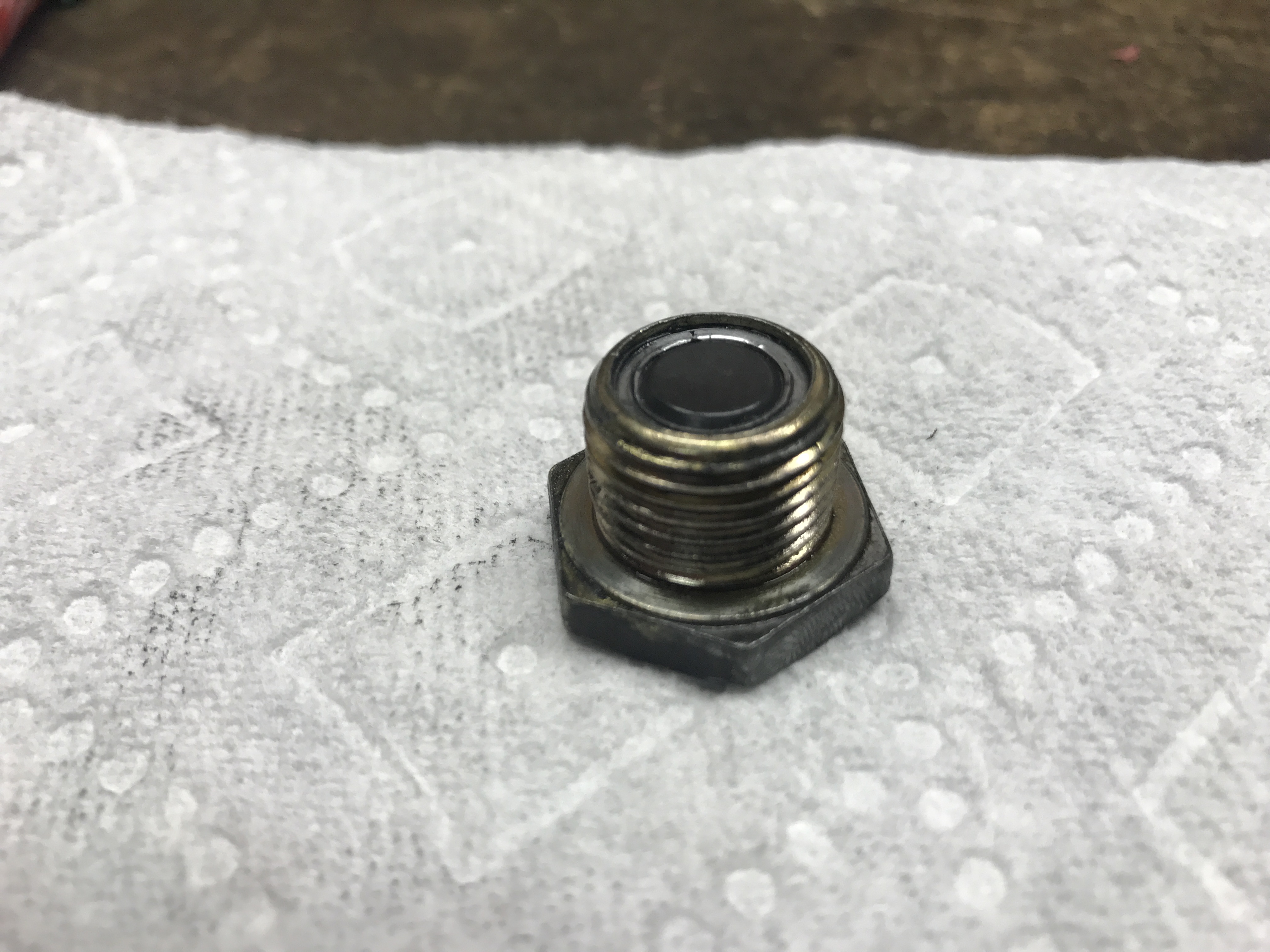

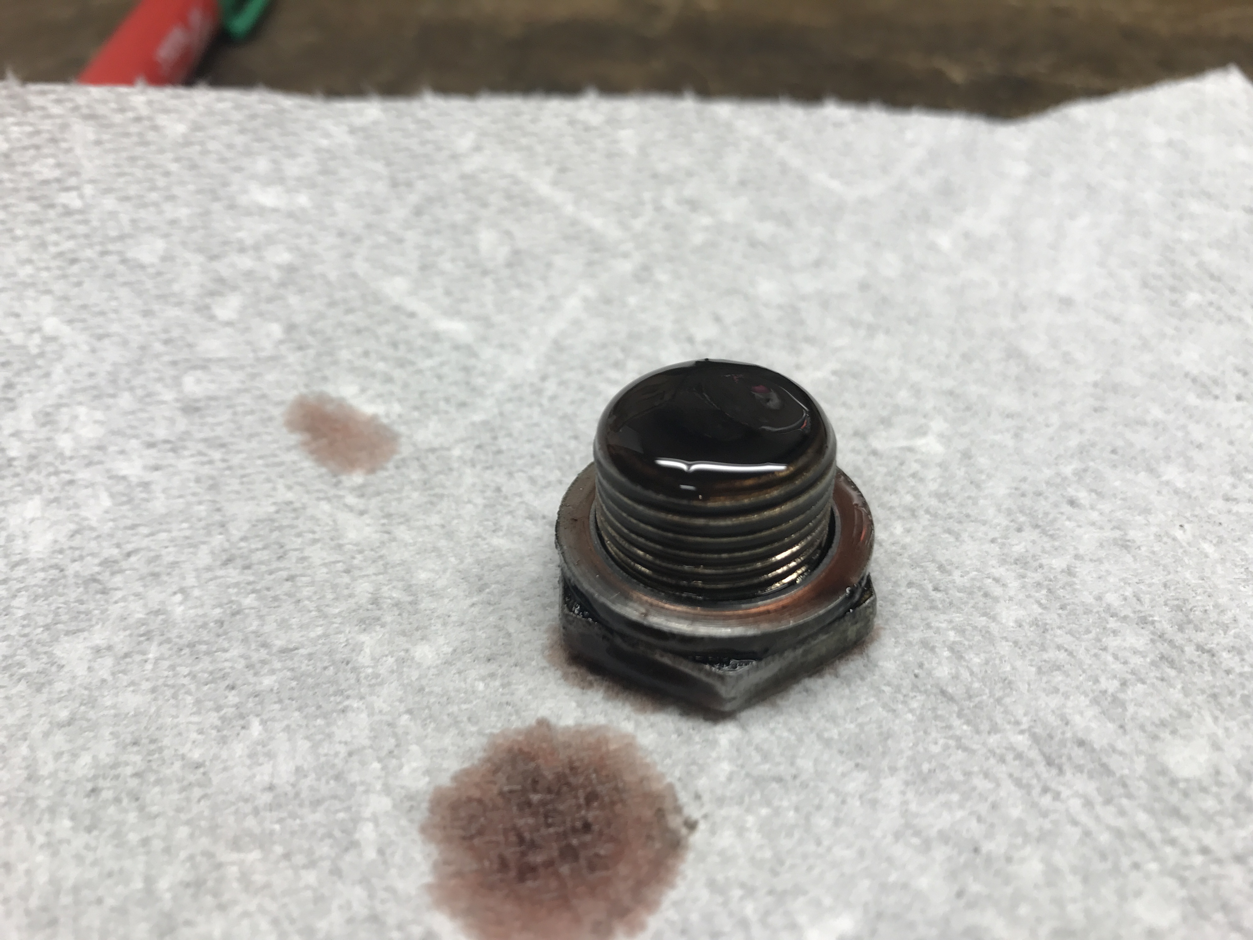

Drain plug had caught some debris
Clean
