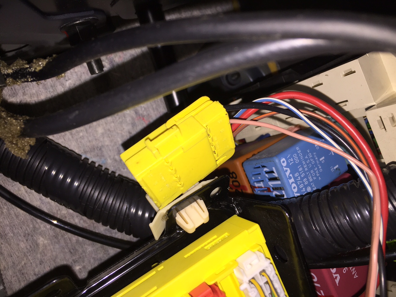

If it's the same as my V70, there should also be an 'accessory plug' located in the drivers footwell, on the left, in between the latch for the hood and steering column. It has several pins. The red wire is constantly powered and has a 20 amp fuse.
See the picture attached, I stole it from another MVS thread.

And here are two links with more info.
First thread also contains a post on plug pinout.
viewtopic.php?f=1&t=79253
viewtopic.php?t=69527
