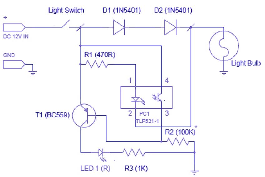

Incandescent bulbs do not communicate directly on the CAN network. An analog lamp control circuit essentially probes the lamp circuit for continuity, over or under current. Data communication is limited to between computer control boxes - such as between control circuit that trips an input on a SOC inside the CEM that then generates a digital message over the CAN network which the DIM reads to display a warning message. In older cars before CAN, lamp out warnings were triggered by a 100% analog circuit, a typical example:
In a P2 originally equipped with incandescent bulbs, a similar circuit would exist inside the CEM or REM. But instead of directly lighting a warning lamp, the output of this analog circuit, labeled "LED 1 (Red)" triggers an input on a computer chip. That chip generates CAN data. Not the light bulb that's out or incorrect.
