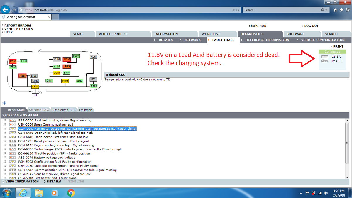

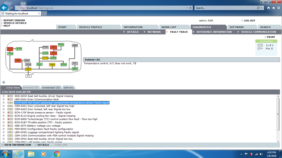

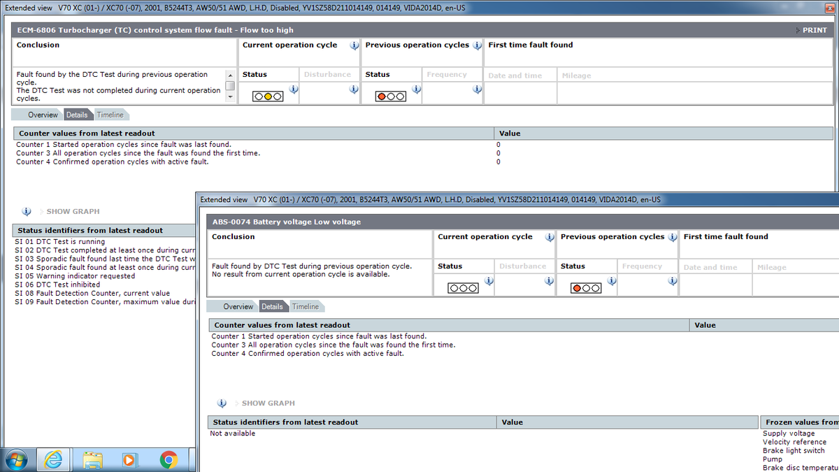

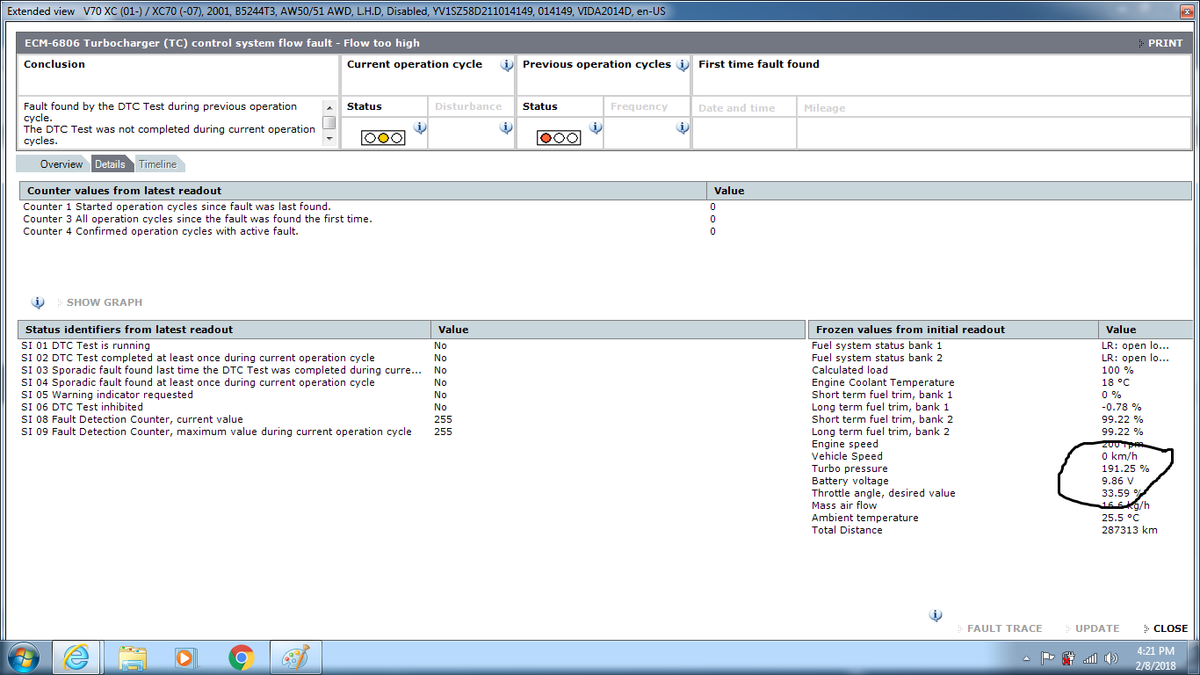

i used two different batteries, both which are good batteries with the same results. dont think its a battery issue. i replaced the long cable from the battery to the fuse box, the fuse box to the starter, and also the wire from the starter to the alternator. beefed up the negative cable also, installed a second cable from the battery. all with 1/0 awg wire. big as shit. alternator wire was 2 ga. nothing else is powered off the cable going to the starter is there? i didnt cut it out of the wire looms, just ran new ones in the general same path. checked visually all the grounds that i could see when i had the carpet pulled up. is there a large ground from the engine to the chassis i seem to be over looking? didnt notice one besides the small one on the back pass side of the engine.
anyways, got the patch for vida and hooked it up. got some weird codes, again. a lot are im guessing due to taking the seat out. pics!

Electronics controlled cars can get picky about the voltages.
- Posts: 35302
- Has thanked: 1505 times
- Been thanked: 3818 times
Indeed:
Electronics controlled cars can get are picky about the voltages.
