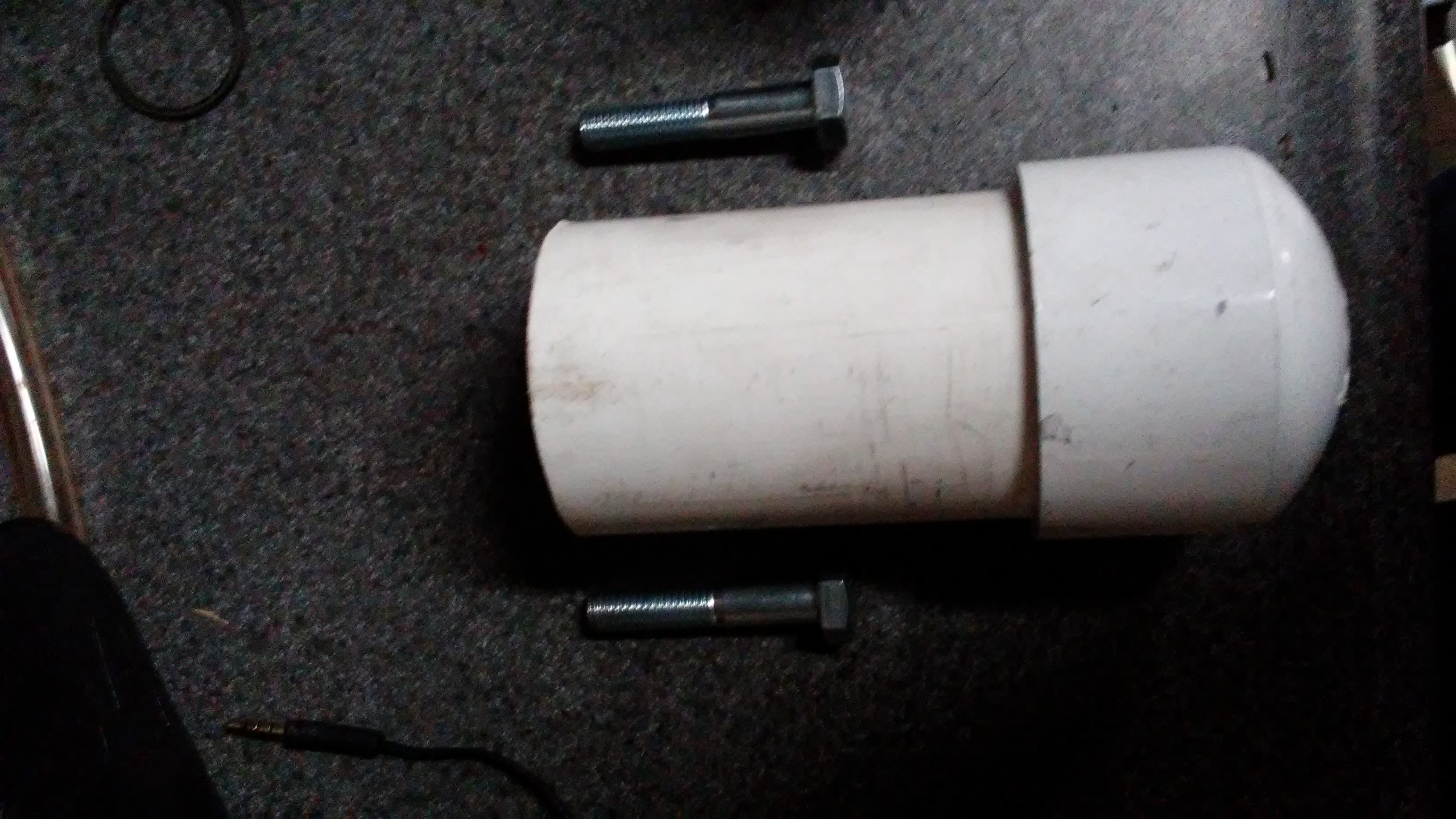

Freezer and a home made 2" PVC driver. Get some extra long bolts for a guide. Use the extra long bolts to hand tighten the ball joint to the knuckle. Then hammer away. Leave the protective plastic boot.
