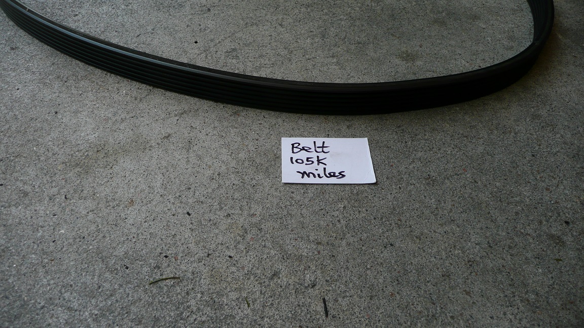

1. The Belt still looks good with virtually no cracks.

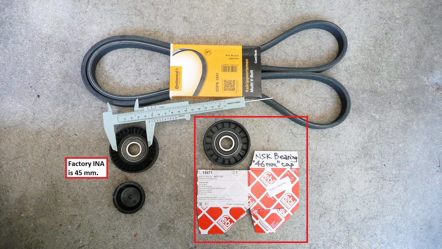

- The Febi Pulley still has the "made in Germany" label but it is now different.
- The Volvo INA Factory Cap is 45 mm.
- The "new" Febi Cap area is 46 mm, so the factory cap does not fit.
- I simply don't wash the engine with pressure-washer, so even without the cap, it is NOT an issue for me.
- This is just a note for those who are particular about INA, then you need to be sure you buy INA pulley.

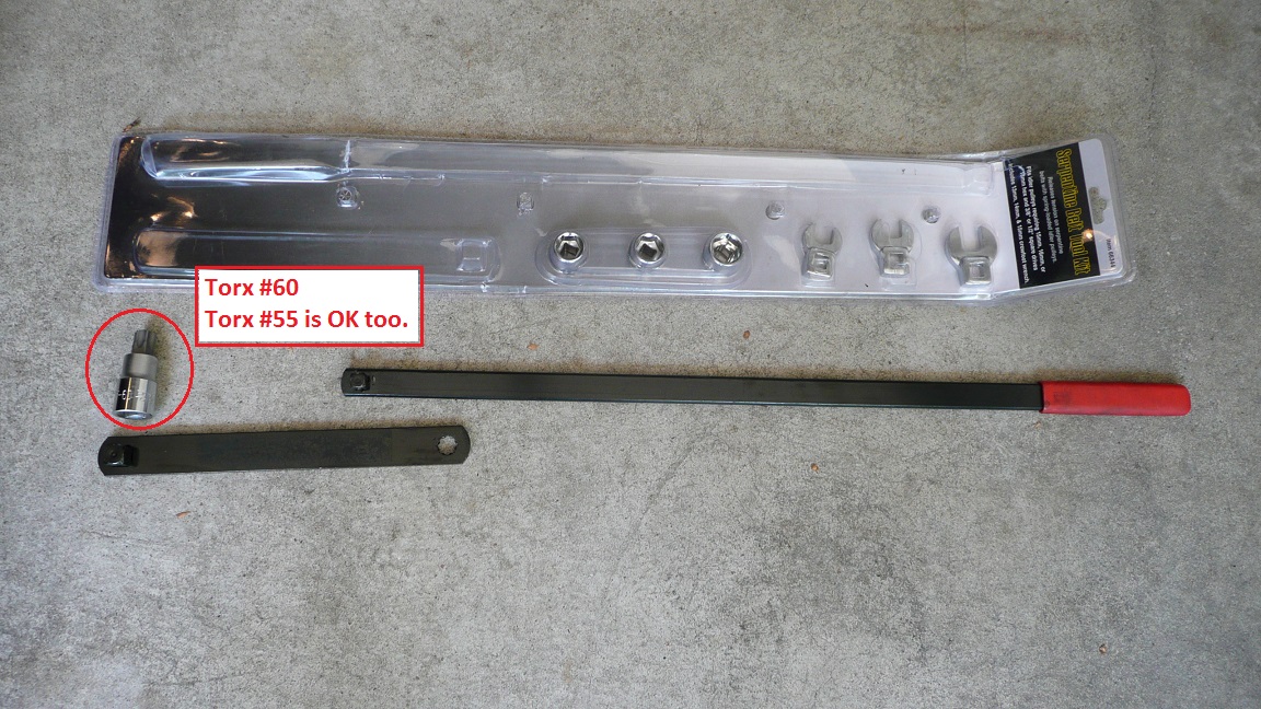

3. The Serp Belt Tool is a MUST!

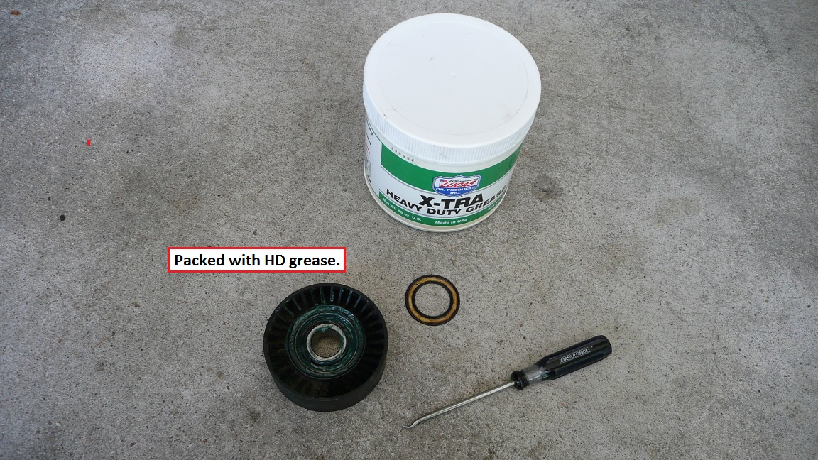

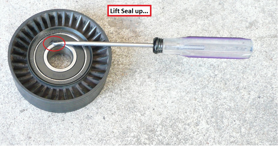

4. Repacked the OLD pulley with fresh grease (use a pick tool to lift the seal, cleaned old grease, packed new grease, gently tap the seal back: check the other side so you know how much to press the old seal back: I just used thumb pressure, then run my finger nail to be sure the seal is about 0.5mm below the surface).

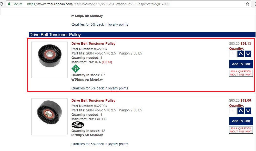

- I bought the Pulley from Rmeuropean, the website clearly says "INA" but they put a Febi in the shipping box.
- Not a big deal b/c the pulley has NSK bearing and I am fine with it b/c NSK is good stuff, just cannot install the dust shield. No big deal.
