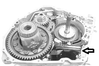

You have the 2.5L which is mated to a Aisin Warner AW50-50/51. The AW50-50/51 cannot be serviced without disassembly. The picture shows the location of the ATF filter. The bolt next to the large gear is what holds the filter in place.

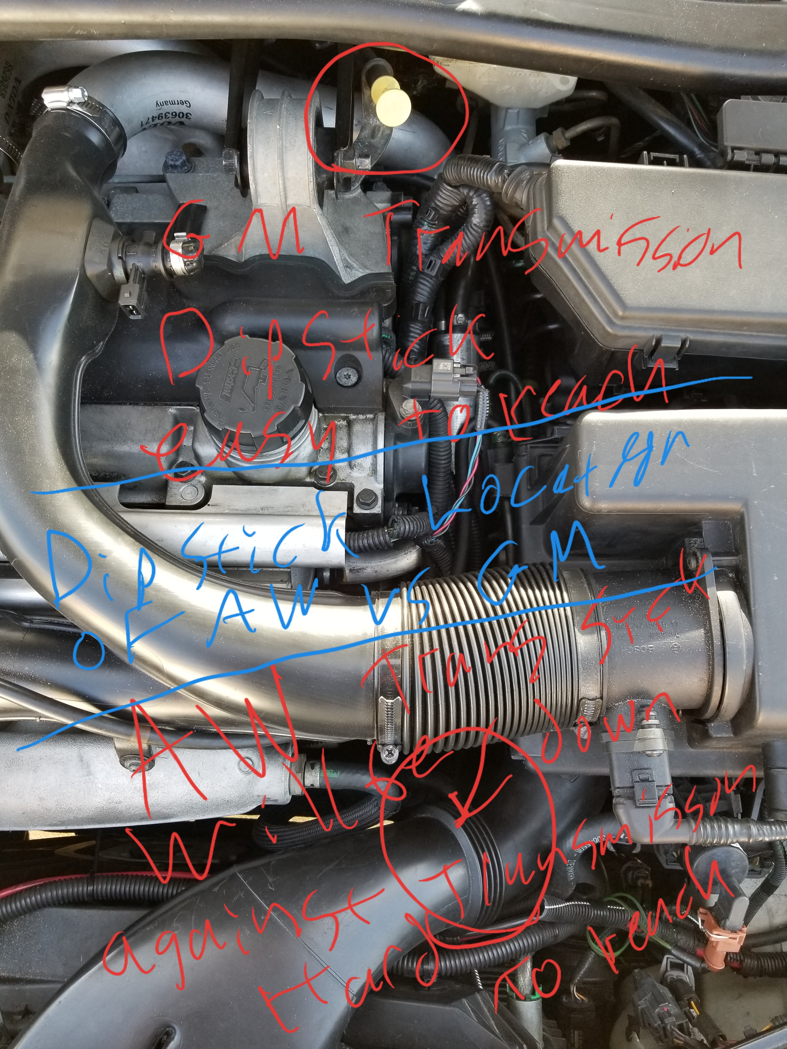

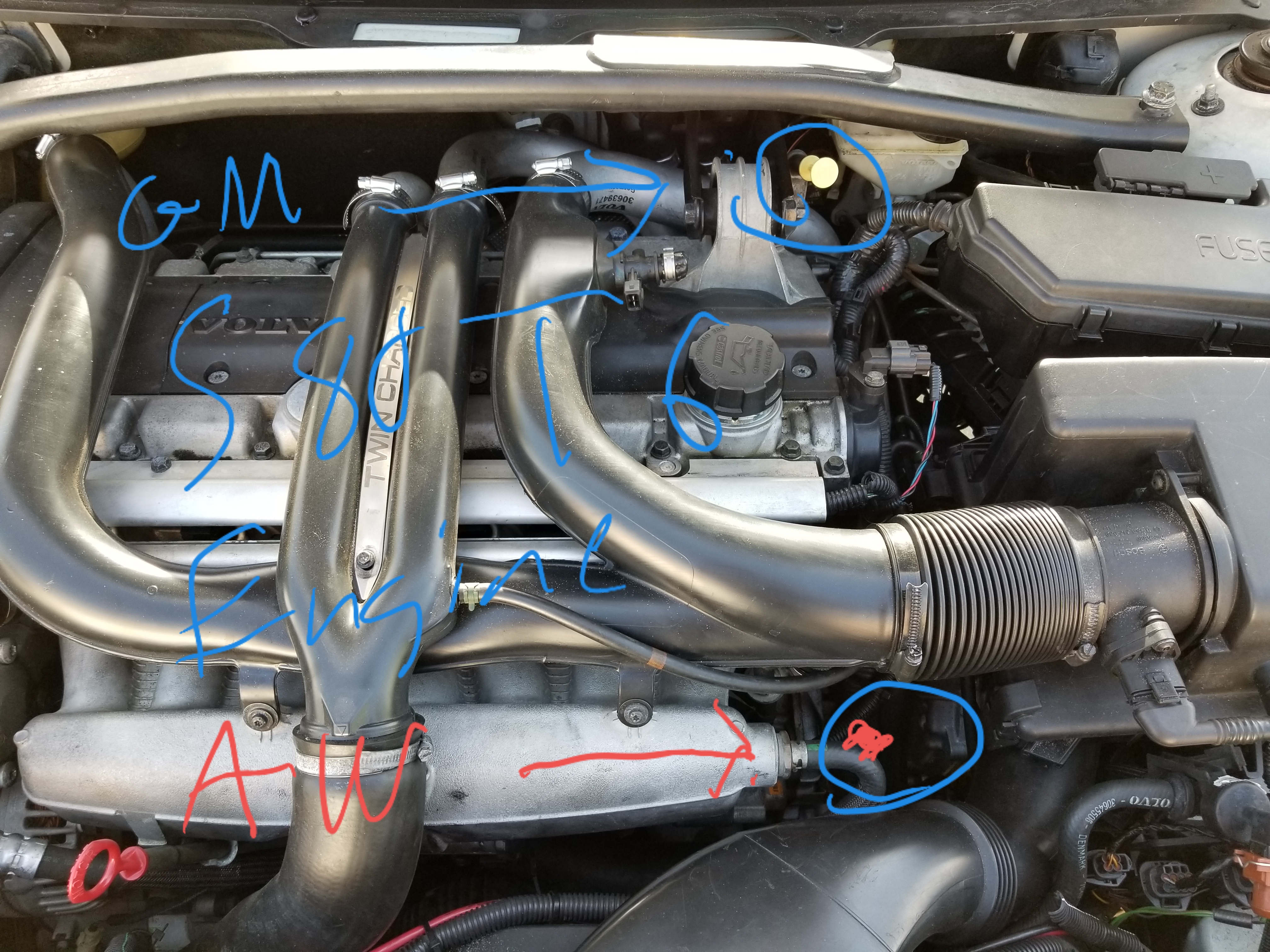

Here are pictures of the dipstick location for GM and I marked where the AW dipstick would be. You can't mix the two locations up. June
