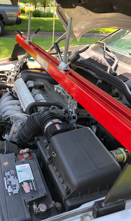

I do not have an s40. But I have dropped the transmission in an s70 (which gives me access to the RMS as well).Mavrick1798 wrote: 26 Jul 2018, 16:09 Thanks for the reply alshnertz, yes I did mean "head" but auto correct is a pain. Doesn't take a detective to figure out what I meant though. I wouldn't be diving into anything either. I know of all the different locations oil is leaking and it seems that the RMS is one of them. I'm going to do a full reseal of the engine while I'm at it for longevity purposes. My question was more specifically aimed towards how to replace the RMS without a cherry picker and shop as I do not have either of those things. You say remove the transmission. Have you done this before and can give any tips or tricks to help things go smoother?
You don't need a cherry picker but you do need SOME way to support the engine. I used an engine support bar.
Like this: As you can see, it rests on the fenders and then uses chain to attach to the engine.
The general process (super high level overview) would be:
1) attach engine support bar and tighten up to remove slack.
2) remove things like drive axles, control arms, tie rod ends from hubs, etc
3) unbolt engine and accessories from subframe (so the engine and trans now are free to move.).
4) use jack to lift engine/trans up a couple of inches. Tighten up the chain again...
5) lower jack so engine and trans now hang freely.
6) attach some sort of support system to transmission (I used straps to the engine support bar and a jack under transmission)
7) disconnect transmission from engine
9. you now have access to RMS.
I did this in a driveway only with jack stands and that engine support bar. This was on a manual and I was only harvesting the transmission from a donor car so I didn't put everything back together.
You definitely do not need a cherry picker but you absolutely do need a safe way to support the engine from overhead, good (safe) jack stands, and a good jack (or two).
It's a big job. no doubt about that.
The reason I gave you a high level overview and not exact steps is I have an s70 and not an s40. The process would be similar but not exactly the same.
Btw. as noted... when I did this, it was a donor car so I didn't have to rush things. It's not a quick job. Especially the first time you do something like this. I bet I could do it in 1/10th the time now.
