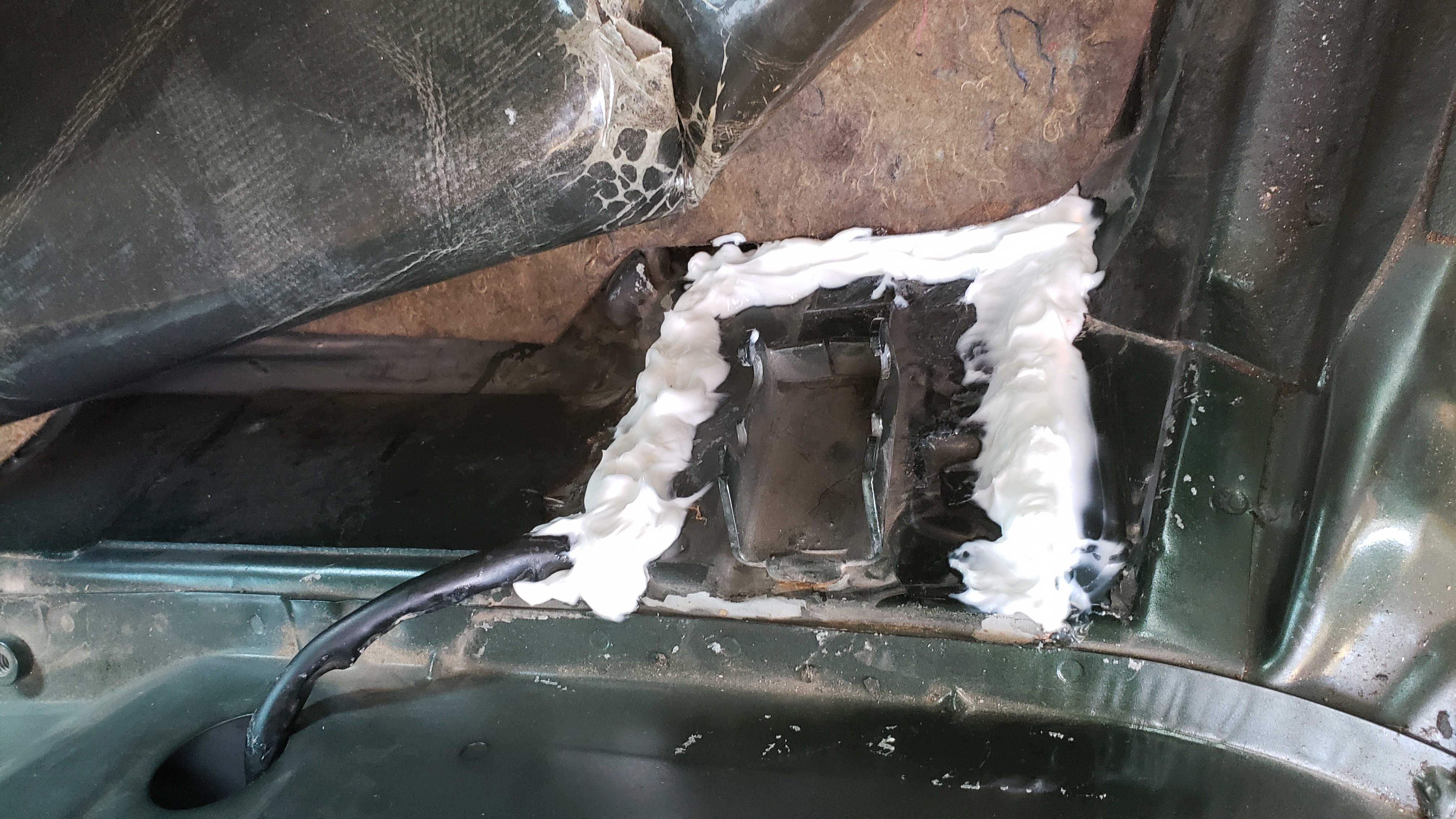

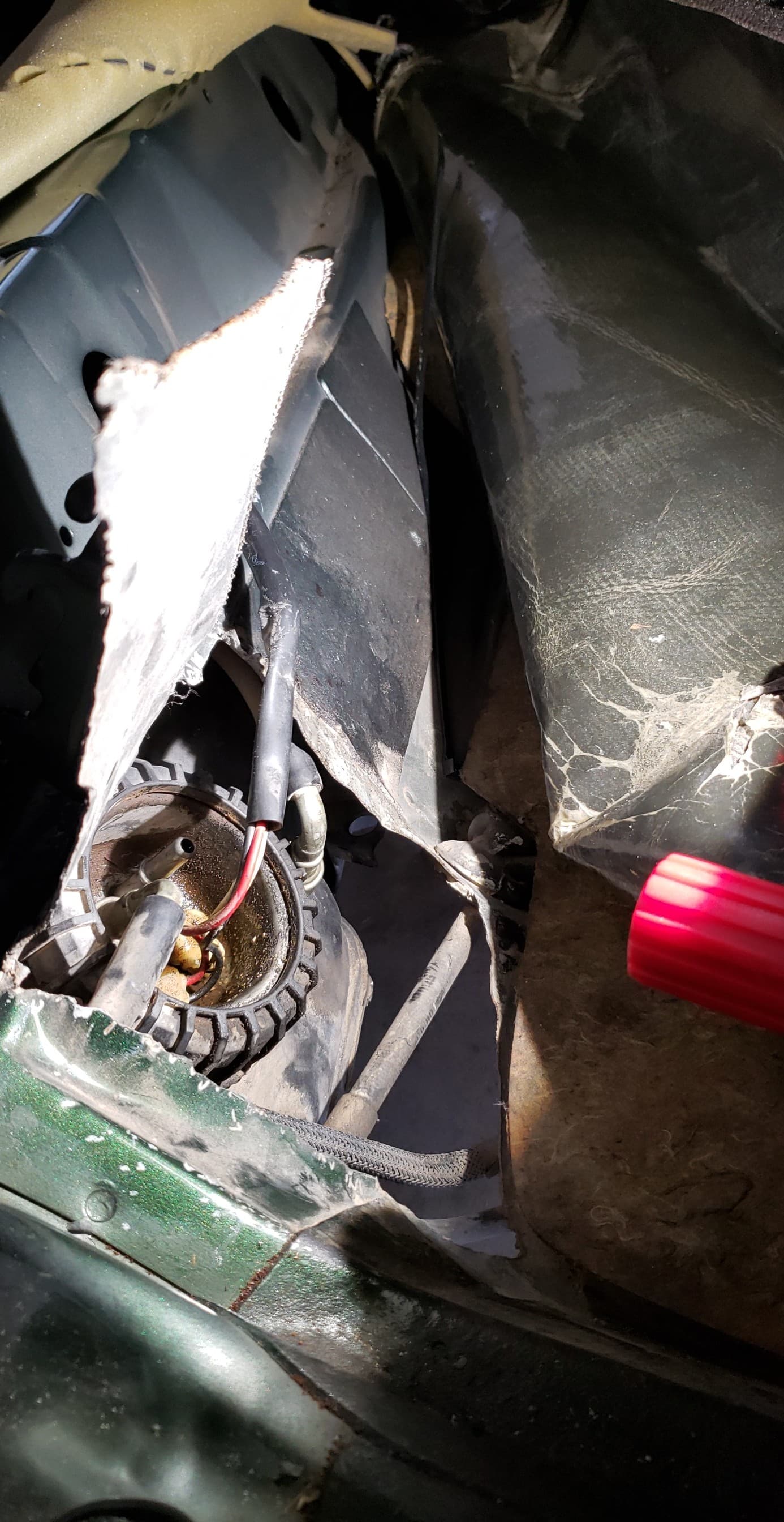

I totally forgot to take some good pics for you. I did snap a couple as I was blabbing about it with some other Volvoheads.
This may help to give you a bit of an idea where to cut. You can see some other lines are just on the other side of the panel, so it's important to only cut through the metal and not past it, if you get what I'm saying.
It's crude... but it works.

I've had to change two of them. Through the floor is the way to go. We have a writeup in the repair database that shows exactly where to cut and it goes pretty quickly with a Dremel cutoff wheel. I cut mine so that the top was left intact, I figured it would be a bit stronger for the seat mount. Be careful not to cut deep beyond the metal itself since there are lines directly behind the are you are cutting in.
For the repair I cut some sheet metal and pop riveted it in on the back side of the remaining chassis sides leaving it extending into the cut area. When I folded the access part that I cut back down I pop riveted it to the new sheet metal that I added. To seal it up waterproof I used some butyl tape that I had left over from installing ground kits on some broadcast coax. You can get butyl tape at electrical supply houses or I think you can even get it at the big box home centers.
