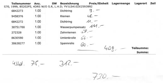

Hi there
I just got myself a quote on a TB and serpentine belt change some time ago. They listet every part on there - it's in german, but the partnumbers are on it as well(the first number), so if that helps you:

Hey guys, thanks millions for all the great advice! This will all get printed out and stuck to the clip board with the rest of my notes.
Ozark - that part info was perfect. I know what I am looking for exactly now so that makes me feel alot better. My serial No. is 192686 and it's a 95 850Turbo Sedan.
Hausmaster... thank you for the quote info, I'll try to decifer what I can as a cross-reference.
