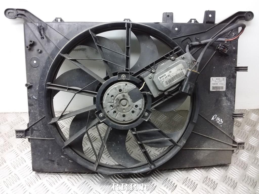

How does the fan unit looks? Does it have a 10x5cm square metal box on it? That's the controller, maybe hot wire it and attach a switch

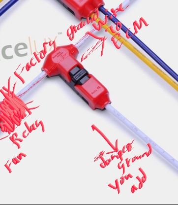

To cause the fan to continuous run with the engine on and stop with the engine off you attach a jumper wire to the relay ground for the high speed and the fan will then always run in the high speed. It is safer than running a switch and bypassing the factory wiring. June

Hi, not sure if '02 having a fan relay? just the controller (under correction here)June wrote: 06 Nov 2018, 11:13 To cause the fan to continuous run with the engine on and stop with the engine off you attach a jumper wire to the relay ground for the high speed and the fan will then always run in the high speed. It is safer than running a switch and bypassing the factory wiring. June
regards
Jan

There is not a switch and wire solution for the controller that is signalled by a PWM control signal. If you added a relay by splicing into the wires between controller and the fan motor you might kill the controller.
