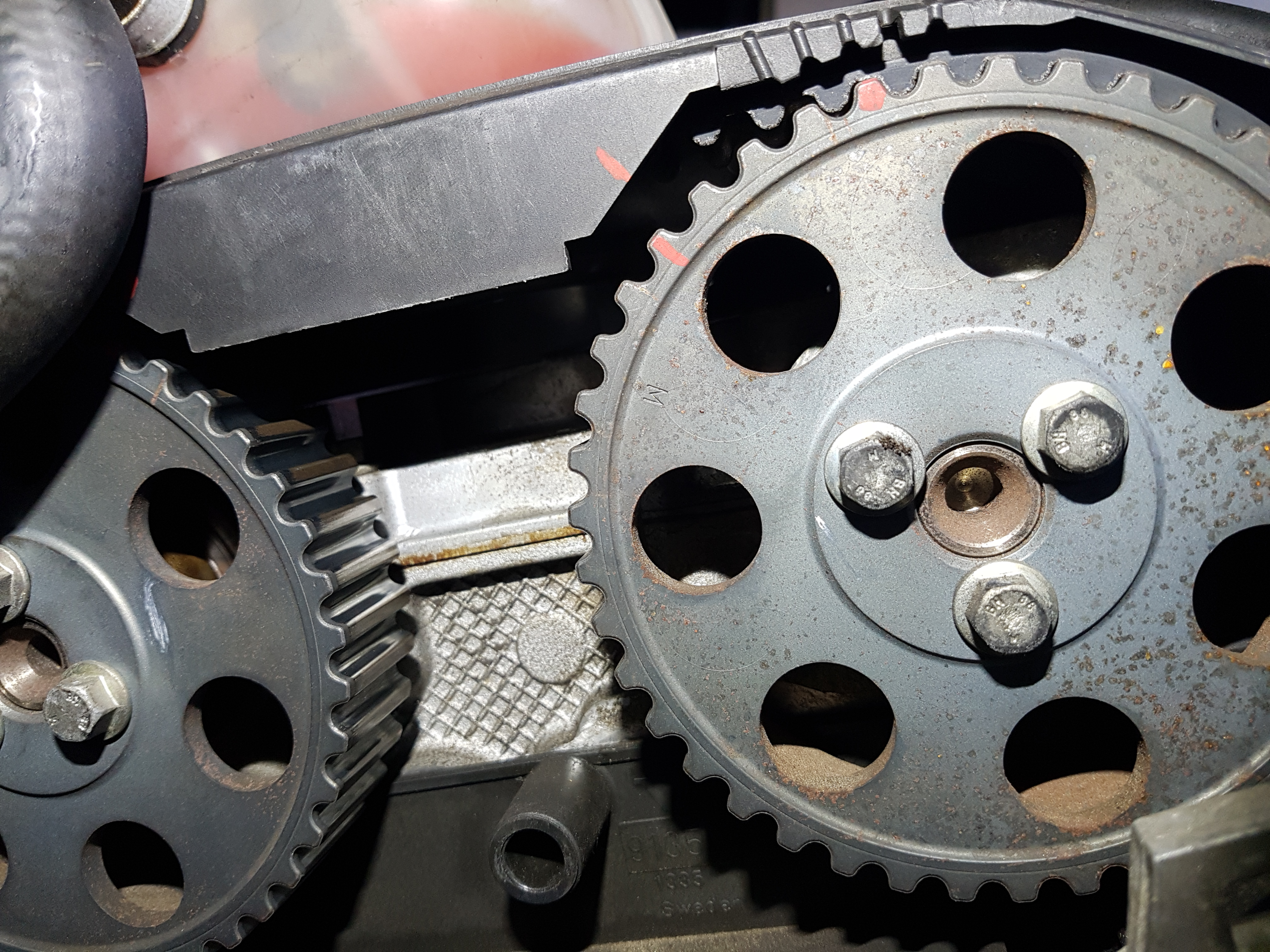

Now that I am about to tackle the job. I aligned the crank on it´s mark and the exhaust valve looks to be quite right but the intake looks off by about a tooth.
The red marks align, but they might have been from a previous TB job done wrong, I just mistook them for the red factory marks when replacing the TB this summer.
Should I try to set the exhaust one tooth back or is this what it should be?

Allign exhaust and intake with grooves on a plastic cover.
From the picture it looks that both are a bit off....but it could be a bad angle the picture was taken.
Intake a little back and exhaust a bit more back....check the crank..put the belt...re-check.

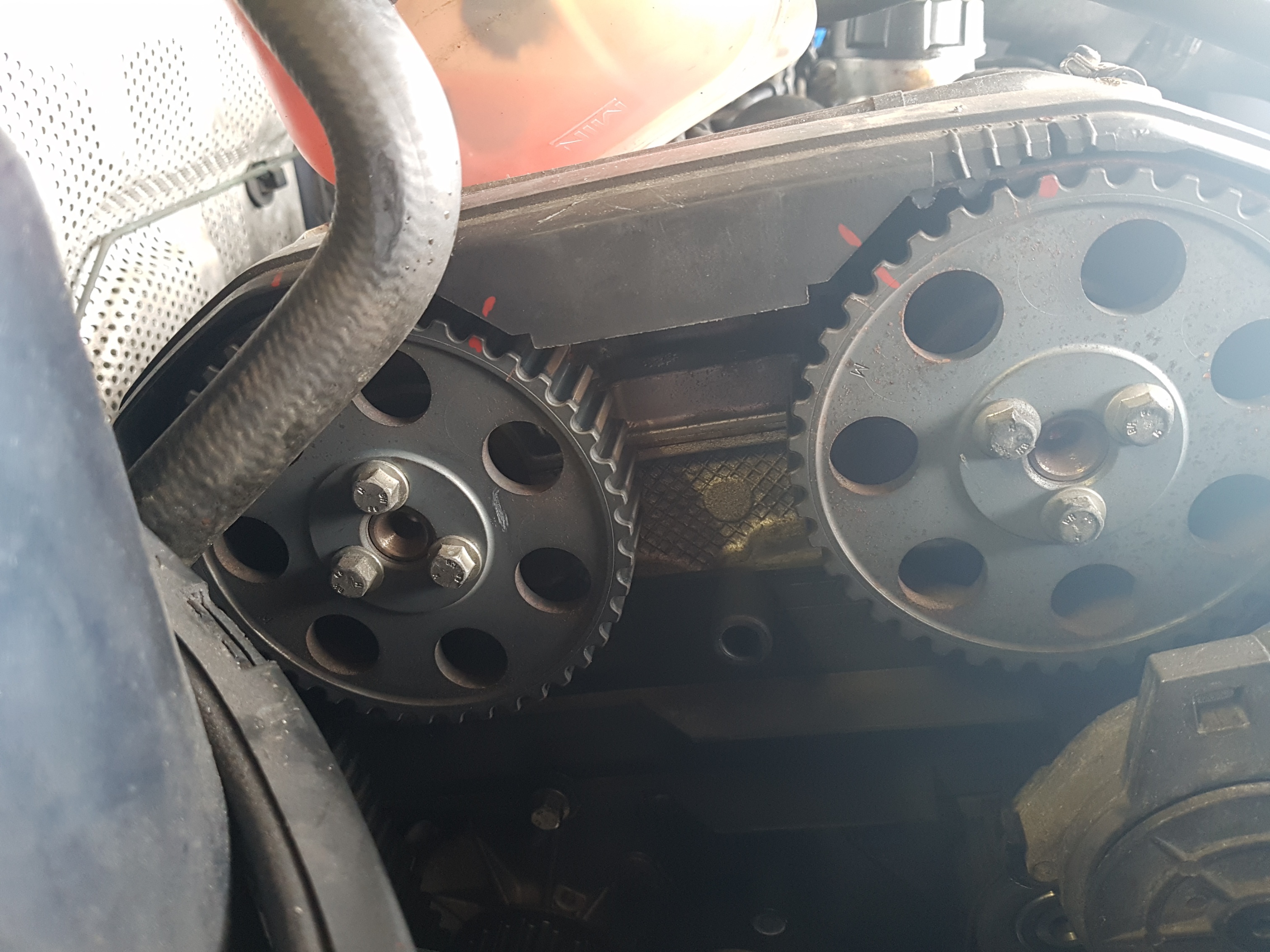

I aligned the crankpulley again with my worklight and took another photo. This actually looks quite right to me.
So off to another round of guessing what causes the car to buck, because the timng belt can be crossed off the list, I´d say.

Looks spot on.
I have had two of them that were a full tooth off on both intake and exhaust when I went to do the first timing belt change after I bought them. It isn't as uncommon as you might think. The cars ran OK even with the timing off but ran better with it correct.
