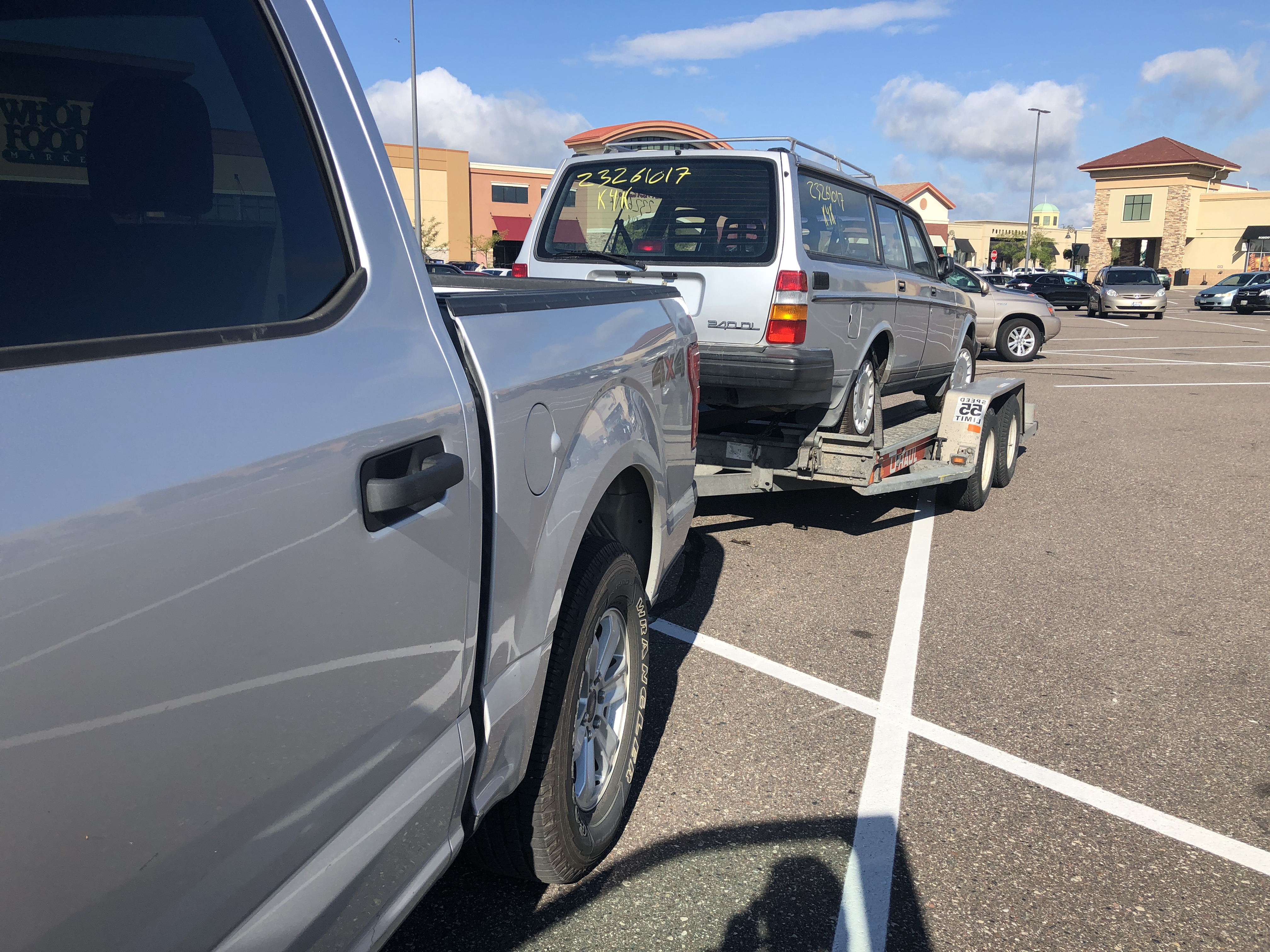

I got an '89 Volvo 240 DL wagon back in September that had been donated to charity and went to auction. I towed it back home, not knowing much of anything about what I had purchased.
I had an auto shop go over it and they've found some repairs that need to be made, and one is very urgent.
He's trying to source the parts but doesn't know what he's seeing online. He doesn't see a 240 DL model that's listed, but rather a 244. Is this the same parts?

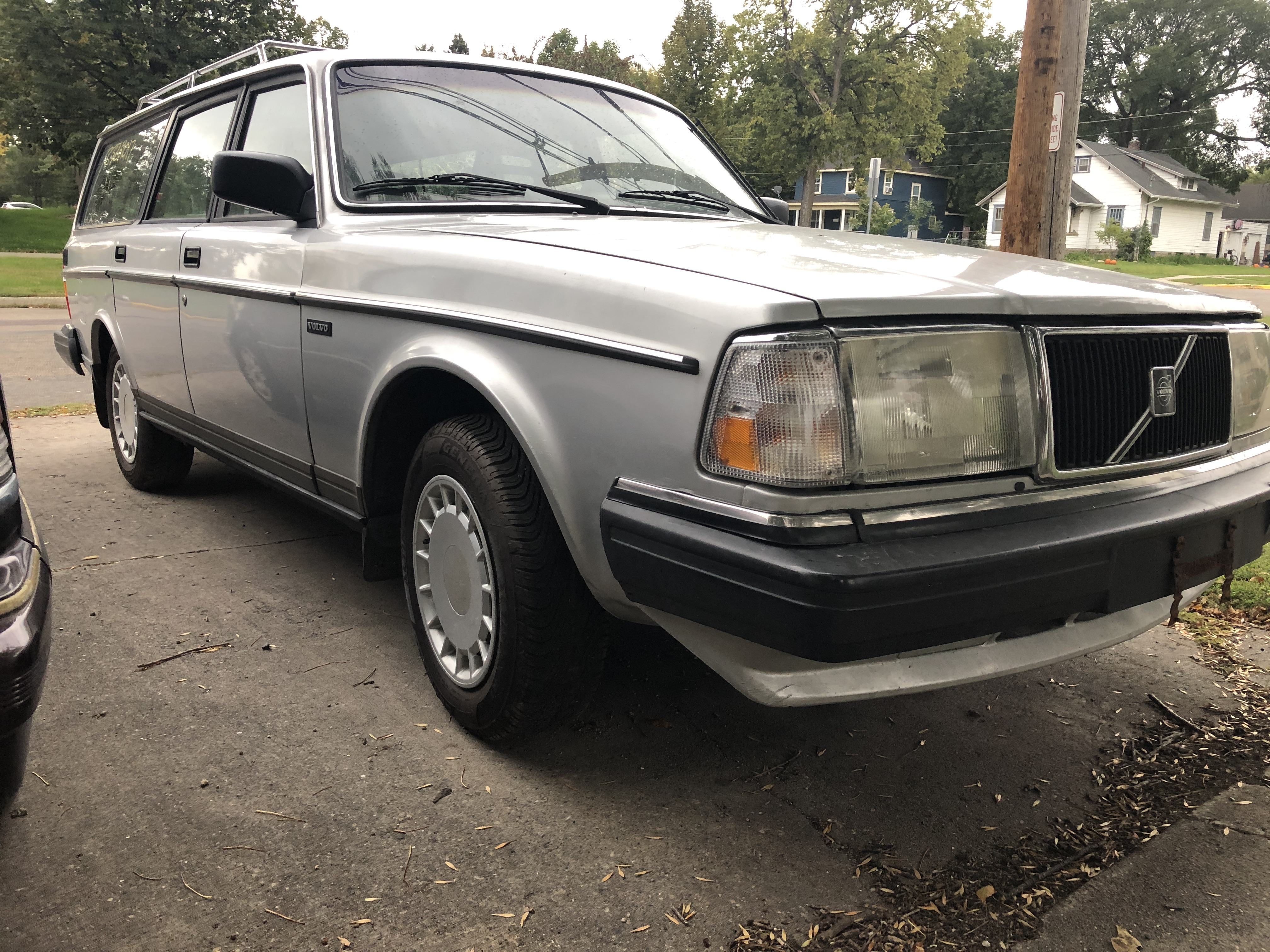

Thank you so much! It seems this car was called the 244 model most frequently. Was the 244 the more common sedan where the wagon was the 240? Or...?

240 was the series....242, 244, and 245 were models from previous years....in later years, all were called 240s...see rear of your vehicle...240DL.
240 or 245 is typical nomenclature for your vehicle....245 connotes a station wagon.

Not officially.shutterbugpaul wrote: 29 Jan 2019, 20:28 Thank you so much! It seems this car was called the 244 model most frequently.
1975–1979: Format: Trim letter in front followed by 2XY.
Where: 2 = 200 series, X = the number of cylinders, Y = doors.
X = 2 Coups, Y = 4 Sedans, Y= 5 wagons, Exception: 242 are two-door sedans.
1980–1985: trim level letters followed by 2X0, The Y destination was dropped.
Exceptions: A small number of 260s had four cylinders and a 240 could have six cylinder diesel.
1986–1993 Format 2X0 followed by the trim level.
Your car is a 1989 240 DL wagon (de Luxe). You got the title correct.
If it had been a 1975–1979 it would of been a DL 245.
