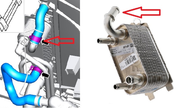

To answer your question, see the red arrow in the picture below
However that is not what I did for either of my 3.2's

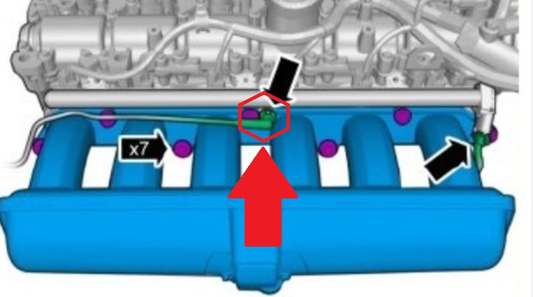

Patrick,
The small hose above the center of the intake manifold is the breather hose for the engine. Any air bubbles will be pushed out this hose into the reservior.
When I filled the coolant (with the small hose shown below removed) I made sure that i kept filling until coolant came out of the location shown and when it did I reconnected the hose.
Hopefully this helps.

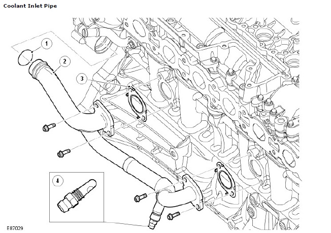

Patrick,
If you crawl under the Engine you might find the following
For my 2008 LR2 - I have the drain
For my 2010 S80 - no drain
I don't know if its just a change that was made from 2008 to 2010 or if this is a difference between Land Rover and Volvo.
The location is the back side of the engine (exhaust side)
inlet pipe drain.jpg (121.52 KiB) Viewed 3601 times
If you do have it and you remove it remember to only tighten it with 5 Ft*Lbs or 7 Nm
Note: For my S80 I only removed the drain at the radiator to get the coolant out
