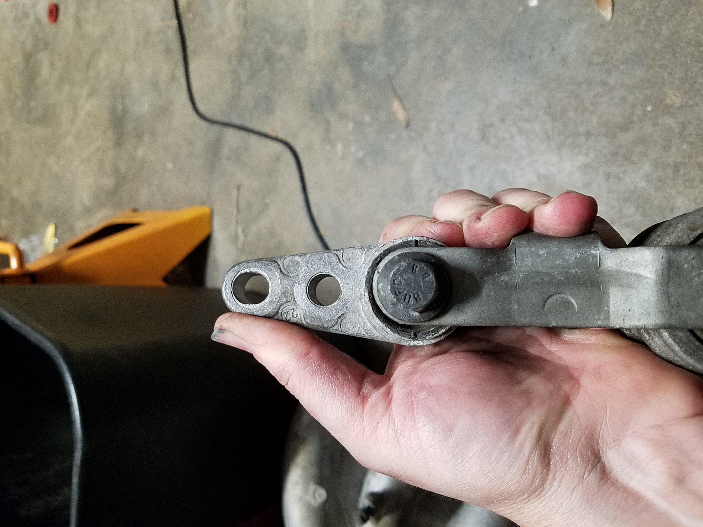

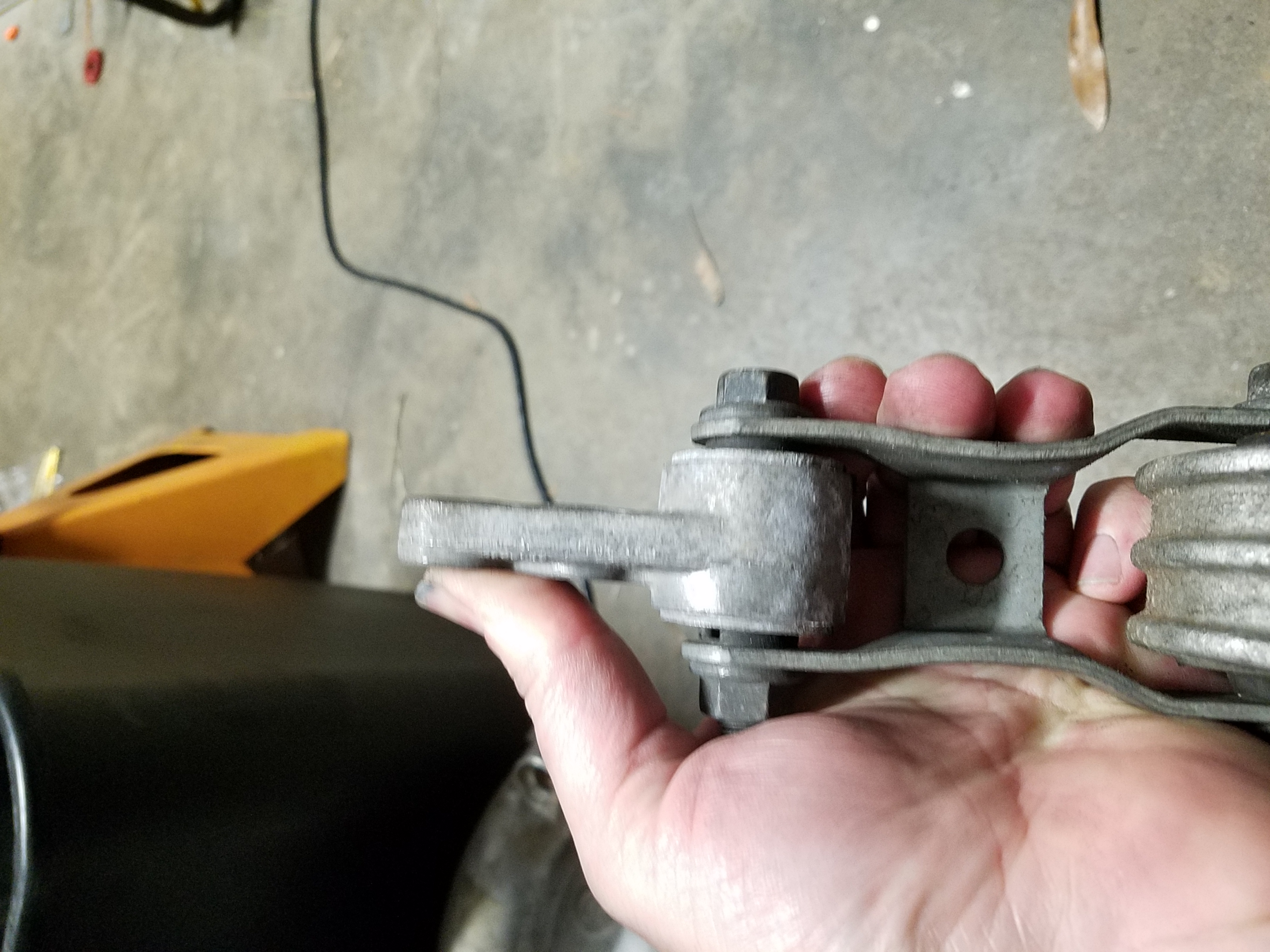

I'm replacing all the motor mounts on my S70 and when I got to the lower torque rod (the dog bone looking one), I realized that the bushing on the new mount was crazy loose. I can easily move it with my finger from left to right. The original Volvo one that I was going to replace is TIGHT, even after all these years. And it's not tight like it's old and hard, there is significantly more bushing material there. Is this normal? I don't see how this mount would even begin to contain any torque with the bushing like it is.
And by the way, it was the Hutchinson OE mount made in France, just like the Volvo one. It even has the ground off Volvo markings.
New one with just finger pressure:

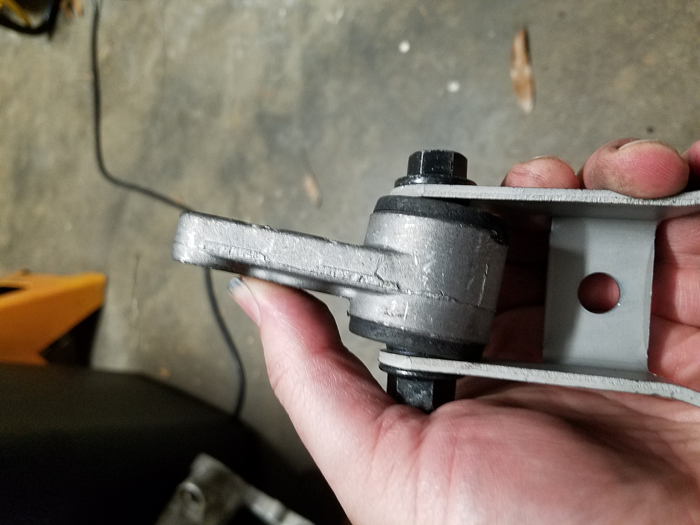

Old one:

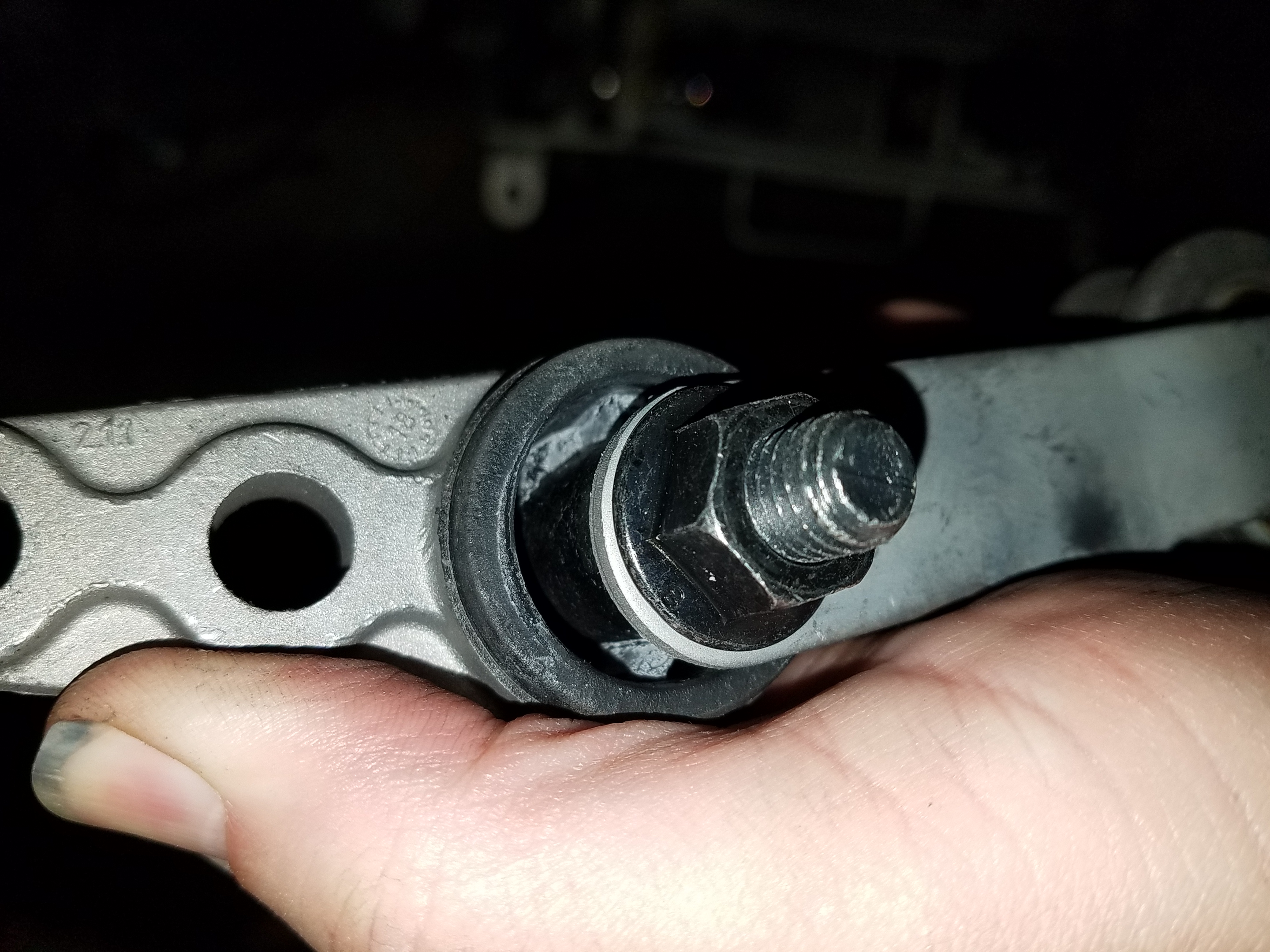

Very little bushing in new one material:

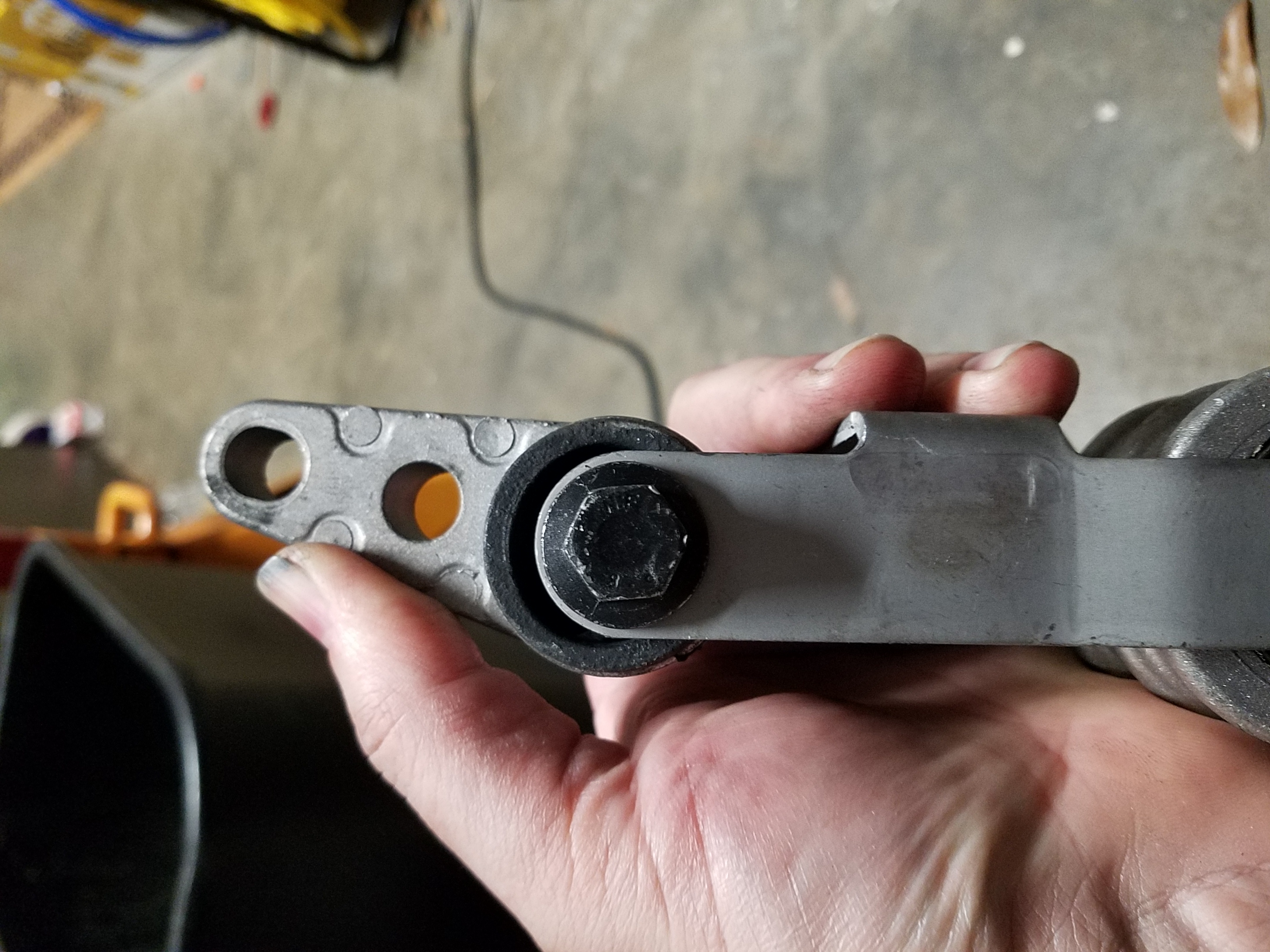

New lower torque rod is WAY too loose...
