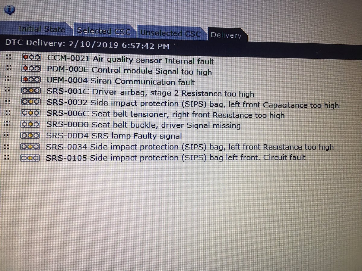

I've got a Big SRS problem. (I'll attach a screenshot of all the codes from VIDA) So, to give a brief history- I bought this car (2002 V70 2.4T) about a year ago. It's my daughter's car and a bit of a father-daughter project. Problem was I discovered it has an SRS problem. In fact, somebody (before we bought it) had covered the light and removed the bulbs for the text message display in the DIM! So I got a VIDA/Dice and checked it. It was an issue with the Driver's side SIPS bag. I tried using a resistor to test the bag, and no change except that it registered a new error about the capacitance of the SIPS bag. I replaced the SIPS bag with a junkyard bag, and again, no change. It also acquired a "no signal from driver's belt buckle" error also. I figured I'd damaged the wire moving the seat around so I replaced that with another junkyard part. I checked the wiring from the SIPS bag to the SRS module and it shows no shorts. I also tried creating an error by disconnecting the right side SIPS and I could not clear that SRS error even after I'd reconnected it. And yes, the CEM is green in the module display in VIDA.
So I sent the module off to be repaired by Airbag Systems Inc in Texas. After I got it back, I still got the same errors!! In fact, now I have some new ones about the driver's airbag and the passenger seat pretensioner. I bought a new SIPS bag and driver's belt buckle from FCP Euro (New OEM Volvo) and get the same errors. I tried clearing it a few times just for kicks, and it cleared ONE time. Unfortunately, after I cycled the car (turn off/turn on again) the codes came back and won't clear again.
So, any suggestions (short of something involving fire)??
My best guess is that the SRS module is still bad; that whatever they did to "repair" it didn't work. Anybody else got ideas or suggestions of a shop I can take it to in Hampton Roads, VA? I've talked to one local mechanic who can't download software, and he tells me I'm doing what he could do. So is this a "bite the bullet" and and take it to Volvo?

In Vida go to Diagnostics-Vehicle Communication-Network. Find the SRS module and click on it.
Make sure it is green and reports to the network. It will show two software part numbers.
Another module from the same model year SHOULD have the same numbers. Get a used one from another car. SRS modules are EXTREMELY reliable. If the sw numbers don't match get a hold of MVS member Sergey or Yagger as he's known here and he can clone the original SRS module. He and his business partner Henry have cloned dozens of used Volvo modules for me and they do a great job.
What I'm saying is that the initial check done by that company may not have been accurate.

Everyone- Yagger suggested I find another module, since the 2001 had also been "repaired" by the same company that failed to repair my original. I ordered one online since none of the local yards had one, and with a little code clearing, the SRS system was finally up and running!!!
Thanks, everyone!! For $38, I have a state-inspected, legally driveable Volvo!!!
