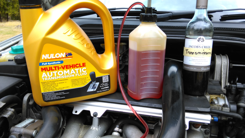

Now, getting back to the ATF I bought on Mike's advice. today I did the well talked about drain and fill.
Drained the amount that came from the transmission sump and flushed out a little more with clean fluid down the filler tube.
Then, plug back in and re-filled 2700ml, just short of the required 3600ml as would be normal. The transmission was still a tad too high before, so my calculations suggest 2700ml, which seemed to put it spot on while cold and checked again at warm. Next will the hot check.
Some photos:
First photo setup, followed by a sample on paper towel of the new ATF against the old fluid. Quite a different colour.
The last is the filling of the new ATF using Nulon ATF with a sample of colour differences between what came out to what was going in.
The old stuff certainly appears to be okay, not quite cherry red, but also, not too brown, and the smell was okay from what I could tell.

That Titan 4400 iin the wine bottle's too black in my opinion after 14,000kms. I would definitely be doing that 2nd drain and fill in a week.
