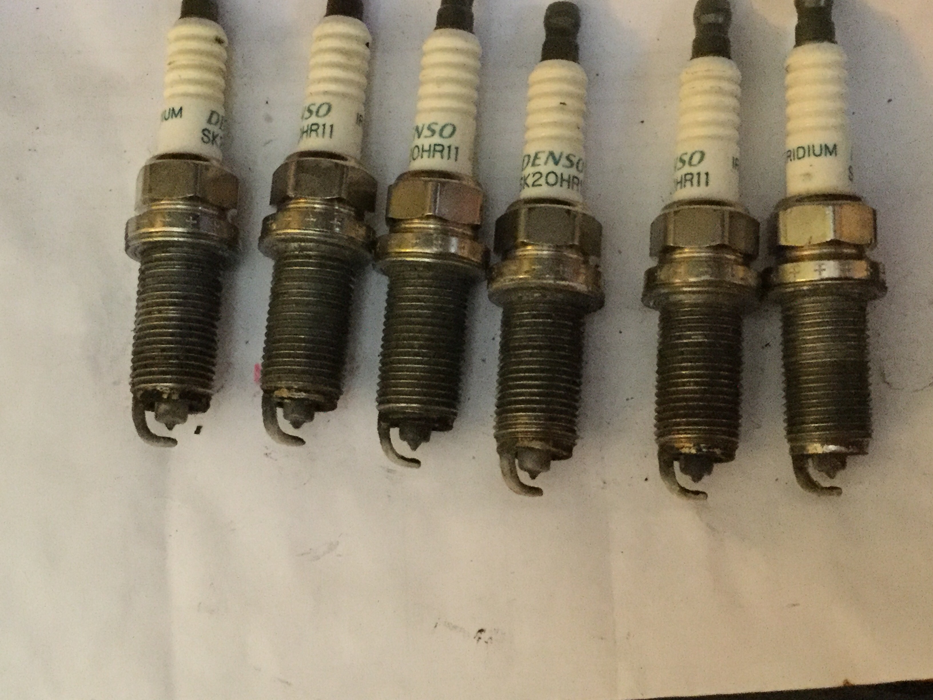

pgill
Posts: 813
Joined: 27 Aug 2018, 17:42
Year and Model: 2010 S80, 2008 LR2
Location: California
Has thanked: 120 times
Been thanked: 189 times
Post by pgill »
A picture of the spark plugs for my S80 at about 123,000 miles
I replaced these right away when I bought my S80 (used)

pgill wrote: 14 Apr 2019, 17:19 A picture of the spark plugs for my S80 at about 123,000 miles
I replaced the plugs already, they were all pretty much done, and I mean DONE!
