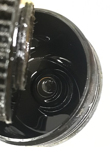

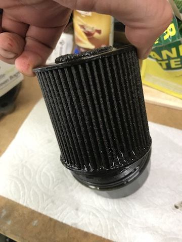

- Also attached pic of oil filter.
The only thing I have done so far is to do an oil/filter change. The oil was dirty, and ready to be changed but not to any extreme. I have not really driven it since then. I was hoping to get some advice first.
