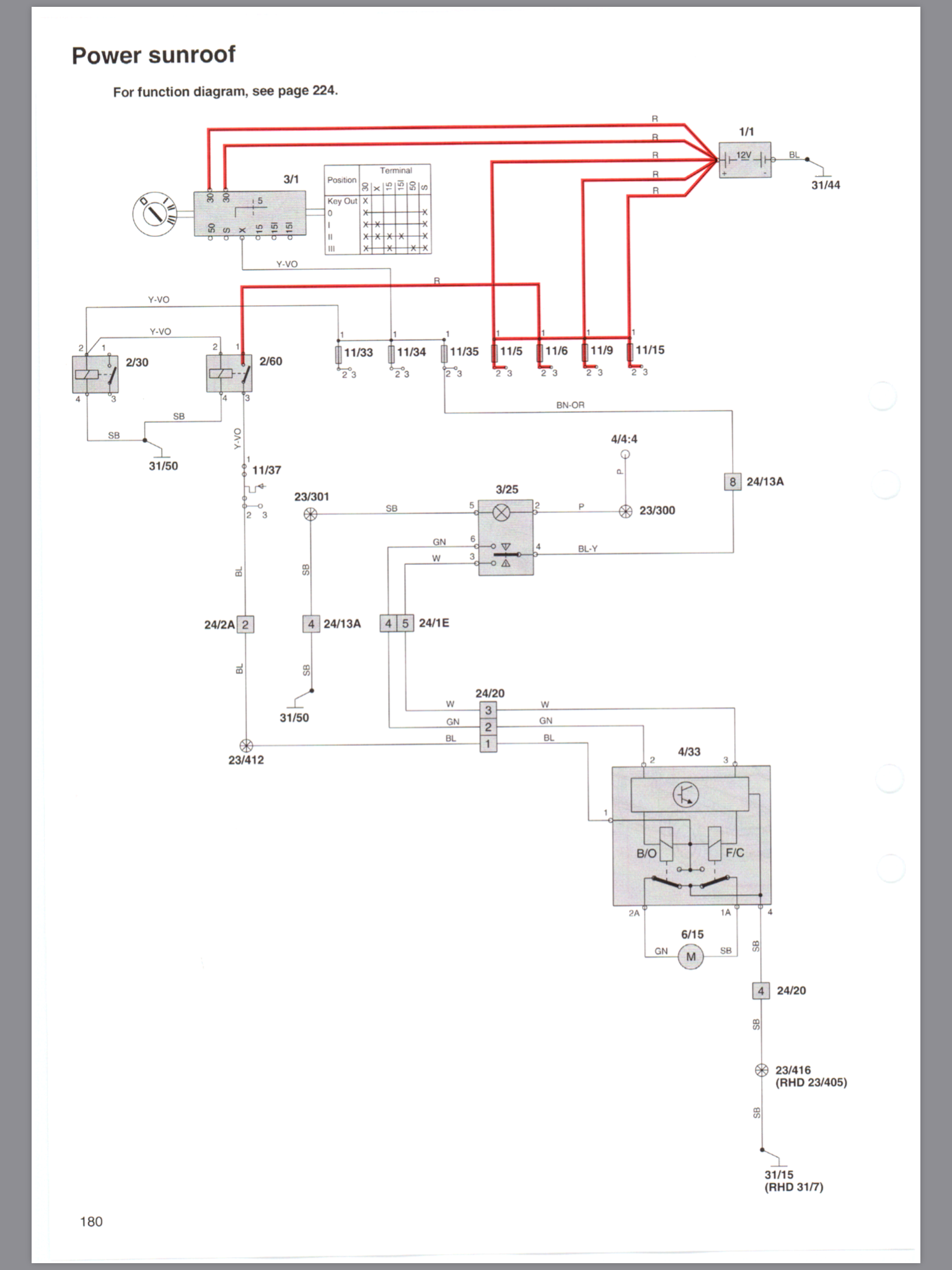

There are two points of protection for the sunroof.
The “control” fuse in location 35 that also supplies
dash and ashtray illumination and one of the leads
on the accessory connector. Do your dash lights work?
Is anything connected to the accessory connector under
the dash, next to the steering column. If you have a hinky
stereo installation, anything’s possible.
There’s also a silver circuit breaker in location 37.
It’s a thermal circuit breaker that auto resets and
handles the big motor load power for your sunroof.
It hides under the fuse box cover and also provides
power to your windows. Since at least some of your
windows work, it’s probably passing power.
Another link in the chain on the way to that breaker is
accessory overload relay 2/60. These PDFs should help.
