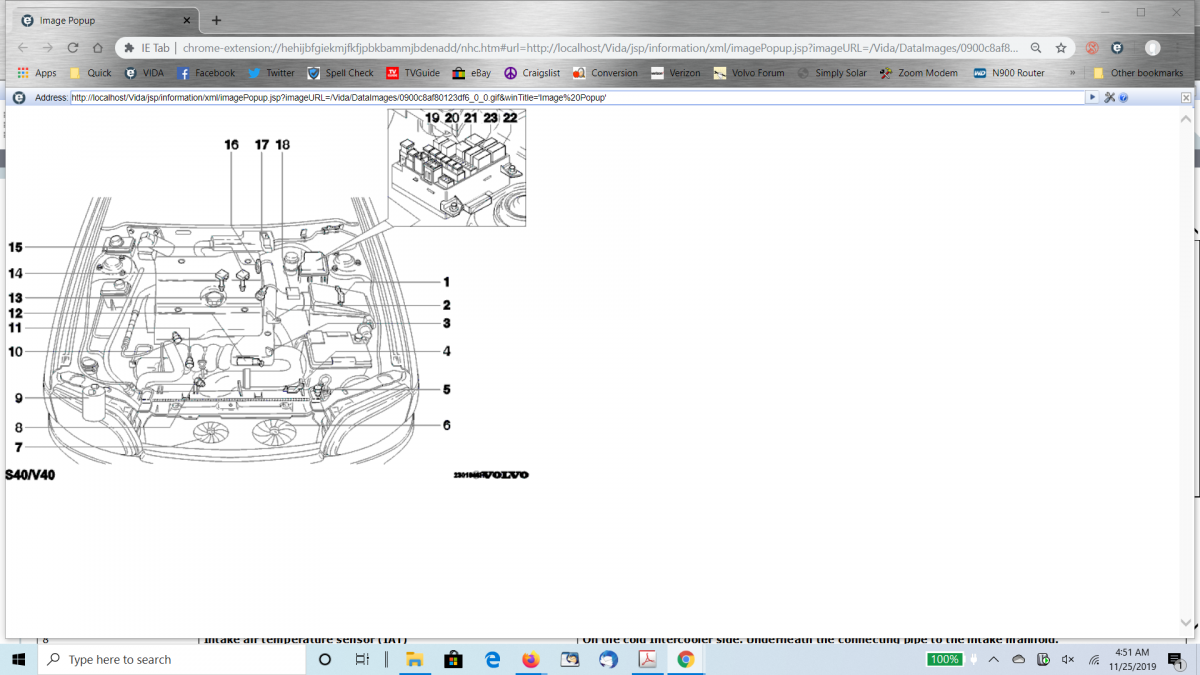

Both of them codes are the System relay or the wiring to the System relay.
There are two versions of both codes, Too high and Too Low (Shorts and Opens.)
1. Check and clean the System relay socket.
2. Get a spare relay and try swapping the relay.
3. Check the wiring to the System relay for shorts and opens.
#21 is the System relay.

RickHaleParker wrote: 25 Nov 2019, 03:57 Both of them codes are the System relay or the wiring to the System relay.
Thank you for the reply, RickHaleParker.
I swapped the relay with #20 from the picture (fan relay I think, it is the same as the system one) and no changes there.
