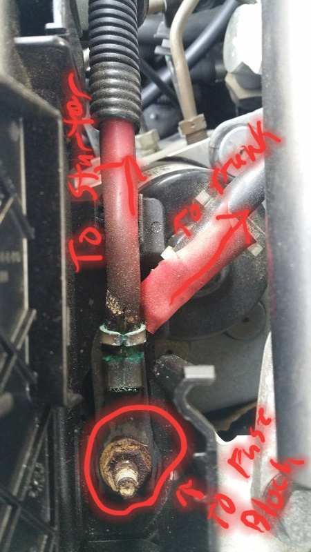

Check the positive connection under the hood. Had the starter cable go bad and fry the fuse panel it's connected to in my 2004 S80 T6. The car suddenly died while running normally and would not restart like the battery suddenly died. June

As June suggests, checking your cables is a good idea - also power related.
