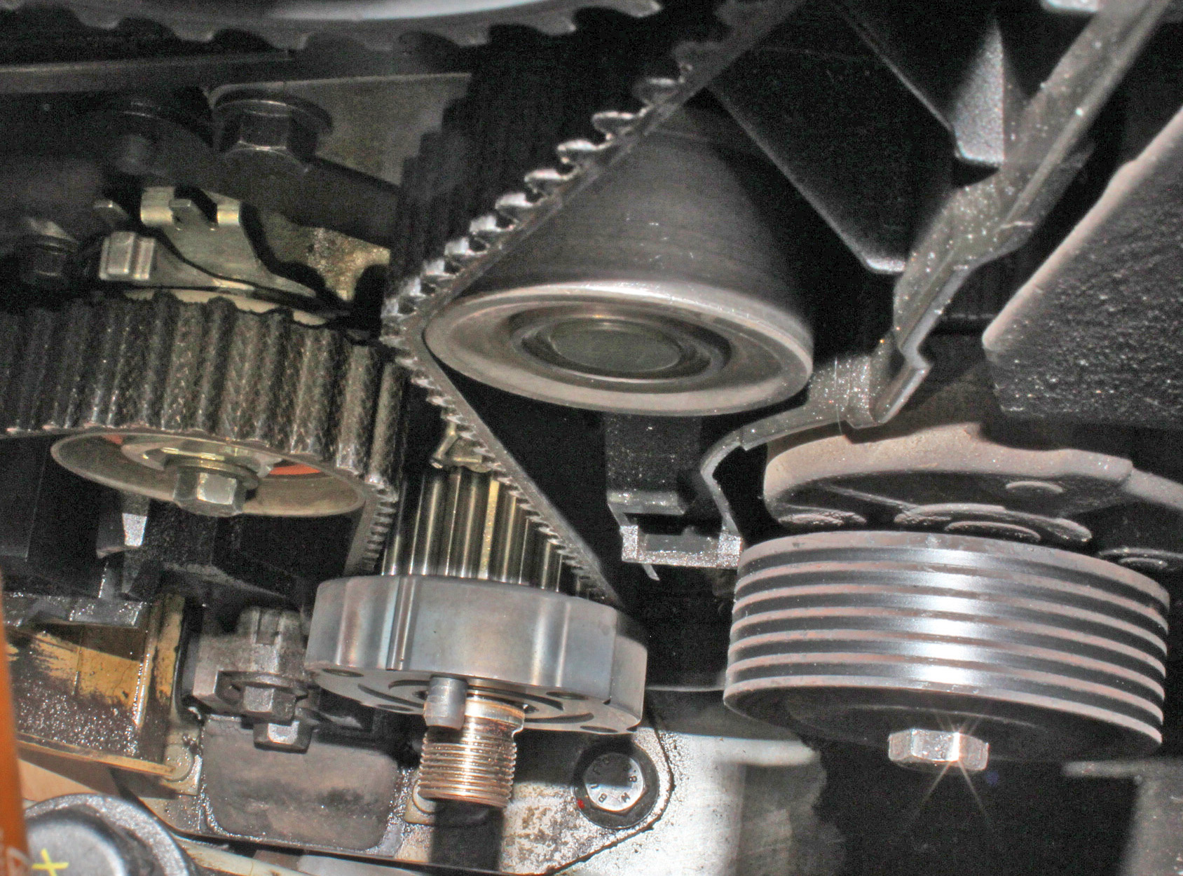

oragex's video instruction is right, you needn't remove the crank pulley. The plastic shield (the small one at the 3 to 6 o'clock position) comes off and there's one pin at the 6 o'clock position which the belt needs to be worked under.

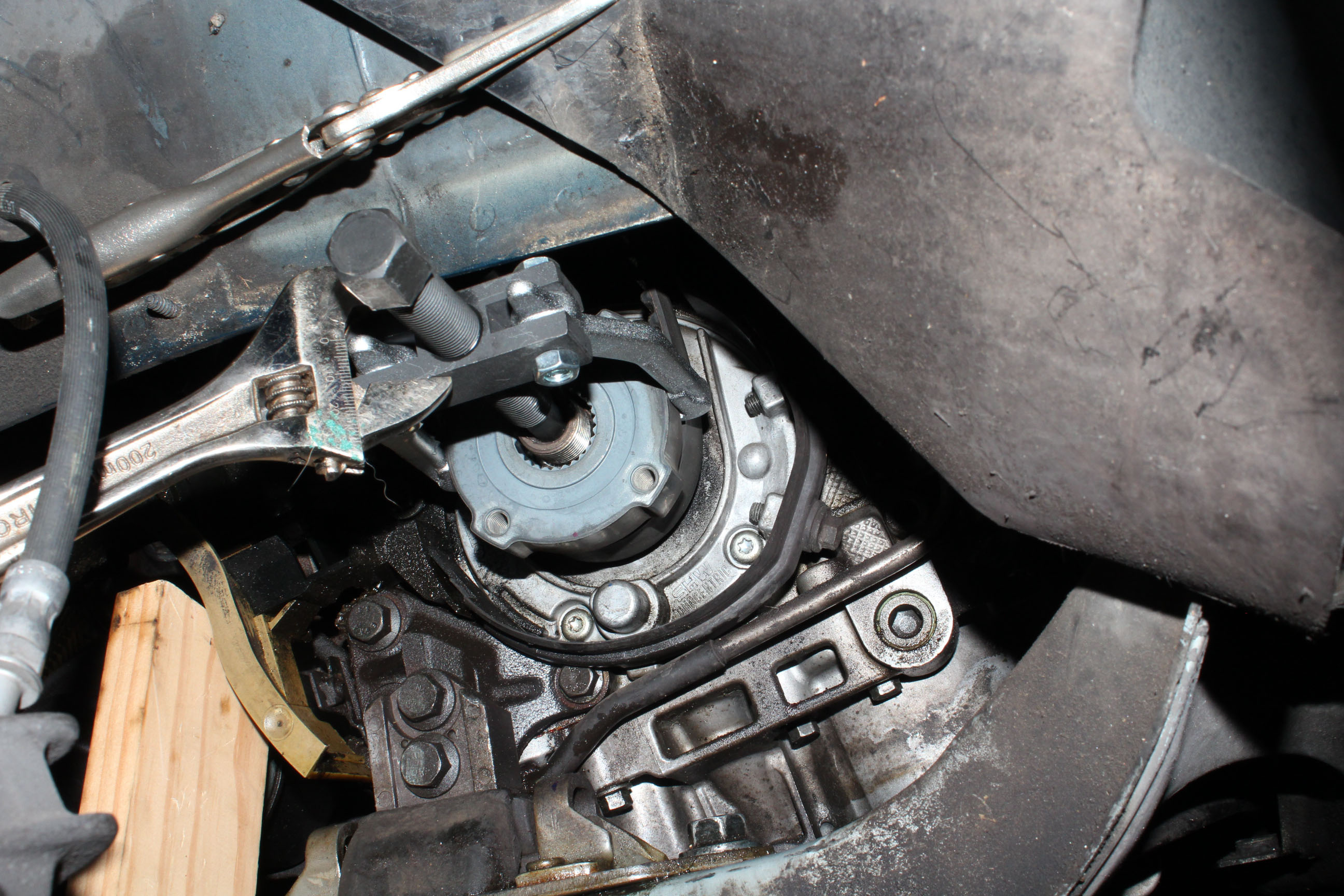

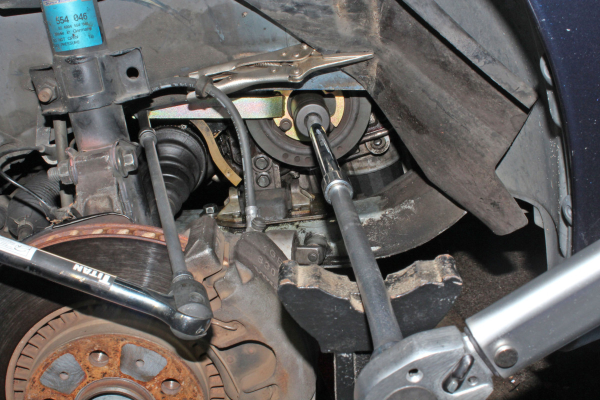

One thing I've learned when dealing with the crank pulley nuts, which as mentioned does not need to be removed to replace the timing belt, is to always buy the special crank hold tool even though they tend to be expensive and a low use specialty item. There's just too many other problems (costly too) that can result by not using the hold tool. Those crank bolts are on tight and so much force is required to break them a good holding tool is a must and you need it to torque it back on correctly.
I attached some pictures with the crank pulley removed so you can see the areas that get in the way when installing a new belt with the pulley on. The videos shows how to turn the belt on edge to get past the protruding areas that limit clearance.

No need to remove the Crank Pulley for TB job.
Just slide the new TB around the little knob on the oil pump. This has been discussed in forum many times.
