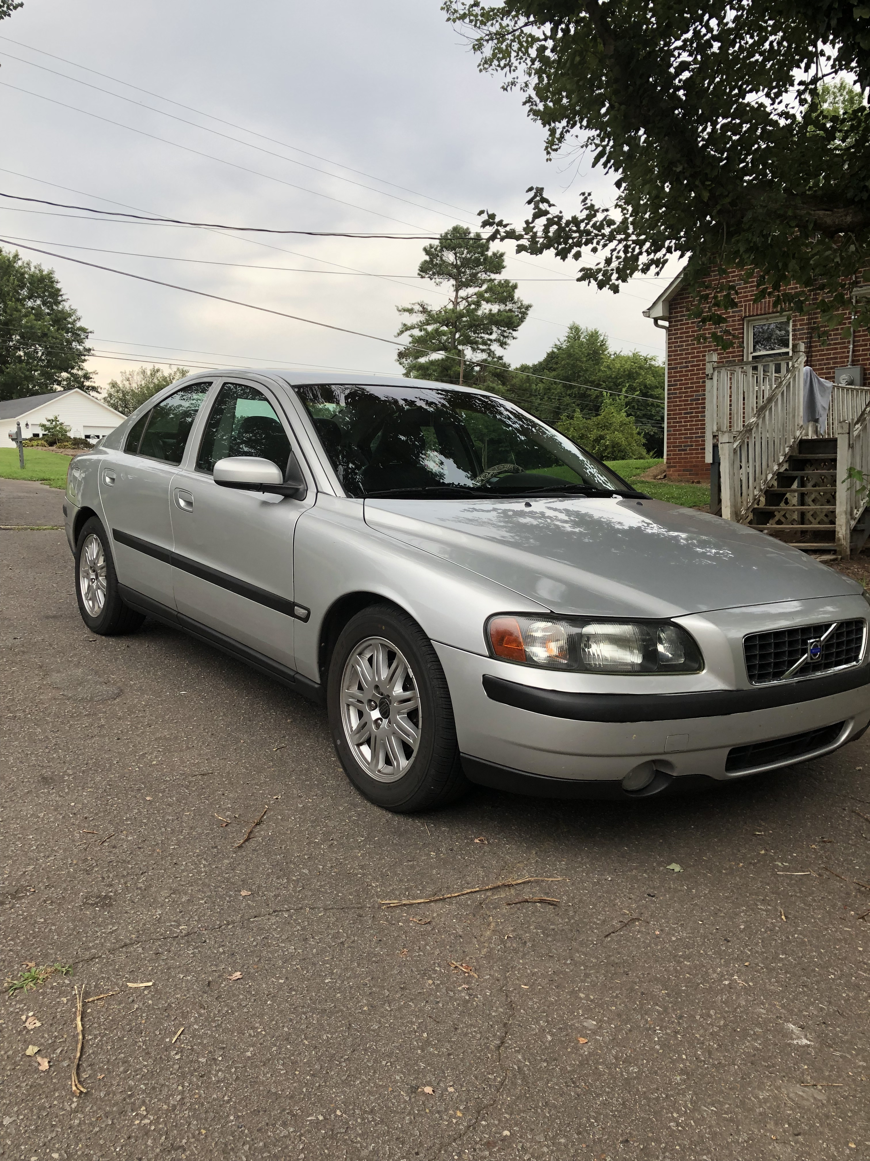

Hope everyone is having a great Monday. New member as of this morning! I’ve recently obtained my wife’s ‘04 S60 2.5t FWD after buying her an ‘18 V60 a few months ago. I’ve now been given the green light to do whatever I please with it! Nothing major for now but I’ve came across a salvaged ‘09 S60. I know it is still based on the P2 platform but was curious how interchangeable the parts can be. Mainly needing the rear bumper and could always have the seats as back up if it’d work. Forgive me for the possible “dumb” questions but I’ve realized previous expertise and enthusiasts are better than google.
Thanks in advance!

The refresh is in 05, so the difference should be afaik
-headlights
-throttle body (check if it's bosch/ non bosch is terrible)
-radio/ac assembly
-steering fluid reservoir
-control arms and ball joint
-abs computer
-fuel pump
-front bumper
-side mirror housing
-headlights
-radio/ac assembly
-abs computer
-fuel pump
-front bumper

Most body parts are interchangeable. The electronics however are not between that 09, and 04. The seats, you'll have to swap the skins. The heater connections are the same, but the airbag is different, so it will throw an SRS code just direct swapping the seats.
But rear bumper, will swap, easy enough, and you can put a body kit on the newer bumper for $100
The older ones were one piece. Side skirts will fit all years as well.
