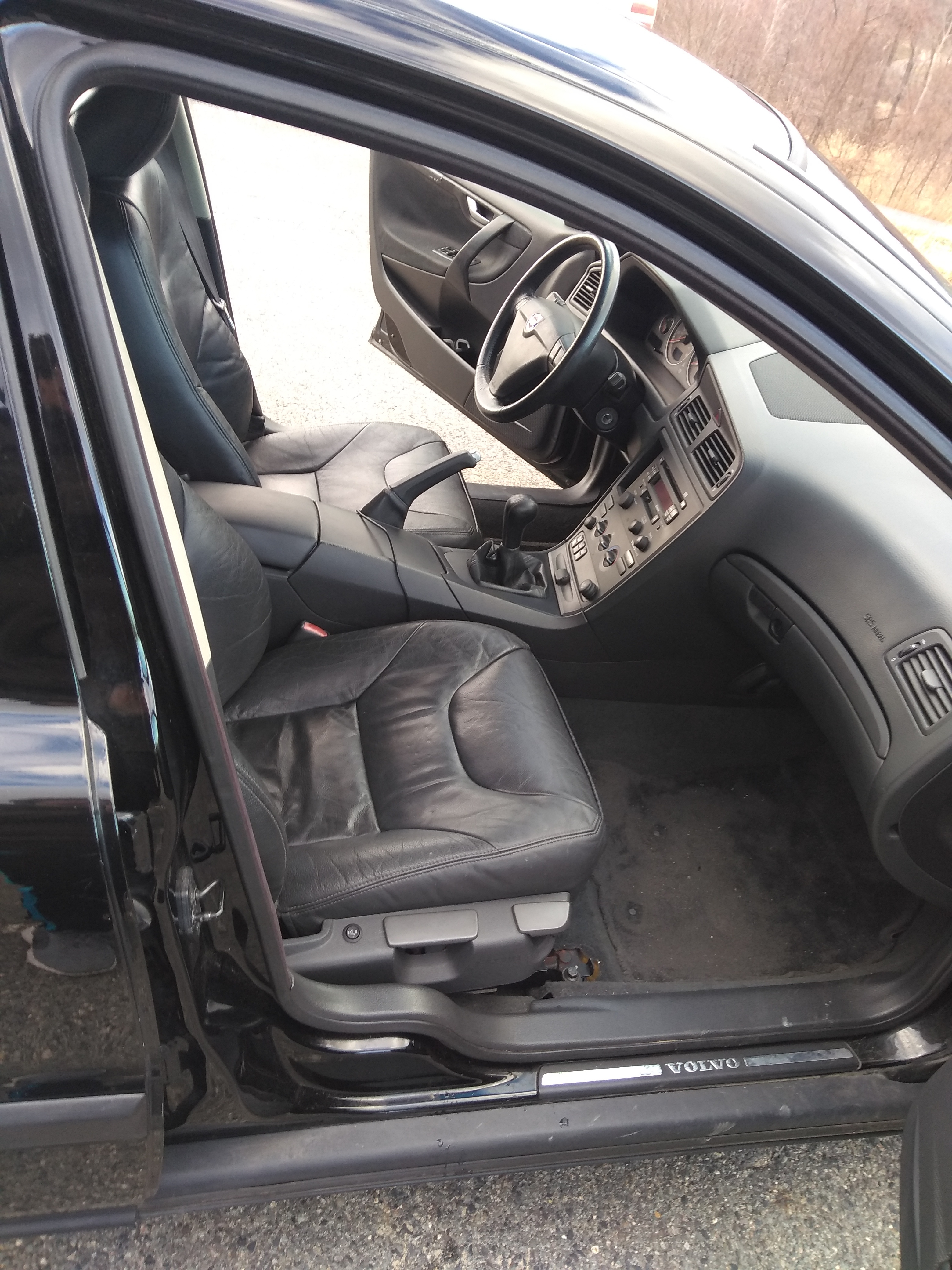

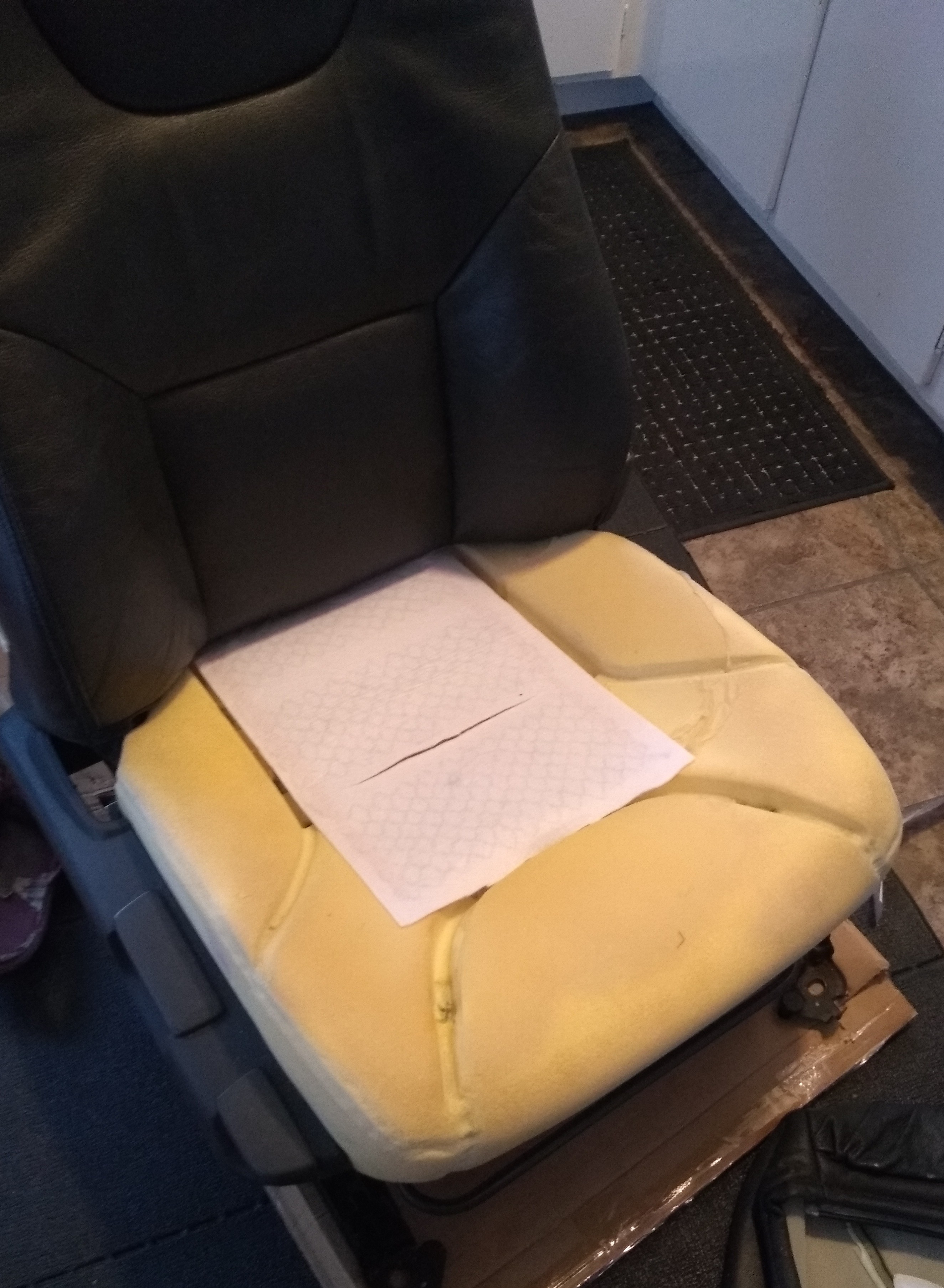

You could also go the aftermarket route. You can pick up a kit for under $50, full wiring, relay with switch and the elements. My car unfortunately didn't come pre-wired (nor with a sunroof!!), And the without the automated CCM, so I ended up buying some water carbon elements and drillled the switch. They heated up pretty fast. Granted, the element looks smaller than the OEM one, but I still felt it toasty after about two minutes. It also has a resistor to prevent overheating.
I drew power from the 12V plugs. If you go that route, I recommend doing the driver's side on the rear 12V plug since it gets used less. I tested with phone chargers and it still works fine.
I was initially skeptical of the non factory look but in the end it all looked fine. Note, the switch is on the seat

That looks really neat, there should be 12v under your manual seat, its pre wired for electric seats all you need to do is put a fuse in and label it 'seat heating'
