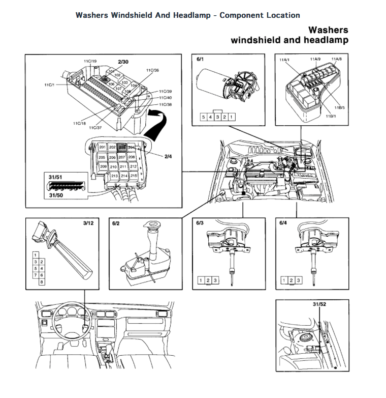

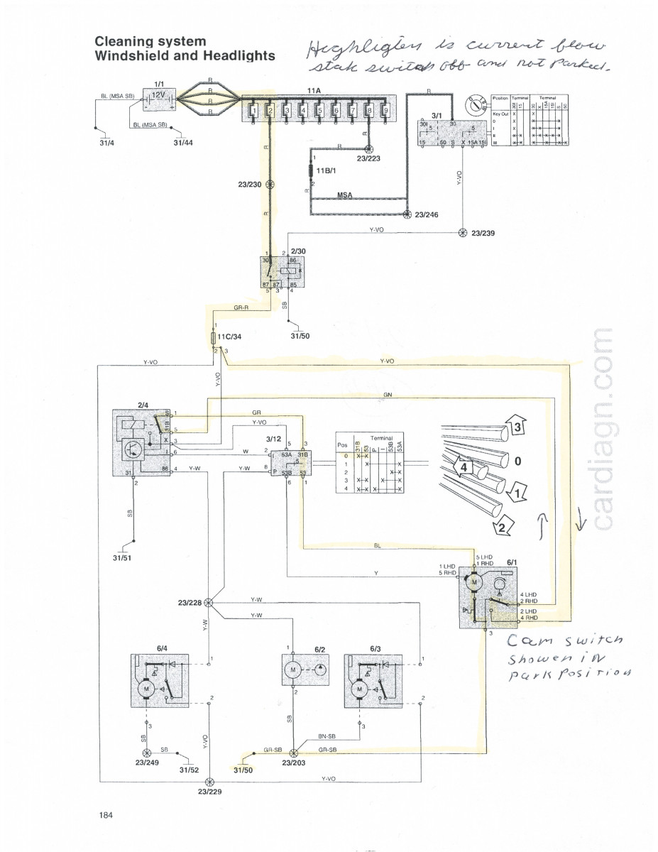

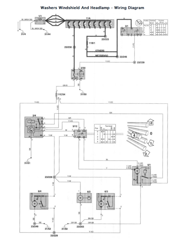

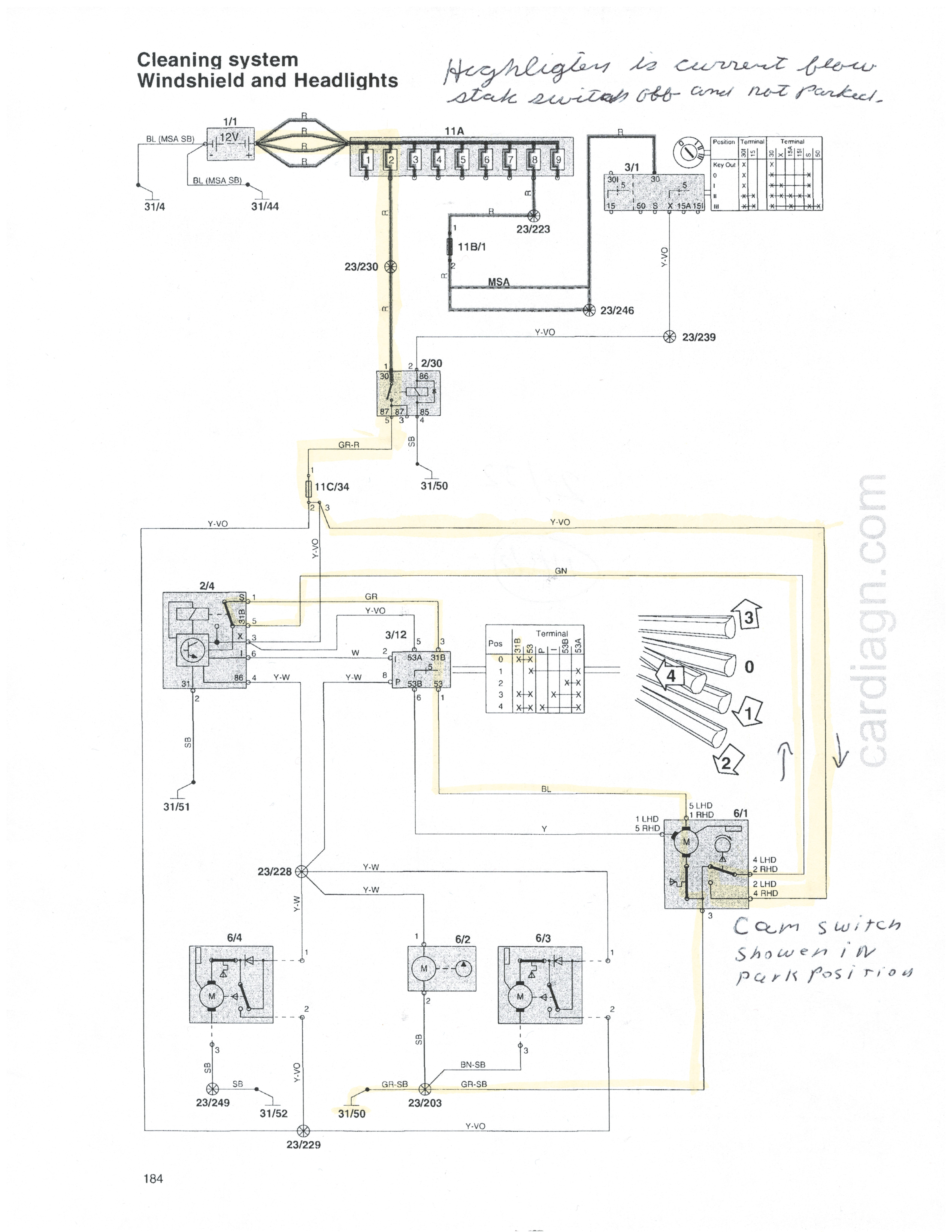

You can see the switch pin assignments and connects on the Alldata diagram below.
Looks like fun, but trouble shoot the switch by pulling the connector and testing for continuity as shown in the little insert
If there are no intermittants and the switch is good, the 2/4 relay (labelled 203) might be bad.
- Screen Shot 2020-04-03 at 8.59.48 AM.png (214.48 KiB) Viewed 491 times
- Screen Shot 2020-04-03 at 9.00.09 AM.png (232.18 KiB) Viewed 491 times

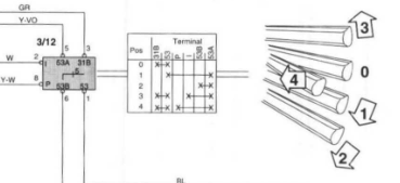

Here is the switch guidance - the diagram is a bit sucky because you have to use the grey box to get the right assignments for pins 1-8, then use the map to see which assignment connects to which.
Someone wasnt being very friendly when they wrote that
- Screen Shot 2020-04-03 at 9.05.11 AM.png (14.5 KiB) Viewed 488 times
- Screen Shot 2020-04-03 at 9.05.28 AM.png (11.77 KiB) Viewed 488 times
- Screen Shot 2020-04-03 at 9.08.19 AM.png (36.79 KiB) Viewed 487 times

Based on the diagram, the position 3 isn't working. Also I had tried swapping the relay first with the 99 relay from a vw but I had the same problem regardless. I'll have to look into the wiring diagrams soon and pull out the multimeter!RickHaleParker wrote: ↑03 Apr 2020, 12:52
Are positions 1 - 4 working as they should be or is there a defect other then not parking?
Another defect would be useful in diagnosing this.
