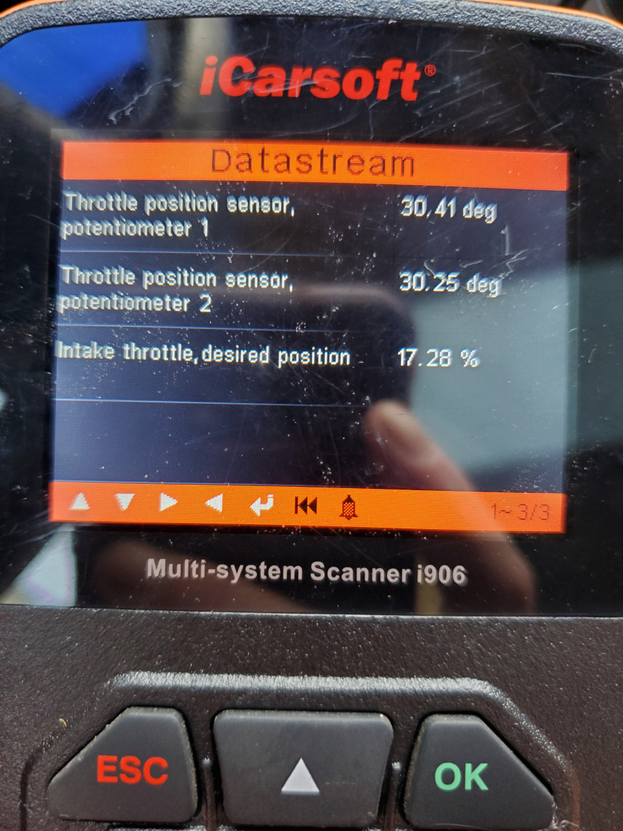

I need some help I just bought a 2001 s60 t5 with 106300 miles on it guy told me it has had no issues and he had sparkplug change the day I bought it I got it home after a20 min drive turned it off and now cant go anywhere over 10mph is comes up with code p00121 and p0068. Also ABS light with code 00070. It sounds like too much air Is going through the engine and smells like exhaust when i am looking at the engine. I havr replaced with used parts the M.A.S. and the variable timing sensor, cleaned the throttle body and still having the problems. I am lost OUT$2000for a car I cant drive I dont mind dyi but dont know whar else to do that will fix this problem....
I grabbed some readings:
Tps pent 1 30.36
Tps pent 2 30.25
Intake throttle density 2.28
ATP 19.30
Peddle 8.19
Long term f trim -.8%
Short term f trim 99.2%
Airflow 0.00
Break light switch not active.....
I have uploaded a video on utube with how it sounds when running....title of 2001 volvo s60 t5

Research electronic throttle module (position sensor) here:
viewtopic.php?f=12&t=78913
More info here:
viewtopic.php?f=12&t=17252

volvolugnut has supplied you with good information - that would be my original guess based on year and model.
I had a 2001 XC70 with same issues, not as bad, and I converted the MM throttle body to contactless SACR unit and never had issues afterwards. All told it was under $150 and some work. There are write ups on the forum
It is a good car and once you have it sorted you will be happy.

I would check for sticky throttle butterfly. Clean out the bore of the throttle body.

I cleaned out the trottle body still same result.. I can get a throttle body from junk yard from 2000 v70 it has the yellow sticker would that possibly work?
- Posts: 36145
Try resetting all the codes and see if the throttle body comes back inline.
You get about 10,000 miles on them once they start coding, usually

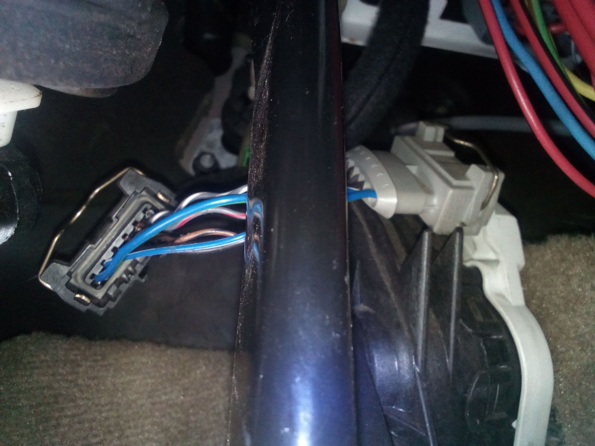

I did the sacer mod last month on my 2001. My biggest improvement was switching the pedal for a contactless. If your pedal is all black you should change it.
