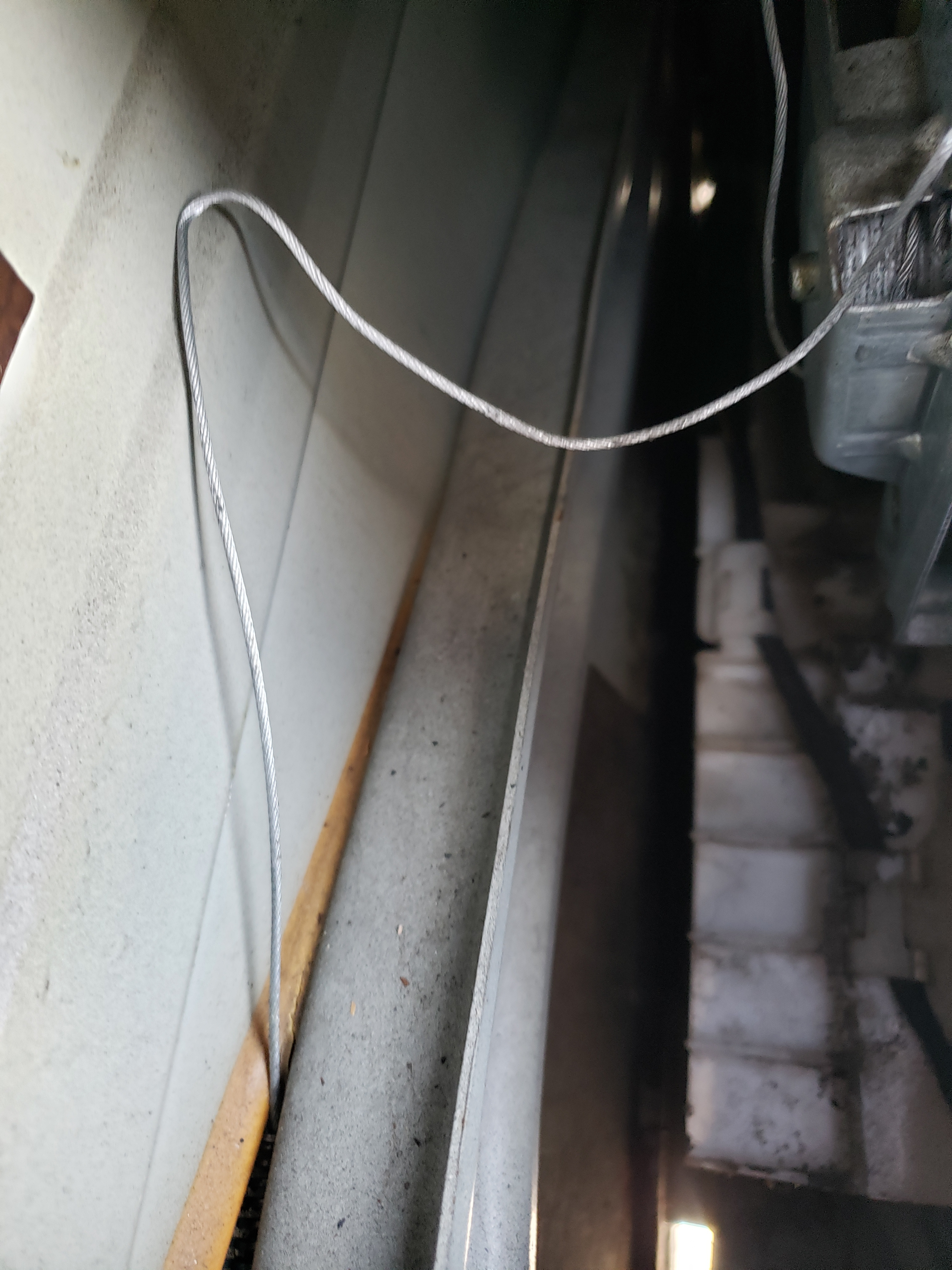

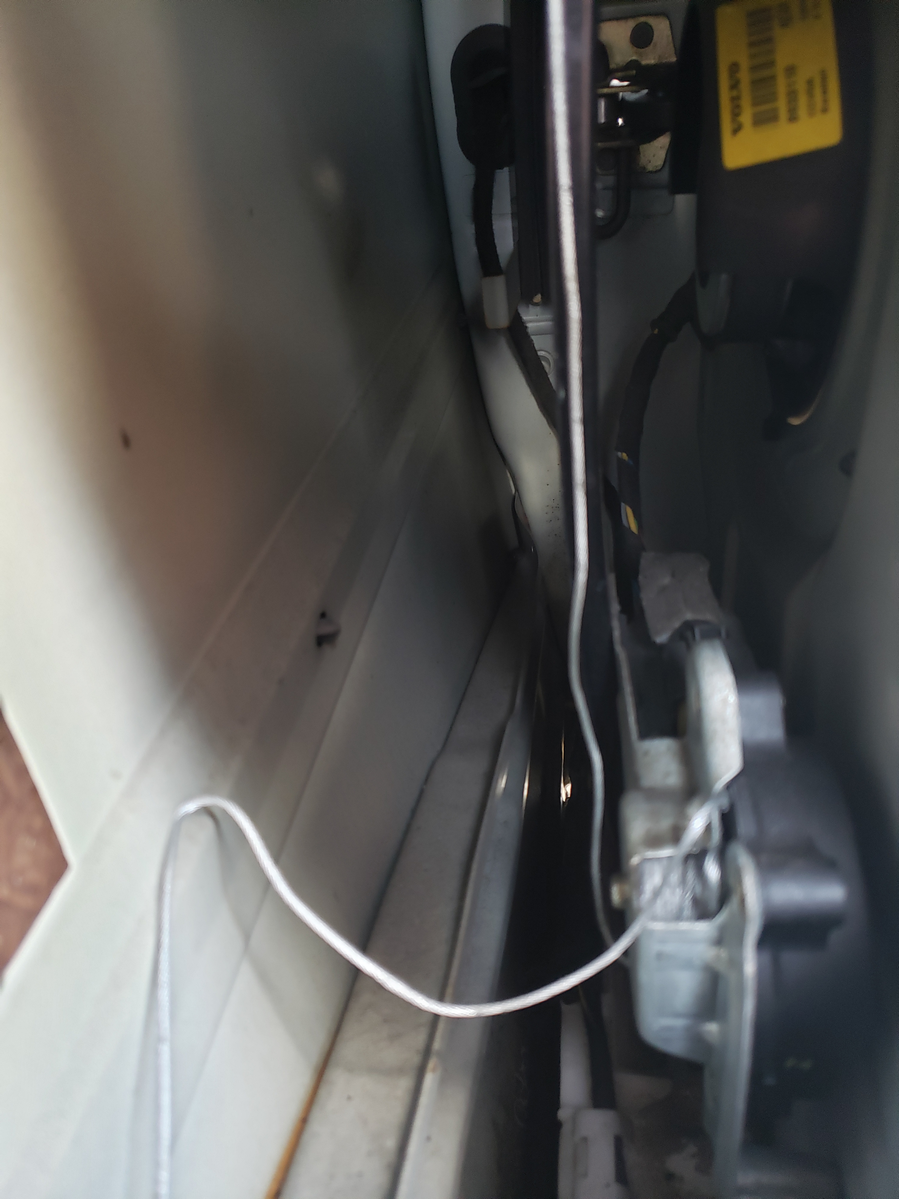

Yesterday i am trying to roll up my rear passenger window when I heard two loud bangs, then I hear the motor trying to roll up the window but the window doesn't come up. It will come down but won't come go up.
If i roll it up by pushing it with my hands, it will eventually come down with every pothole on the road.
what am i looking at?

I think I might need a new regulator, are there any instructions on how to install it for XC90? There are some rivets that holds it in place, and some video suggesting that I have to drill them out and use a special machine to insert them back?
can someone confirm please?

Enter the search term "download vida image". You can download the Volvo (VIDA) software that contains all the repair and replacement procedures, parts catalog etc. Pair that with a cloned DiCE unit off ebay or wherever if you want to perform diagnostics.
Yes, you would need a rivet gun and rivets and a drill motor and bit to drill it out.

Instead of rivets, I drilled out the holes slightly and used short bolts with nuts. This worked fine and makes disassembly easier if you have to ever remove. Just make sure the ends of the bolts don't interfere with anything. I used SAE 1/4 inch bolts maybe 1/2 inch long. I believe I placed the nuts on the side you can see.

Yes. I was thinking of the same thing. For now I used twist tie and taps to wrap the handle to prevent the window from coming down while driving.
