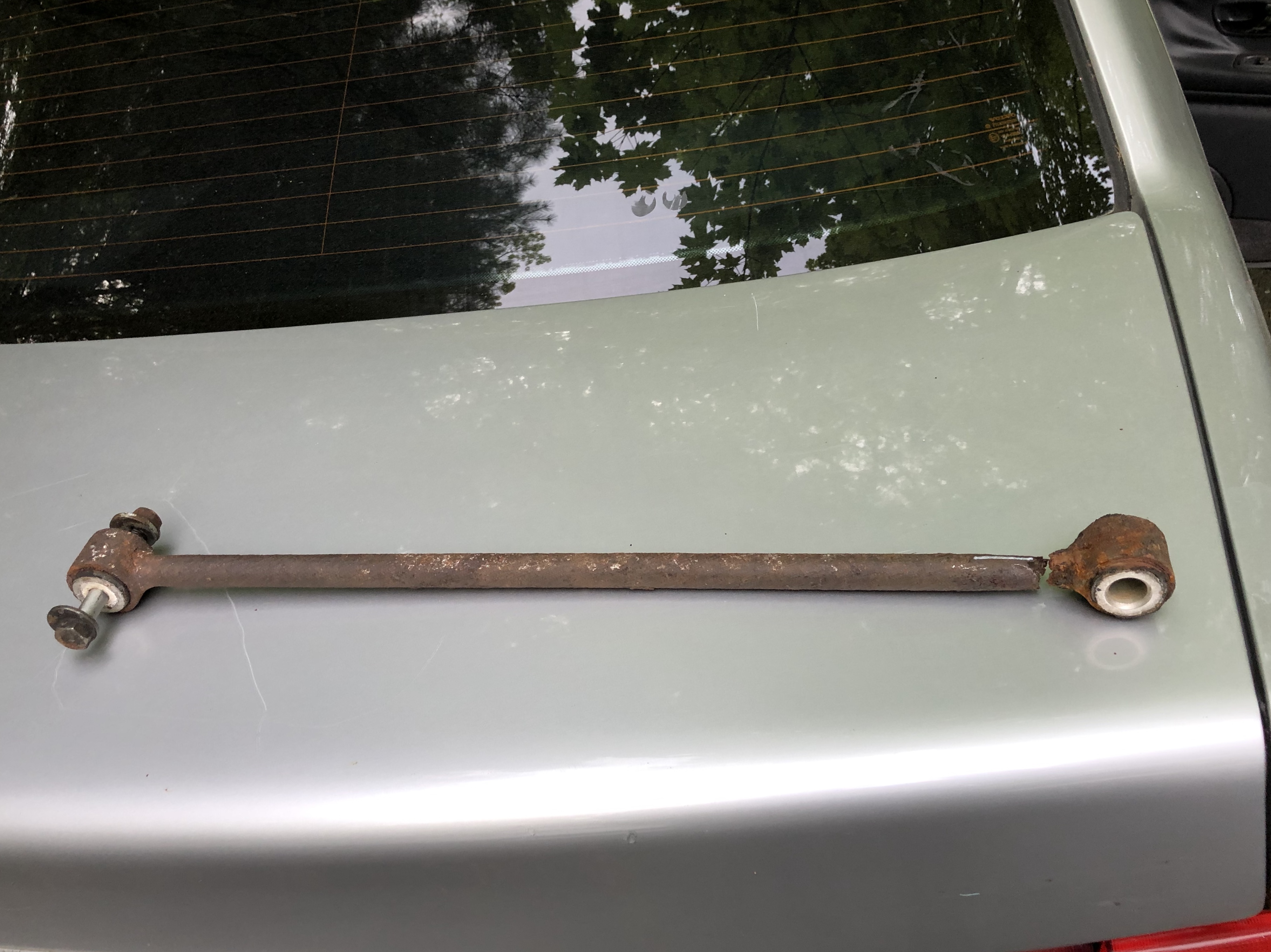

Your remarks about rust and corrosion definitely apply to this car, both rear torque arms are rusted thru. To remove the ends , I had to hammer the bolts out of the nylon bushing. Right side is done but even after much hitting, LH side center bolt is still stuck, time for bigger hammer. But then what , measure the original length and weld up Replacement torque rods using original ends, legal or safe?

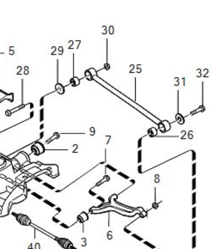

I’m mistaken , the arms are called “panhard rods” or track bars, #25 in the diagram. Both rods are rusted thru. Hope to get the scope tomorrow and have a look at the leaking hose.

Again I have some rusty looking but solid versions of those. This is so frustrating not having easy access to that stuff.
The bushes were available for those a few years ago, and the rod I believe was also available and came with the bushes installed.
