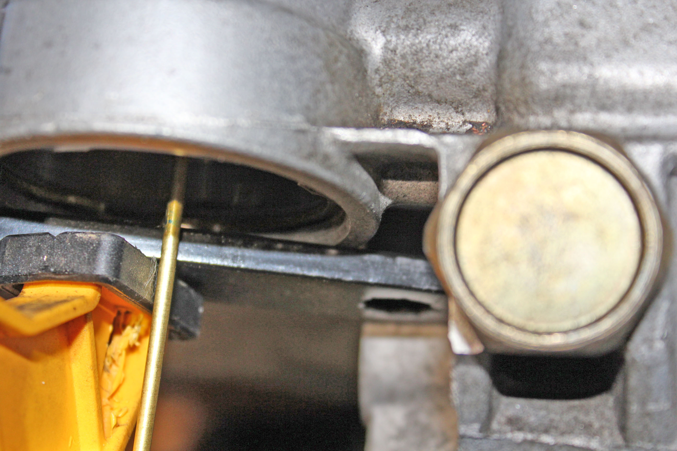

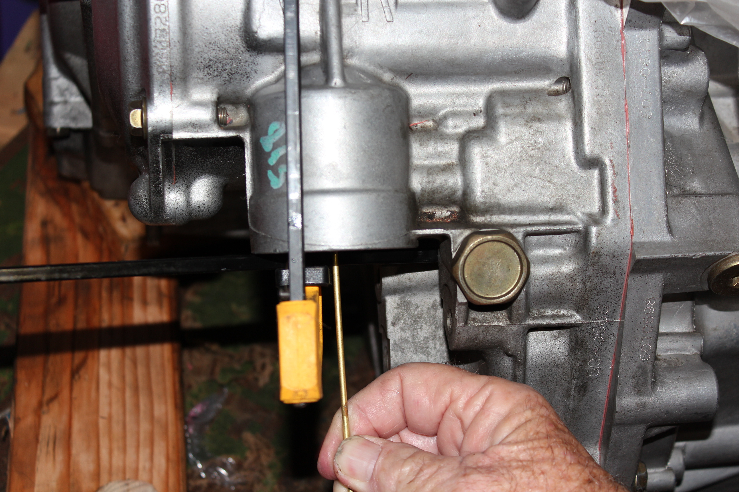

One thing you might check with the servo cover off is the condition of the 3rd gear band. To do this I use a rod through the servo pin hole to compress the band and marked the rod when the band was fully compressed. I measured 93mm to the edge of the trans case at the servo cover opening, see photo. To check servo travel I also measured the length of the servo pin with the cover, which measured 84mm.shiloh51933 wrote: 19 Jun 2020, 11:08 My wife was driving the 2004 XC70 for a couple of hours, then the 2-3 upshift flares. It's got no 3rd gear at all but it will bypass 3rd if I use the sport shift. I met up with her and drove it home. There's no flashing lights, NO red triangle, no CEL. No messages on message screen...nothing. I hooked up my scanner and got the generic code p0733 Gear 3 Incorrect Gear Ratio. ATD fluid level reading was at the L marker, so I added a little. I've done numerous drain/fills over the years. Any suggestions or questions? Every other gear works including reverse.
There a couple of adjustment needed to get the final travel of the servo pin.

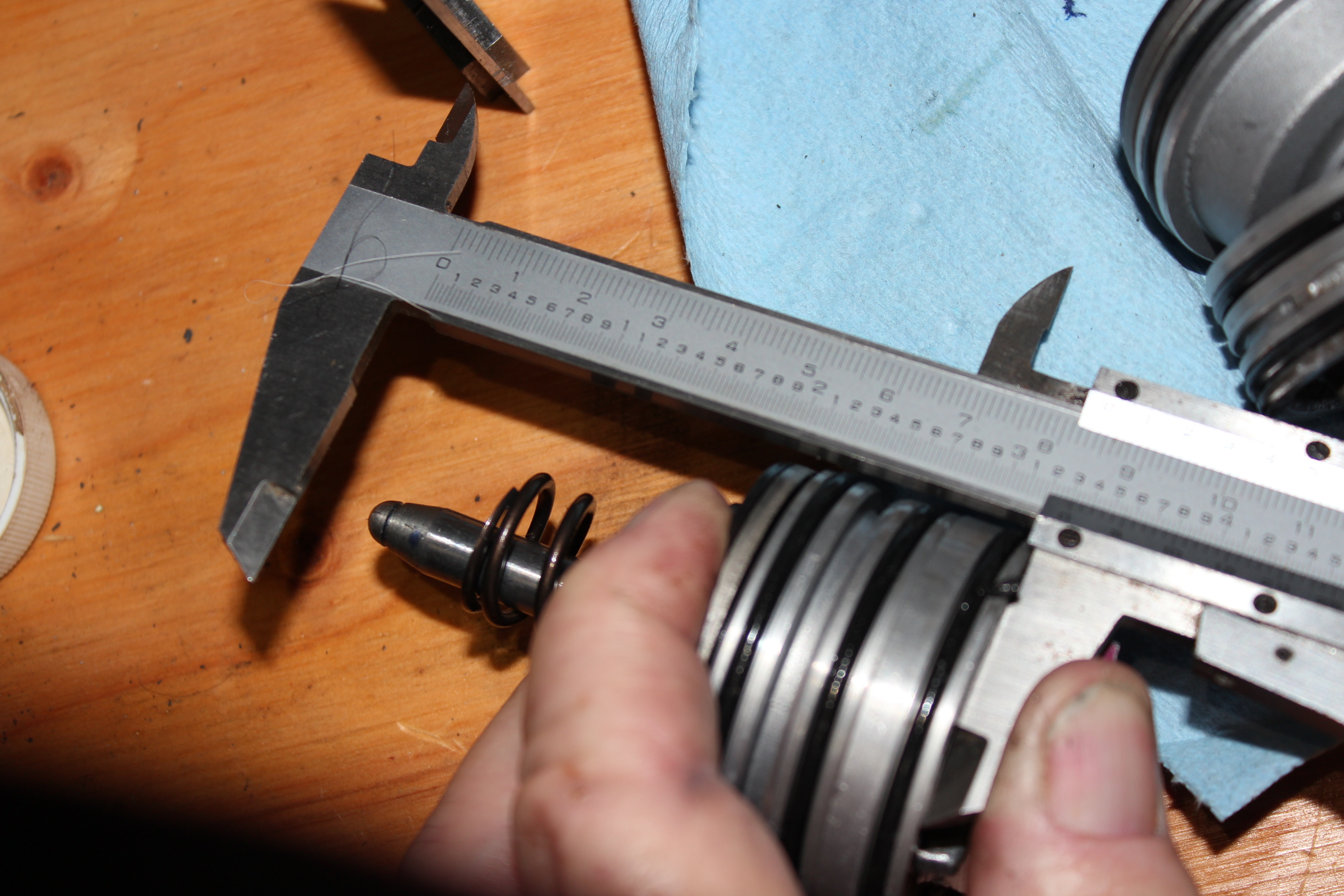

You have to subtract 6mm from the measured mark on the rod so in my case 93mm - 6mm = 87mm. The 6mm is from the outside of the transmission case to the inside of the snap ring hold the servo cover in place. The total length of the servo pin with cover is between the tip of the pin and outside edge of the servo cover. The outside edge of the servo cover when installed is the inside edge of the snap ring.
There's also 2mm of compression on the servo pin when it's applied due to a cushion spring so this 2mm needs to be subtracted from the servo pin and cover measurement, in my case 84mm - 2mm = 82mm. The servo pin travel I calculated is 87mm-82mm = 5mm. The spec is 5.76mm to 6.76mm according to the ATSG manual I have. My measurements are probably not as precise as they could be and compressing the band with the rod is not the same force as the servo pressure compressing the band but the measurements did give me a good idea the servo travel wasn't horribly out of spec.
I think if you have a badly worn 3rd gear band you'll see a measurement noticeably larger than the 93mm I measured. There are differently length servo pins to bring the servo pin travel into spec and I think this may be option assuming the problem is not the servo cover or the anchor bolt was removed or a badly worn out 3rd gear band. How long has there been a 2-3 flare?

There are a couple of things you can do determine what's going on with the 3rd gear band (B4). Pull out the servo and inspect the cover, o-rings and for any other obvious wear or damage. You can also use a rod and compress the band and then make the measurement I previously suggested to check for wear and if the band is in place. There's also a B4 pressure tap on top of the transmission. According to my ATSG manual; in 3rd gear the B4 tap pressure should be between 48-57psi in Drive range at idle and between 186-202psi under max load, wide open throttle.shiloh51933 wrote: 24 Jun 2020, 11:57She searches for 3rd but no engagement, it's not entering 3rd gear then slipping. If I was going fast enough in 2nd she would flare in 3rd then I let off throttle and she would bypass 3rd for 4th gear. The trans has never needed any repair since we purchased her 160,000 miles ago. I've been servicing this Transmission since the day we brought her home. I've been doing drain/fills for 6-7 years and she has treated us well. Doesn't matter if it's cold or warm, I tried on the initial time taking her home to use the Sport Shifter to engage 3rd but it wouldn't go in 3rd so I went in 4th.firstv70volvo wrote: 21 Jun 2020, 11:49If no previous flaring that would indicate the 3rd gear band was not slowing wearing out over time so maybe the problem can be corrected with the servo cover and new o-rings. Is 3rd gear completely gone now even at cold ATF temps too? There wasn't any transmission work done previously before the problem started, no one messed with the band anchor bolt? When you do replace the servo cover do try to measure the distance when the band is compressed, this would also confirm the band is in place. From my measurement there's about 11mm of travel form the point when the rod just contacts the band and full compression. When the servo pin and cover are in place there some initial compression on the band and why the servo pin travel should then be the in the 5.76 to 6.76mm range.Never had issue before with the A/T.
If the servo looks good and measurement looks reasonable then you could look at the pressure.
