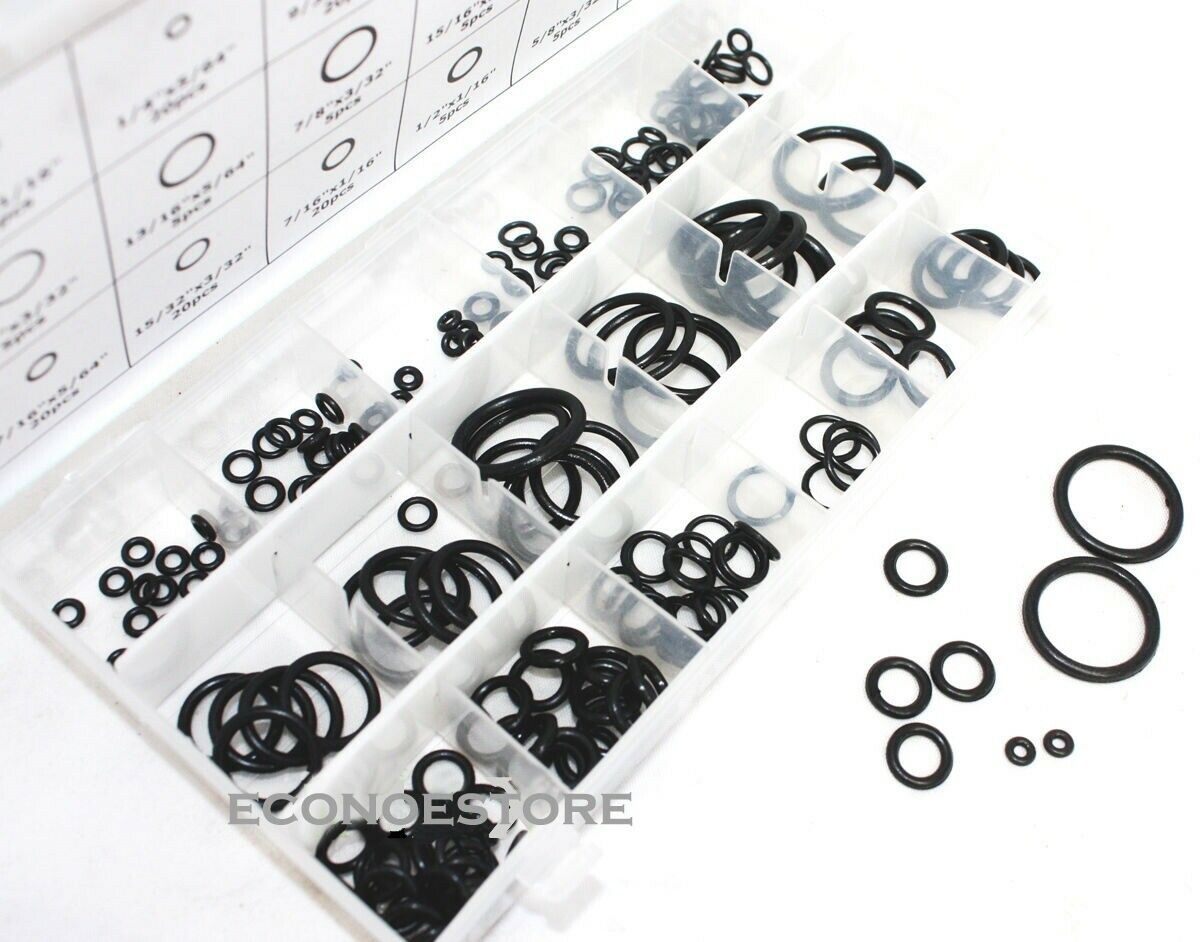

All local parts house has a box of O-Rings (similar to below) for you to choose from so shouldn't be a problem. Use a little silicone grease when installing so as not to pinch or shear it. Petroleum lubricates will swell the O-Ring unless it's synthetic.plumsmooth wrote: 01 Aug 2020, 12:38 MY Mechanic was reaching up in there and said it was an o-ring.
Motor works fine.
I guess he is referring to the piece between the tank bottom port (connecting) and the tubing?
Does anyone know if this is a part available to buy separately?
https://www.ebay.com/itm/SAE-225pc-Rubb ... SwnY1dl-fJ
