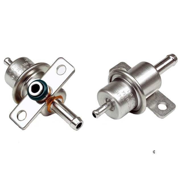

the 2 seconds of pump run in engine off pos II will get you 10-20 psi for one key on on lots of cars but usually the correct pressure on the third key on pump run.. That 99 has the fuel pressure regulator in a fitting on fuel line back by tank so fuel press regulator was not new with a new pump assembly. The more important test would be cycling ignition on for 2 sec, off, on for sec, etc 3-4 times to get the 50 ish psi built and then seeing how long that holds. if it immediately drops then there is a problem. If letting it leak down causes long crank with black smoke and usually dead miss for a few beats when it does fire off then a fuel injector leak is high on list. If long crank has no smoke and a little lumpy but no so obviously a dead cylinder until raw gas is cleared then it is fuel leak bank into tank through check valve or fuel pressure reg on the car in question. The check valve is integral to fuel pump and regulator on this one is in fuel line back by tank/fuel filter.

The fuel filter is just out of sight in photo. This is just ahead of rt rear wheel, below back edge of rt rear door under floor. First photo is what the replacement looks like.
- X70 99-2000 fuel press reg.JPG (122.75 KiB) Viewed 1586 times
- 99-2000 fpr.jpg (26.06 KiB) Viewed 1586 times

Jimmy57: I tried the key on/off sequence three times last night. The pressure quickly dropped down to 10-15PSI. I then tried again making sure that I was only toggling from the Pos I to Pos II and the same occurred. It didn't start rough, but it was dark and and I couldn't see smoke. I'll try again in the harsh light of day and see what I see.
Thanks for the photo of the regulator. That should be easy enough to get to if I have to. Is the check valve in the regulator, or elsewhere? Also, my 1999 V70XC was made late in the year and some of the systems are best described for the 2000 V70XC (most notably the rear brake calipers which I replaced recently). Do you (or anyone) know if the fuel pressure regulator and/or check valve moved for the 2000 model year?
