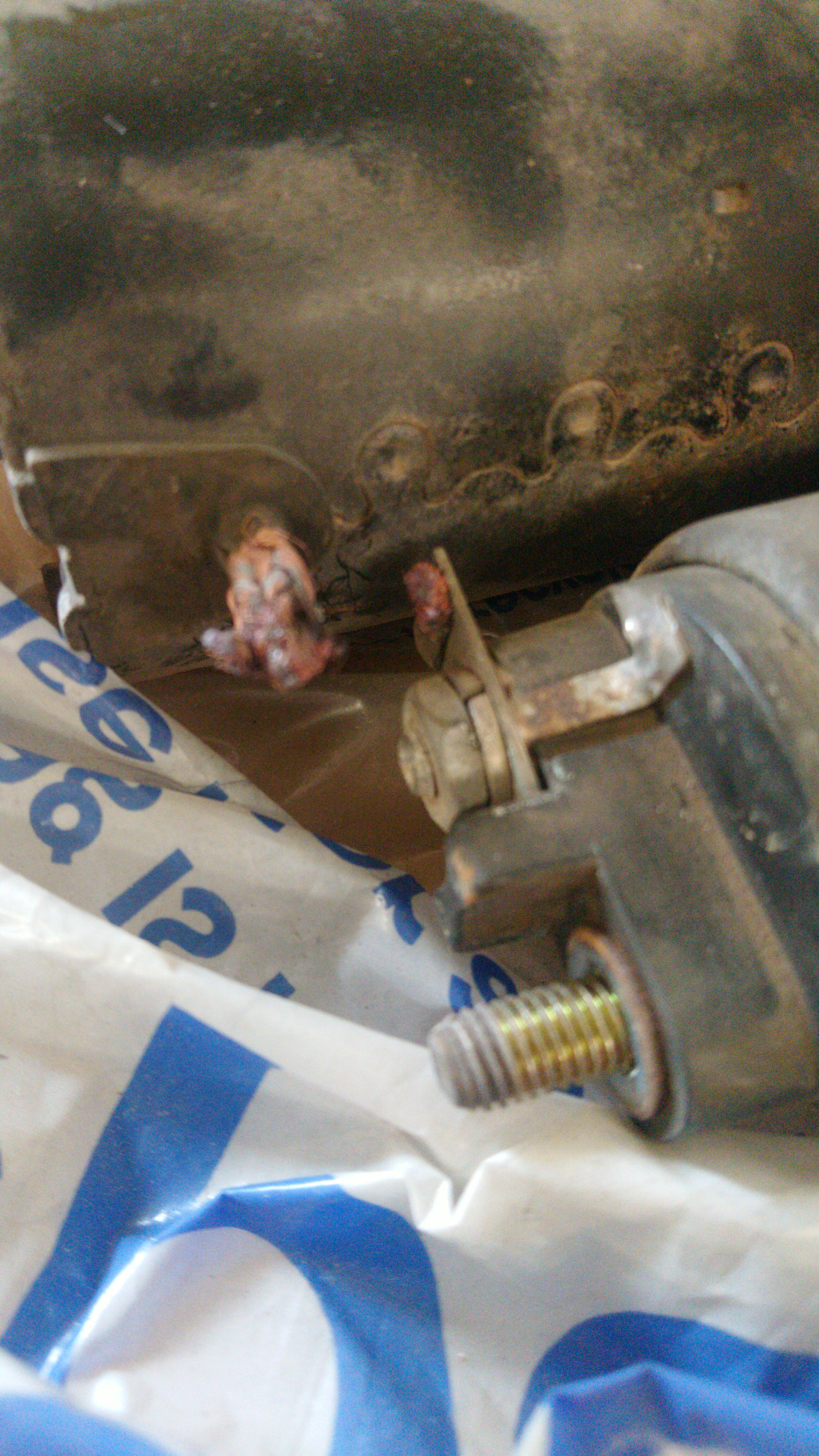

Generally, anything is fixable.
Is that your starter or just a photo from the internet?
Looks like that wire may have heated up so much it disintegrated.
My guess would be either a short in the starter, someone cranked it for many minutes on end or too much (well above 14V) were applied. If that's how you found your wire, I would try to find out why it fried. I would not just replace that without more diagnosis.
Though the ignition switch is prone to failure, If everything else has always been well with the car, I'd lean towards the starter having some kind of internal short.
