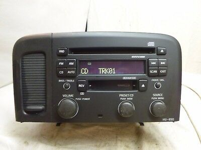

I'm aware that the trim is different. If you look at the HU-650 from the S80 it has the cassette player. Please see photo below
I'm aware that the faceplate on that is curvy on the top right versus angular on my HU-613, what I was wondering is if I could swap the faceplates and if the internals would play nicely (steering wheel controls etc)?

For the face plate, maybe it works, but it's quite some trouble, the audio face plate is not that easy to detach. The CCM will need the same treatment. As for software compatibility, I guess it will cause problems because the year is too different, such as no steering controls and even no face light on the radio
