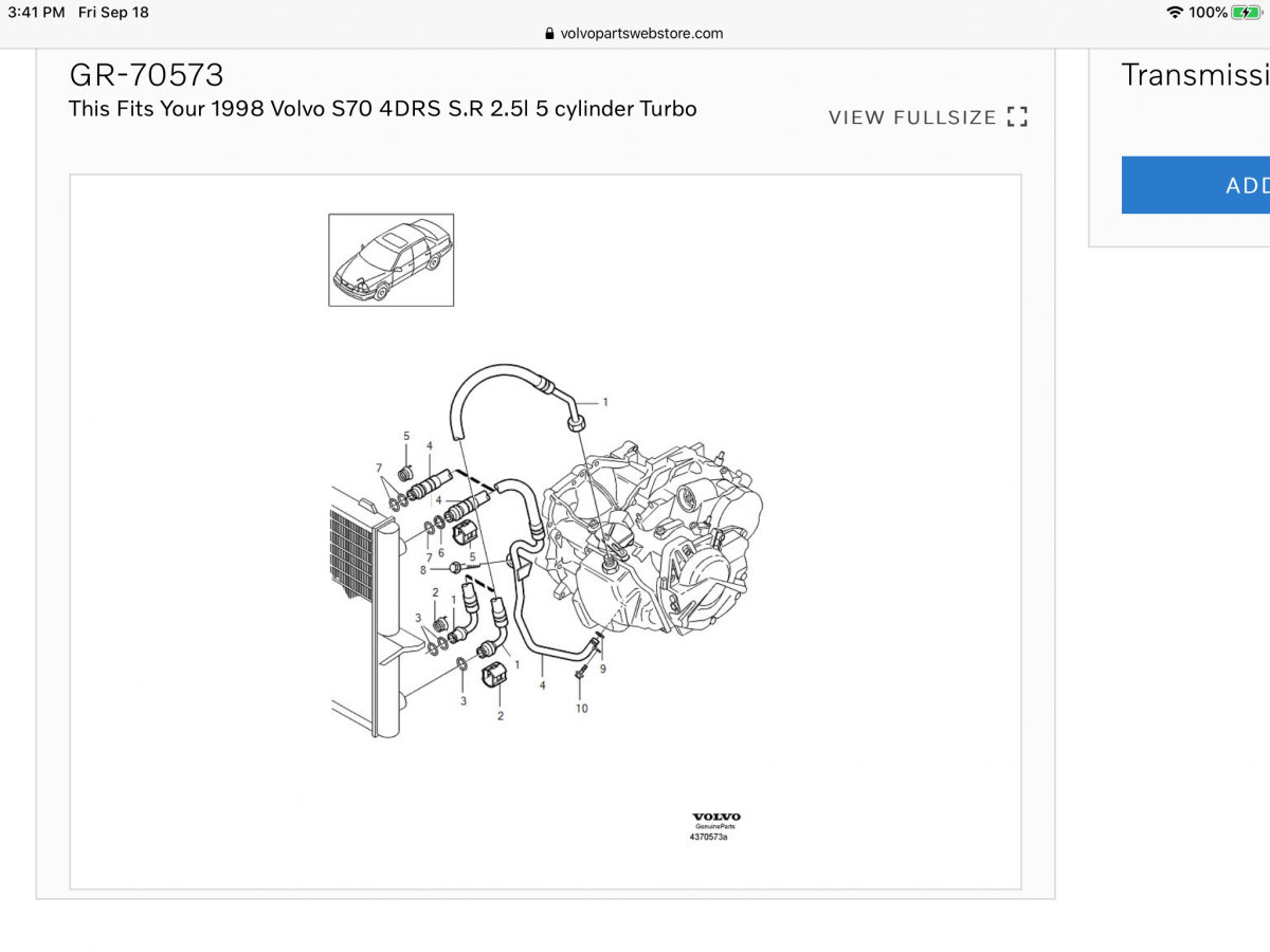

I am changing the radiator out on this 1998 Volvo S70 GLT. The retainer clips that attach the transmission lines and oil cooler lines onto the radiator look very similiar - are they the same part, and are they interchangeable? I found a couple threads about how to remove them without destroying them, but nothing about parts compatibility. Thanks in advance!

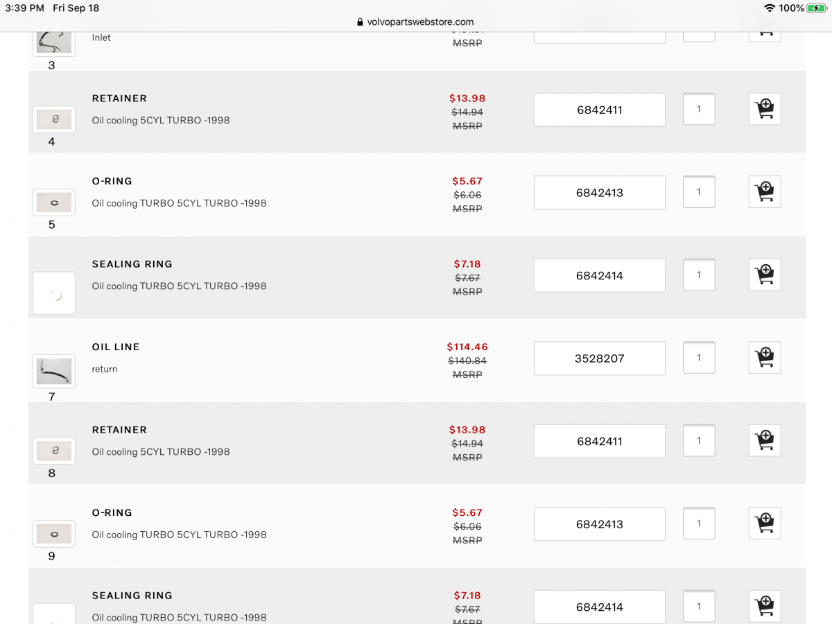

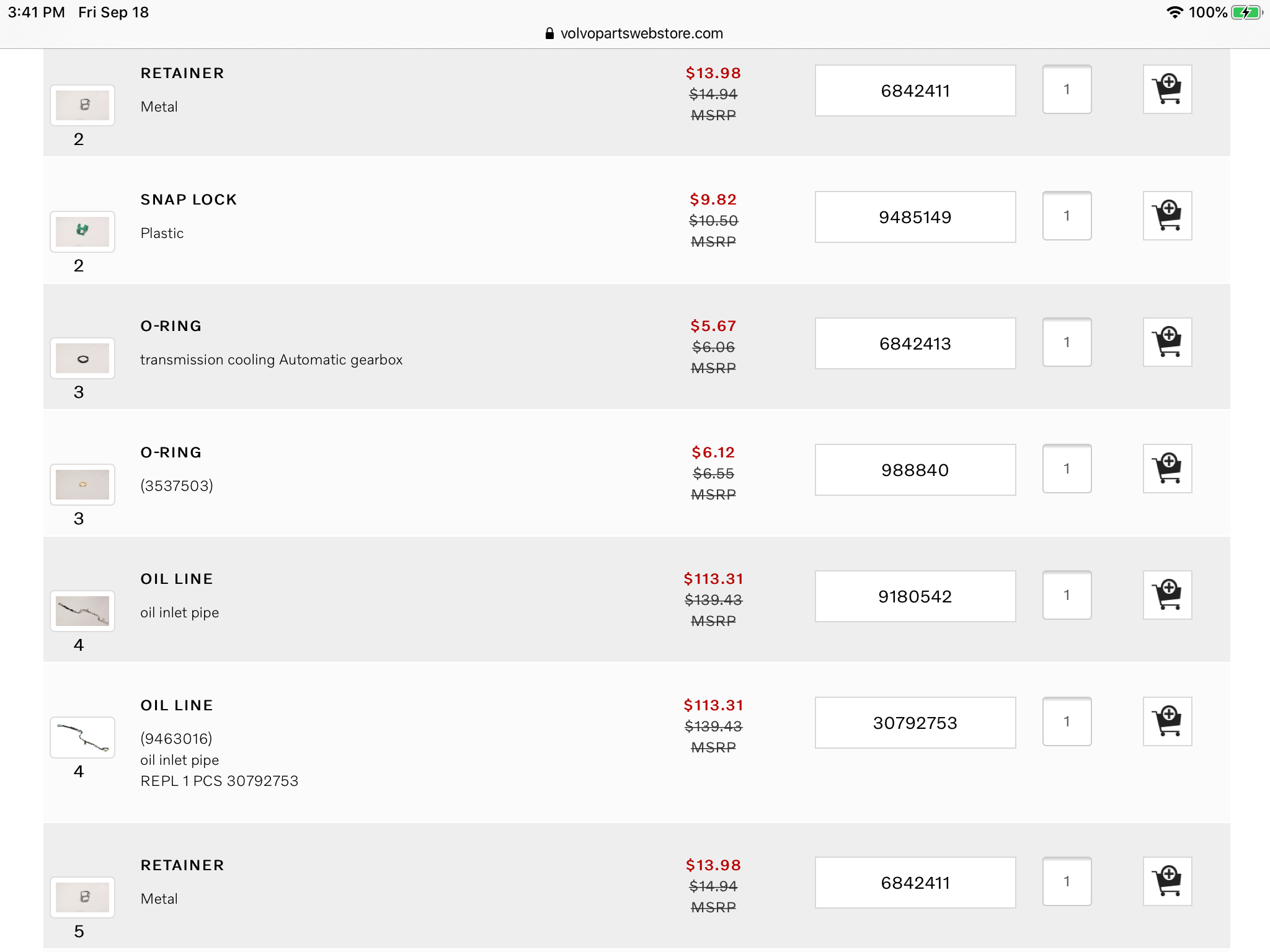

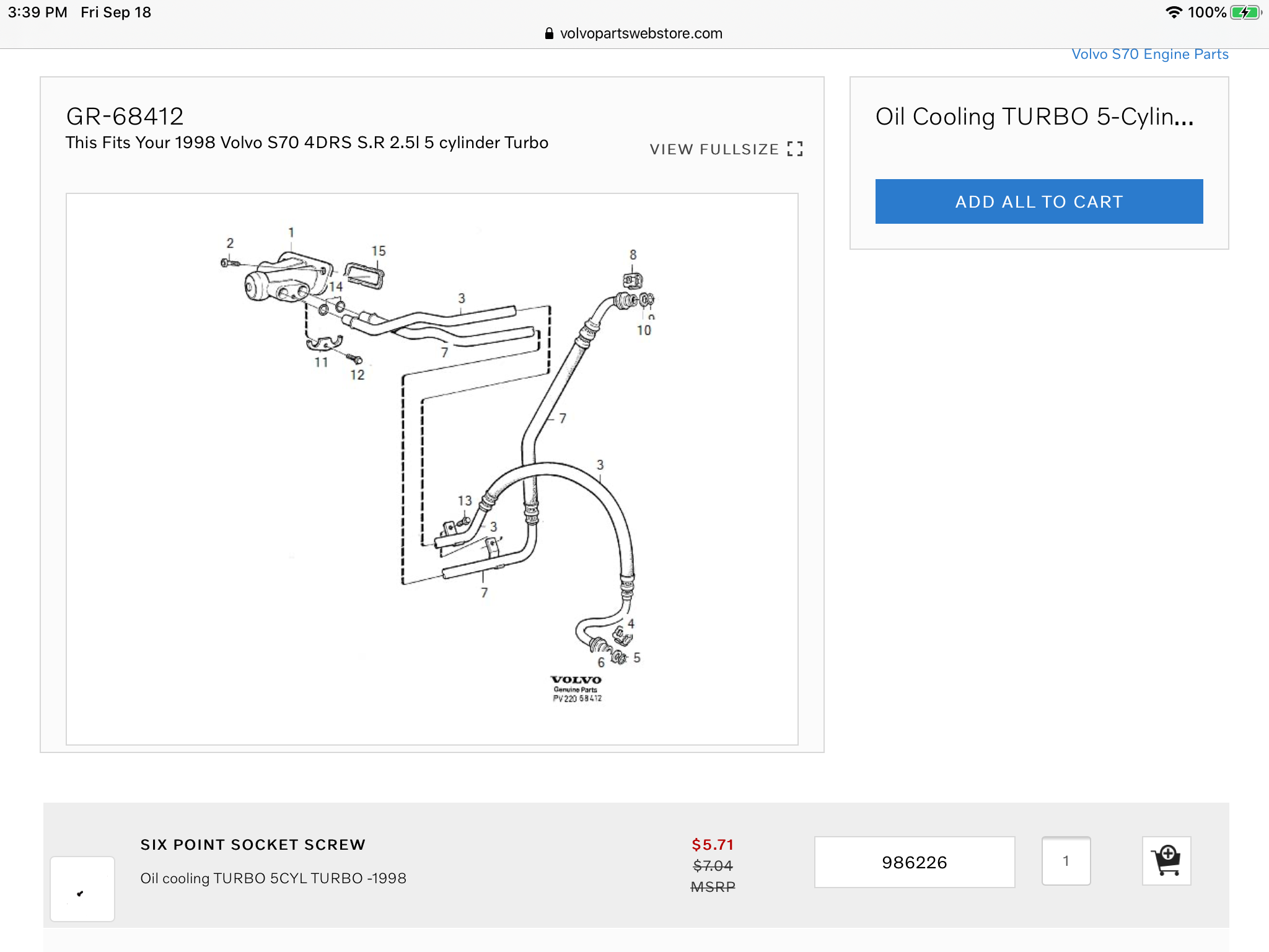

Retainer 6842411 for oil cooler, and same fir AT cooler per Volvo web store
