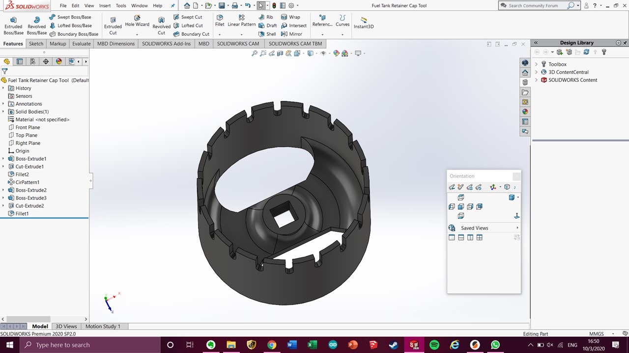

Hey gents, I'm planning a fuel pump replacement on my '06 S60 2.5T, and as I was reading this guide (viewtopic.php?f=9&t=67480) I realized a special tool is required to remove the pump retaining ring. Since the tool doesn't look like it needs to be super strong, I figured maybe I could 3D print one and save some $. I whipped up a draft in SolidWorks, but I was just working off images of the tool and I could use some exact measurements from someone that already has the tool (I'm not anywhere near my car and also don't own the tool or I'd take the measurements myself). I'll happily post the file here after I've updated it so that others can print them as well.
Here are the measurements I need:
Outer Diameter:
Inner Diameter:
Width of One of the Gaps:
Depth of the Gaps:
Overall Height of the Tool (or recommended height):
Here's the draft:
Thanks all. If anyone's willing to test one out, I'm curious if it'll hold up as is - I can add reinforcement to the teeth or the arms if needed.

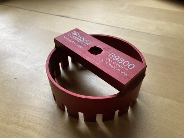

Top plate where your 1/2” ratchet goes is 1/2” thick....aluminum. That’s welded to the “socket” which is made of 1/8” wall thickness aluminum. Each gap is .25” wide and .61” tall. Height of the socket only is 1.58”, 2.08” with the 1/2” top plate. Outer diameter is 4.51”, inner diameter is 4.23”.
A few members have made their own with 4” black sewer pipe/PVC.
My hesitation with the 3D printer is the 1/2” top plate ratchet hole not being able to withstand the torque needed to bust the collar loose. If that’s the case I think it would better to buy a cheap version. I know my red aluminum tool was $50, but they can be had at a fraction of that cost on eBay from China.

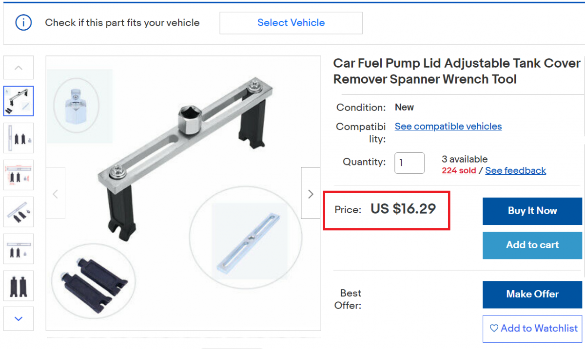

I bought this tool on ebay a few yrs ago.
It fits many cars....
