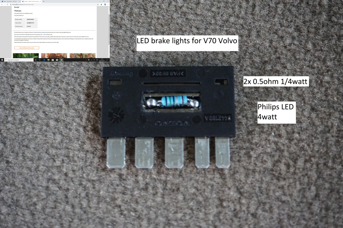

I swapped all my rear lights with LED including the revereser lights, very bright and white not yellow. As for the bulb out warning, if i recall there isnt one for reverse lights, or i did the add a resistor to the shunt trick..
